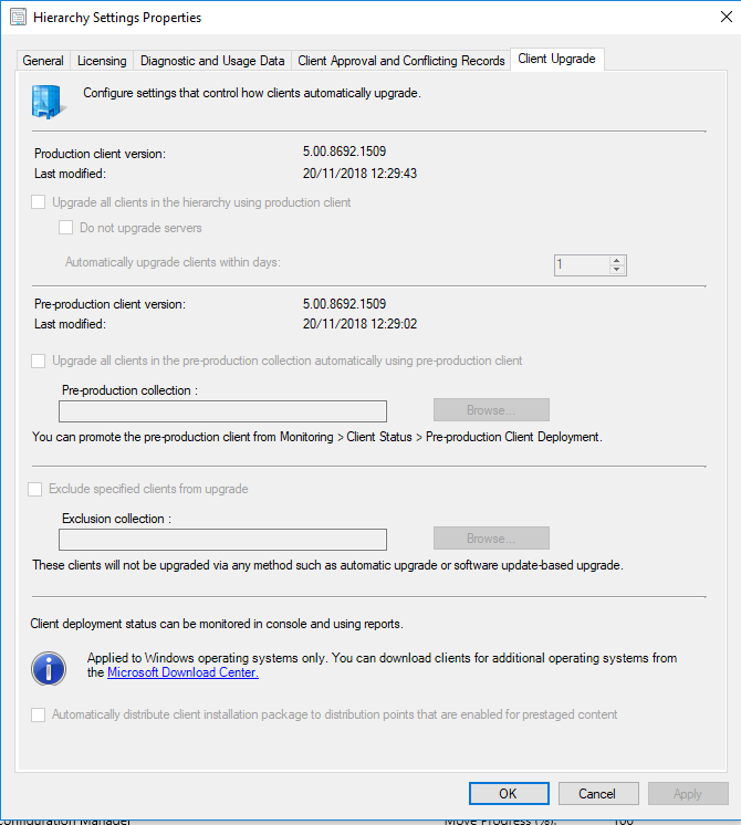

It seems the clients on the domain are now updating to version 5.00.8692.1509, i'm baffled with whats going on here. The console is showing the correct up to date build number for 1806 so everything looks ok there. At the moment the only machine showing the correct version of the client 5.00.8692.1008 is the server itself Anyone else have this issue? I have installed all the latest hot fixes through the console as well Appreciate any advice
Hi I have just updated our site to version 1806 and noticed that under the hierarchy settings the production client version is showing as the below, i though this should be 5.00.8692.1003. All my current clients are running version 5.00.8634.1813 Should the production client version be displaying the current client version or is it just the version that SCCM was installed with? I am just a little confused. Appreciate any advice Thanks

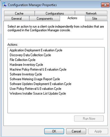

Hi All, First time poster here Currently running SCCM version 1706 and I am having an issue trying to get applications to install when deployed to a specific device collection. I am still learning my way around SCCM so please bare with me here. I have setup the application foxit reader to deploy to 1 test collection. I set it up to be available rather than required. The test machine is a VM, its has software centre installed. I don't seem to be able to view an application catalogue though which is where I thought this deployment might show up. There is a link to the application catalogue under Installation Status but this is greyed out. (image attached) EDIT - I think the reason I am seeing the website catalogue greyed out is because I currently don't have either of the 'Application catalogue web service point' or 'Application catalogue website point' roles installed. Are either of these roles actually required to deploy applications to collections rather than through a task sequence? My next though was the log files, i looked for the appenforce log (not sure if this is the right one) its the log I have seen people mention but it doesn't appear to be on the client machine. I have attached all the logs that are present for reference. I am just a bit lost to what to try next, I'd be so grateful if someone could lend me a hand or point me in the right direction. Thanks so much client logs.zip
