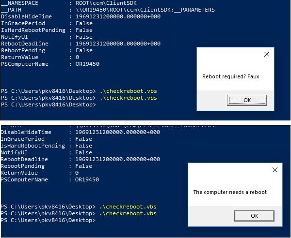

The Flying Carpenter replied to anyweb's topic in System Center Configuration Manager (Current Branch)i get : Reboot Required ? Faux (our systems are in french). Then when i click "OK", i get a secound box that says "The Computer needs a reboot". Could it be because your script is looking for the word "False"
