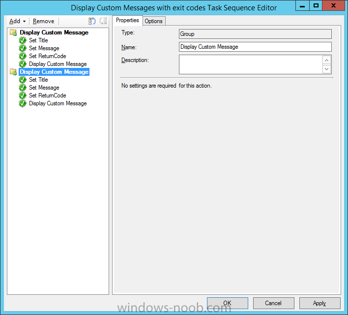

It will appear blank, click on the Add Drop down and add a New Group called Display Custom Message
Create a new Set Task Sequence Variable step called Set Title with a Task Sequence Variable called Title, with a suitable value as follows:
Create a new Set Task Sequence Variable step called Set Message with a Task Sequence Variable called Message, with a suitable value as follows:
Create a new Set Task Sequence Variable step called Set ReturnCode with a Task Sequence Variable called ReturnCode, with a suitable positive value as follows:
Click Add and choose Run Command Line, name the step Display Custom Message and paste in the following based on what operating system the client is using:
For Windows 8
ServiceUI.exe -process:TSProgressUI.exe %windir%\sysnative\WindowsPowerShell\v1.0\powershell.exe -WindowStyle Hidden -NoProfile -ExecutionPolicy bypass -nologo -file DisplayCustomMessage.ps1
For Windows 10
ServiceUI.exe -process:TSProgressUI.exe %SYSTEMROOT%\System32\WindowsPowerShell\v1.0\powershell.exe -windowstyle hidden -NoProfile -ExecutionPolicy bypass -File DisplayCustomMessage.ps1
For Package, select the Display Custom Message package created above. (screenshot below if for Windows 8 os)
Copy the entire group and paste it below the first group
Edit the Set Message step as below
Edit the Set ReturnCode step, and choose a value that the Options tab on the Display Custom Message step is not going to expect such as 1, this will cause the next step to fail when it returns the return code.
Apply your changes and exit the Task Sequence wizard.

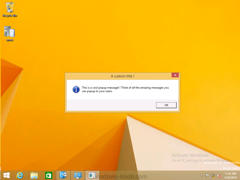

and after a few moments the first popup message appears !
As the ReturnCode for the first message was set to a value we expected (0 or 3010) it did not fail the task sequence. Click OK to continue...
the next message appears, note the different text, and it's hinting towards what will happen

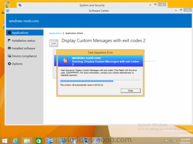

Clicking OK will produce the failure
Which is OK because we were expecting it, in fact, the ReturnCode we set (1) is listed in the failure message. In a real Production task sequence however, you'd take care of failures and deal with them in a professional way, I just want you to see that we can actually set the ReturnCode via the custom message.
To get more proof of that refer to the SMSTS.log file, and you can see that it's setting the ReturnCode to the value we chose

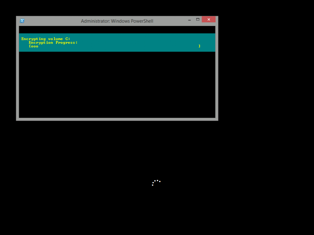

the easiest way would be the same way i do in this post about enabling bitlocker on hyperv virtual machines back before they had a virtual TPM
and here's what i mean
it does involve using a cmd prompt to show the progress though...
