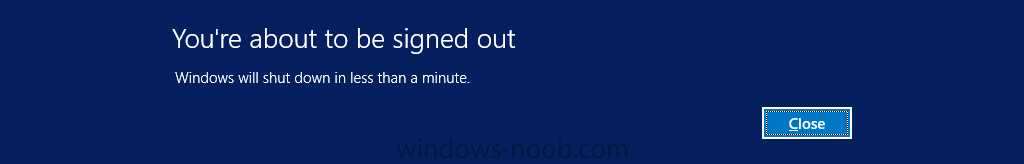

Before installing the hotfix though, restart the server via the following command in an administrative command prompt:
shutdown /r

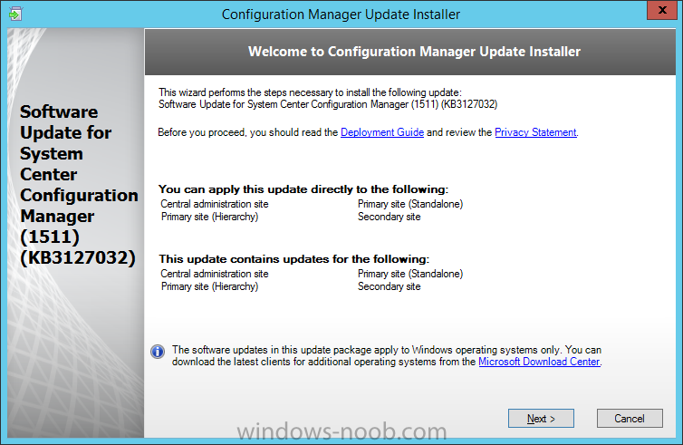

After downloading the hotfix, run it by double clicking on the CM1511RTM-QFE-KB3127032-X64-ENU.exe file. The wizard will appear.

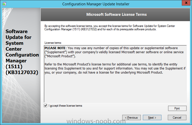

Click next and accept the License terms

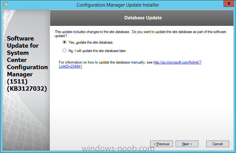

Click next and when prompted to upgrade the database answer yes.

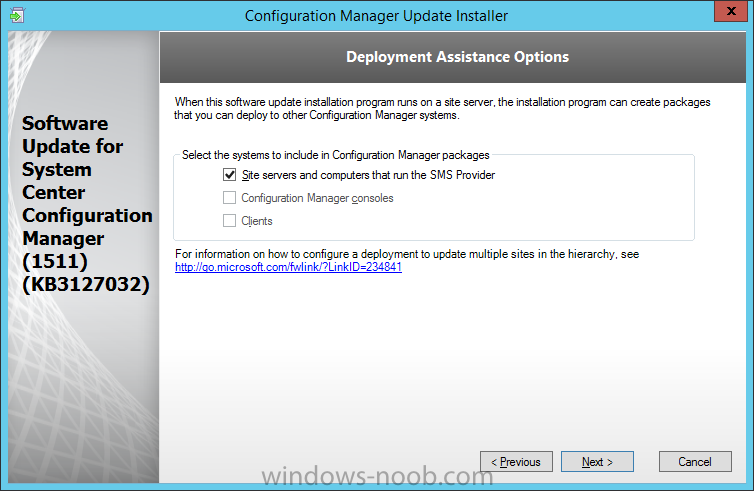

if you'd like the Deployment Assistance options to create a package, leave the default settings and click next

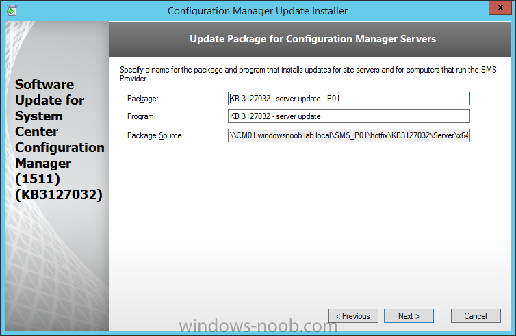

click next at the Update Package for Configuration Manager Servers screen

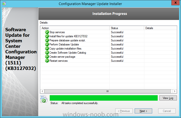

and review the progress before clicking Next

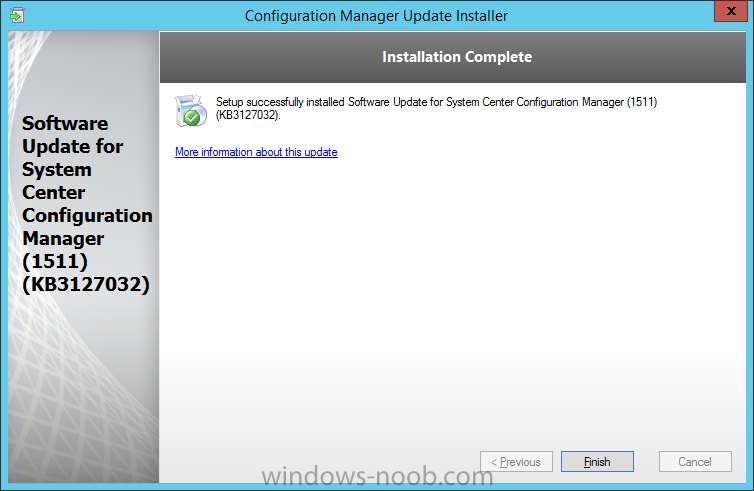

at the Installation Complete screen click Finish.

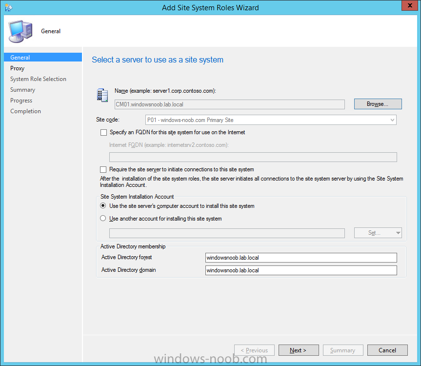

Using the ConfigMgr console, in the Administration workspace, expand Site Configuration and select Sites. On the ribbon, select Add Site System Roles, the Add Site System Roles Wizard appears, click next,

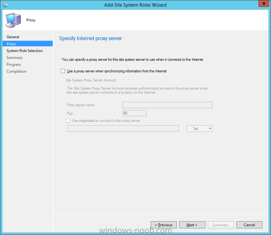

On the Specify internet proxy server enteryour proxy details before clicking next

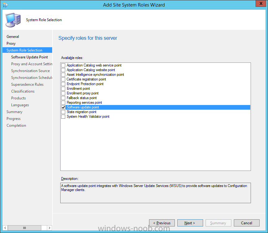

on the Specify Roles for this server screen, select Software Update Point

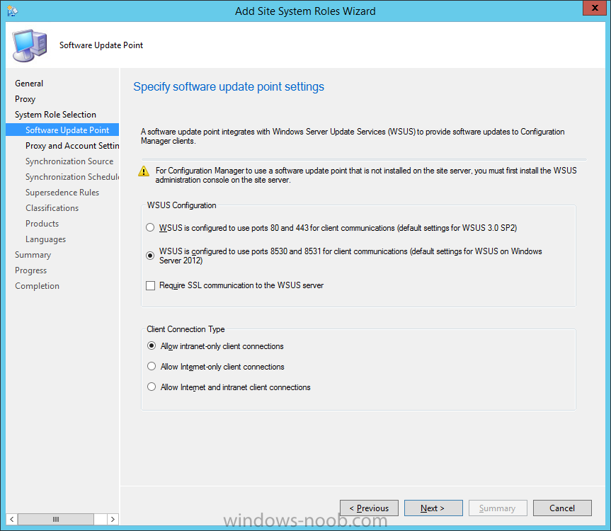

In the Specify Software Update Point properties, select the following options:
  • WSUS Configuration: WSUS is configured to use ports 8530 and 8531
  • Client Connection Type: Allow intranet-only client connections

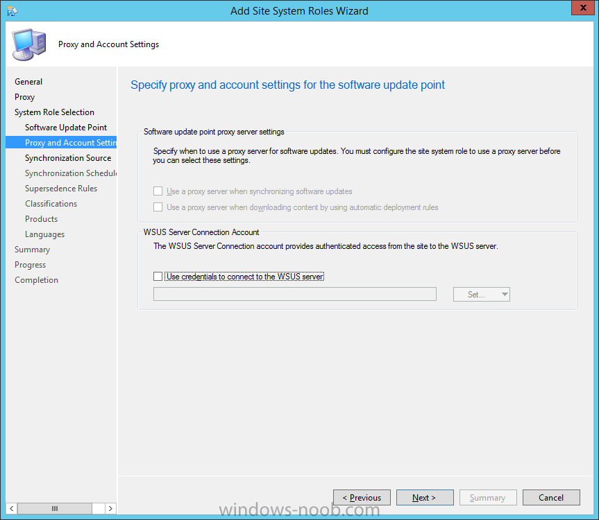

on the Specify Proxy and Account settings for the software update point configure it as appropriate for your environment and click next

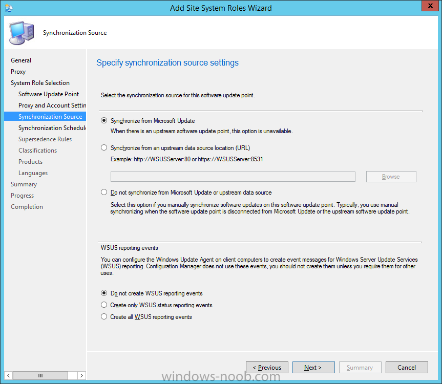

on the Specify Synchronization Sources page, as this is a standalone Primary, use the defaults. If you have a CAS in an hierarchy then point it to the upstream server as appropriate.

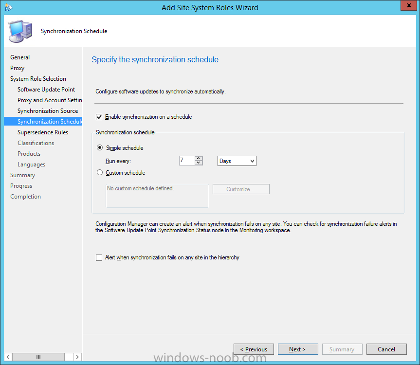

and on the Specify a synchronization schedule page place a check mark in Enable synchronization on a schedule and leave it at the default of every 7 days.
Note: If you want to have precise control over the time, day and frequency when the SUP synchronizes with Microsoft Update, then you should select the Custom Schedule option and configure it as appropriate. If you also intend to update Endpoint Protection definition updates then you should configure the sync to run at least daily in order to get the latest definition updates and Endpoint Protection engine updates as soon as they are released.

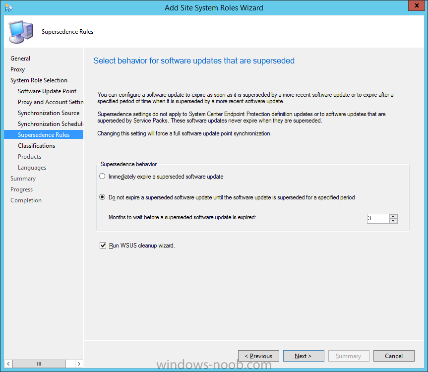

On the Select behavior for software updates that are superseded page, select Do not expire..., leave the default of 3 months and then place a check mark in Run WSUS cleanup Wizard as shown below:
Note: When you select to run the WSUS cleanup task, it will run at the next software updates synchronization. The expired software updates will be set to a status of declined on the WSUS server and the Windows Update Agent on computers will no longer scan these software updates. This task does not replace normal WSUS cleanup activities, to do them you should review this post.

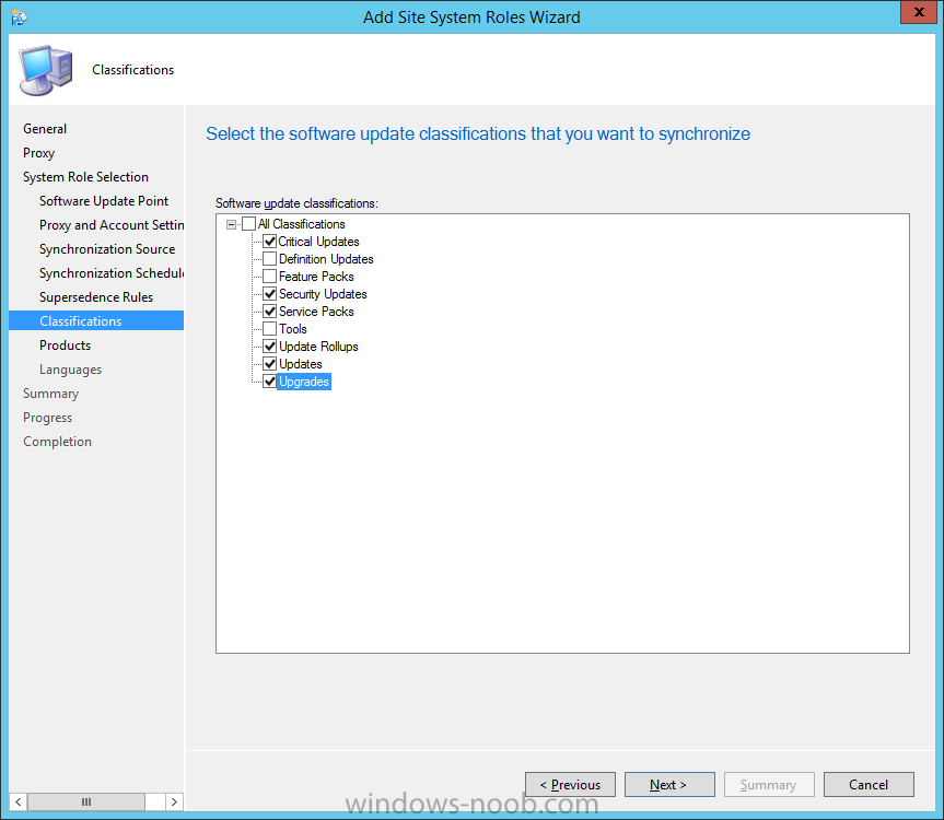

On the Select the software update classifications that you want to synchronize screen select those that are shown below, you'll see the following popup when you select the Upgrades Classification
Note: If the Upgrades classification is not listed review Step 1.

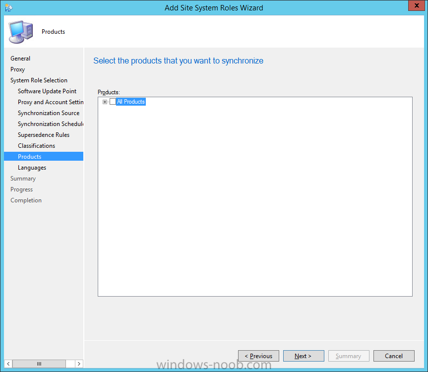

On the Select the products that you want to synchronize screen place a check mark in All Products and then remove it again, this will deselect everything before the first synchronization (recommended).

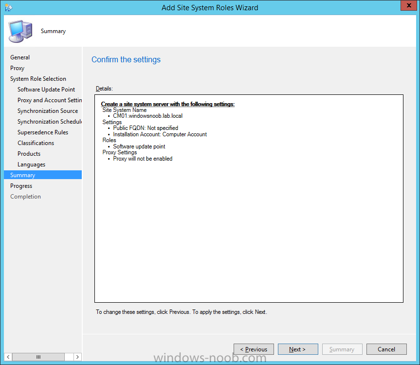

review the Summary

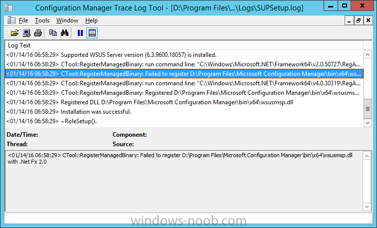

Note: Using CMTrace, review the SUPSetup.log on the server hosting the Software Update Point (SUP) role in <ConfigMgr Installation Path>\Logs to confirm that the installation of the SUP role succeeded. Look for a line that states "Installation was successful" as shown below.

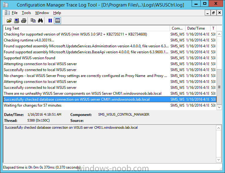

The first sync from the SUP will take some time, and you should monitor the following logs to verify that the sync is in progress and working as expected.
  • <ConfigMgr Installation Path>\Logs\WCM.log - Provides information about the software update point configuration and connecting to the WSUS server for subscribed update categories, classifications, and languages
  • <ConfigMgr Installation Path>\Logs\WSUSCtrl.log - Provides information about the configuration, database connectivity, and health of the WSUS server for the site
  • <ConfigMgr Installation Path>\Logs\Wsyncmgr.log - Provides information about the software updates synchronization process

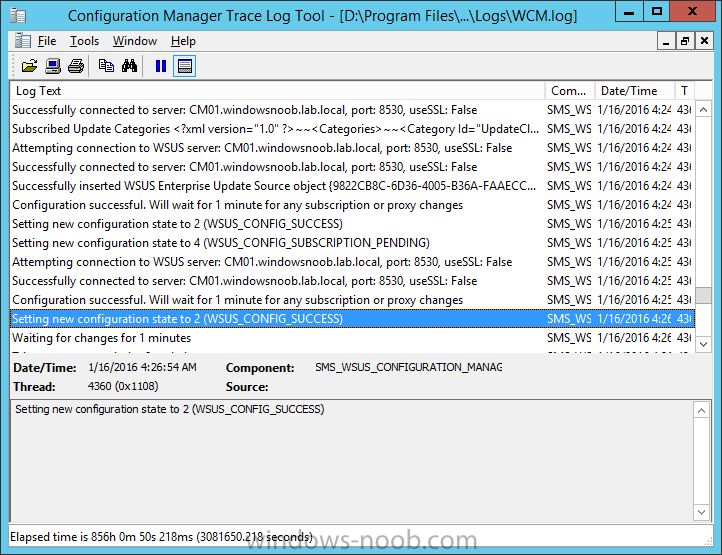

Here you can see the WCM.log file showing that WSUS was sucessfully configured

Here you can see the WSUSctrl.log file showing information about the configuration

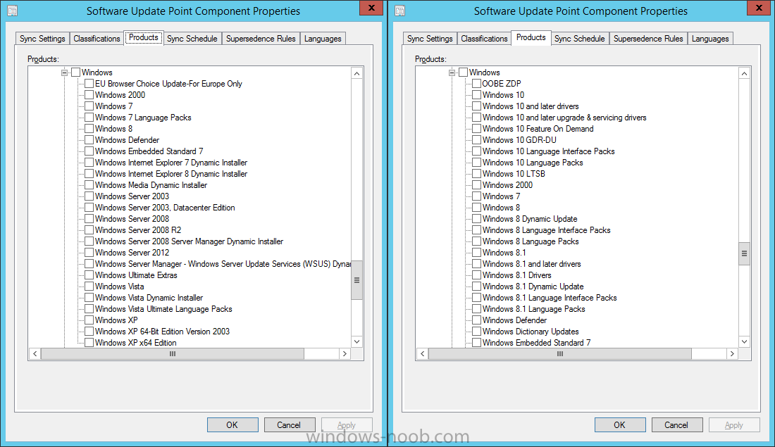

Step 3. Selecting Windows 10 as a product
After the first successful sync, the SUP should now have updated the list of Products available. Below you can see the Windows Products listed before (on the left) and after (on the right) the first SUP sync takes place.

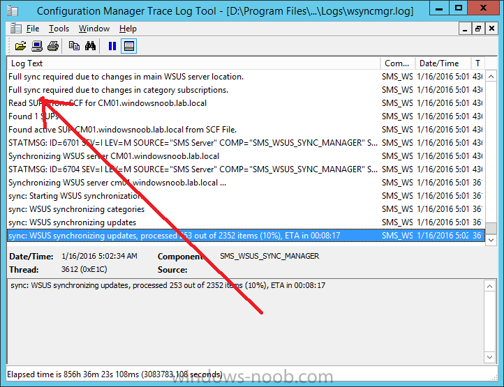

You will not see the updated products until the WCM.log states the following "Successfully refreshed categories from WSUS server"

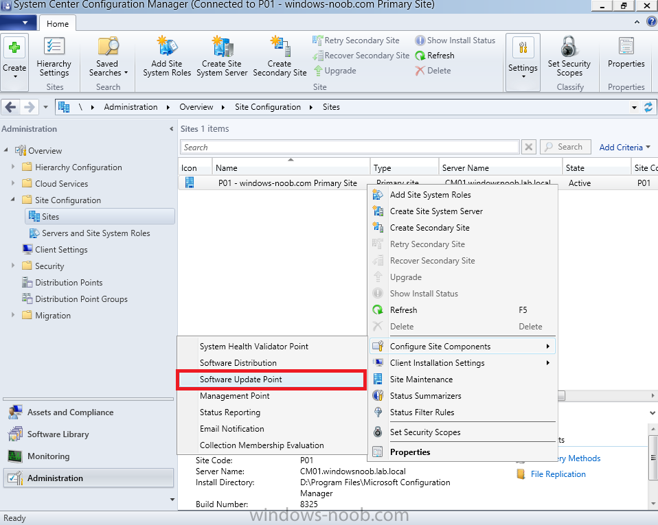

As you want Windows 10 to be secure and up to date, you'll need to re-configure the SUP role and specify Windows 10 from the list of available products. Using the ConfigMgr console, in the Administration workspace, expand Site Configuration and select Sites. Select the P01 Primary site, right click and choose Configure Site Components and then select Software Update Point

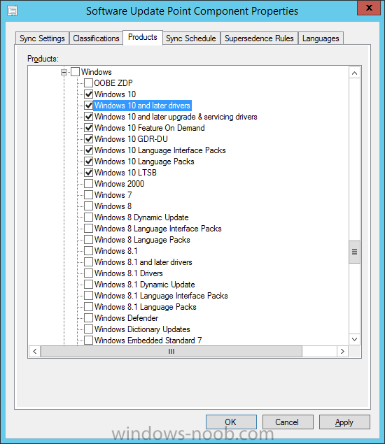

In the Software Update Point Component Properties screen select the Products tab and scroll down to Windows 10, make selections appropriate to your organization, click Apply and OK when done to apply and close the Software Update Point Component Properties.

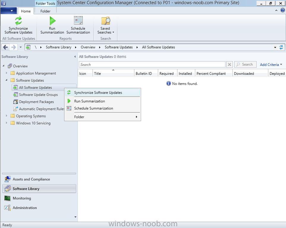

Now that you've made a change to the Products, perform a sync. To perform a sync do as follows. In the ConfigMgr console select the Software Library workspace, select Software Updates, right click on All Software Updates and choose Synchronize Software Updates. Answer Yes to the popup.

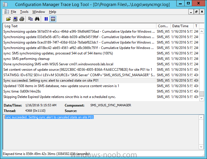

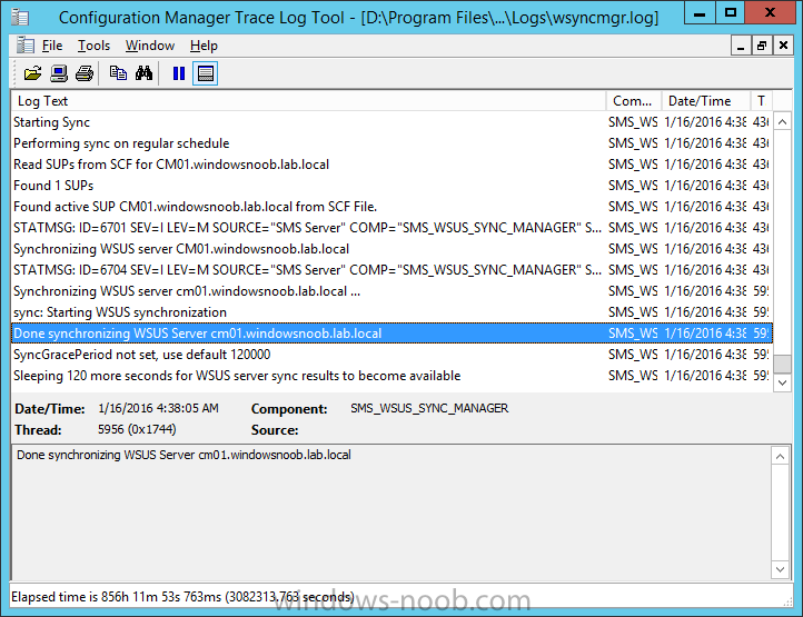

Using CMTrace, monitor the sync progress in <ConfigMgr Installation Path>\Logs\Wsyncmgr.log. This sync will take some time as you've changed the list of Products to sync and therefore a Full sync is required and noted in the log file.
Look for the Sync succeeded. Setting sync alert to canceled state on site P01 text in the log file to notify you of a successful sync.

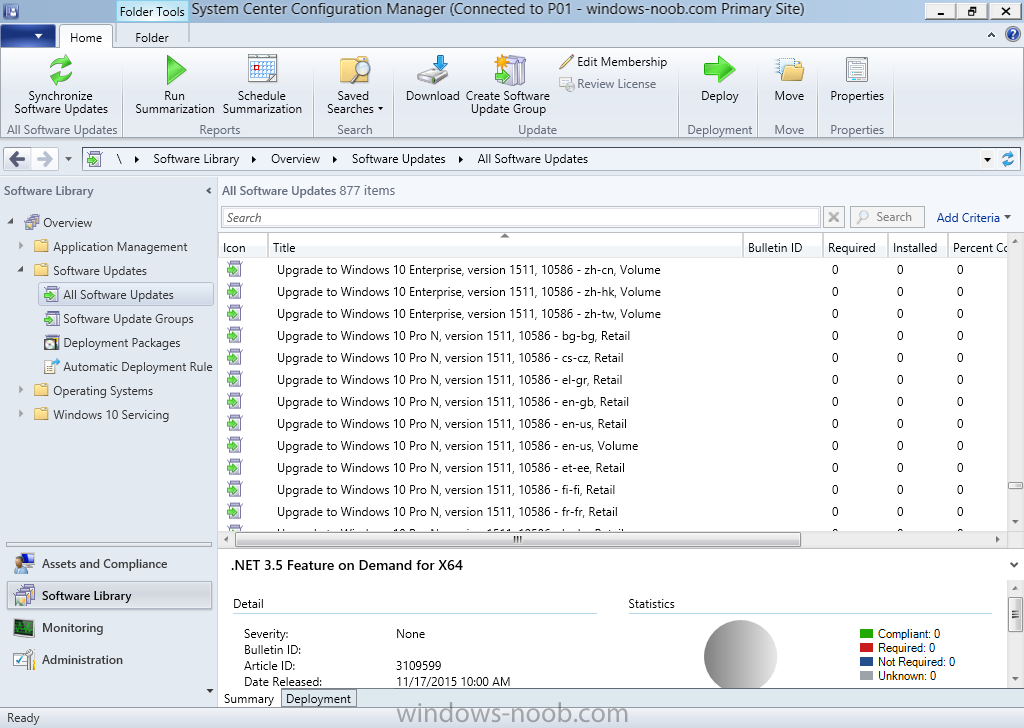

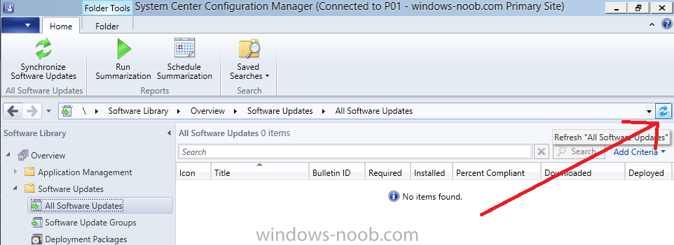

Now that the sync is completed it's time to refresh the All Software Updates view in the console. In the ConfigMgr console select the Software Library workspace, select Software Updates, select All Software Updates and press the Refresh All Software Updates button.
And you should see a whole bunch of updates (and upgrades) listed for Windows 10.

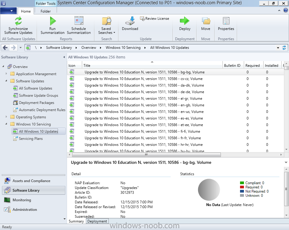

To see the Windows 10 Upgrade updates listed in the Windows 10 servicing section, in the ConfigMgr console select the Software Library workspace, select Windows 10 Servicing, select All Windows 10 Updates.
Note: I will cover servicing Windows 10 in a later post.

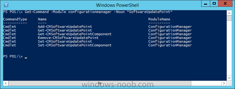

The above steps show how you can configure the SUP role using the ConfigMgr console, however you could script it all using PowerShell. The ConfigMgr PowerShell cmdlets for Software Update Point can be listed with the below command once you've connected to PowerShell in ConfigMgr.
Get-Command -Module configurationmanager -Noun *SoftwareUpdatePoint*

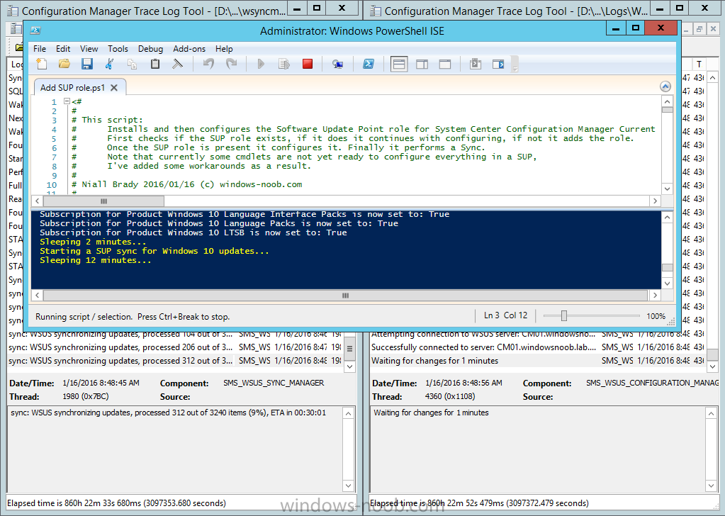

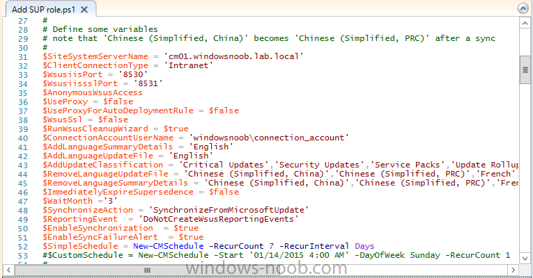

To add the Software Update Point (SUP) role using PowerShell do as follows. Download the Add SUP Role.ps1 contained in a zip file in the Downloads section at the bottom of this guide and extract it to C:\Temp.
Start Windows PowerShell ISE as Administrator and open Add SUP Role.ps1 script. Edit any variables in the script to match your environment before proceeding, and then save your changes.
When you are happy with the variables, consider changing which Products to sync. Check line number 192 and remove anything you are not interested in (for example, Windows 10 Language Packs). If you want to add Products to the script, do so here but make sure you specify it correctly or it will fail.
Save any changes, then run the script by pressing F5 or clicking on the Green arrow. Below you can see the script is running, don't worry about that warning in Orange, it's benign (safe to ignore). The script will perform two SUP syncs, the first is used to update the index (classifications, products etc) and the second sync actually syncs the Windows 10 updates which are appropriate to the Windows 10 products selected.
Note: Depending on the number of products you select, you may want to adjust the sleep settings of the second sync to work with your environment.
After the script is completed (it takes about 30 minutes for syncing All Windows 10 updates available, over 3240 items..) check the All Software Updates section of the ConfigMgr console. You might have to wait even longer for the console to display everything.
Job done ! Isn't PowerShell automation amazing.

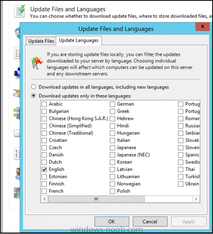

Note: The observant amongst you will notice different languages listed even though we only specified English. This is a bug (either in SCCM or WSUS, not sure which yet) and Microsoft is working on it.

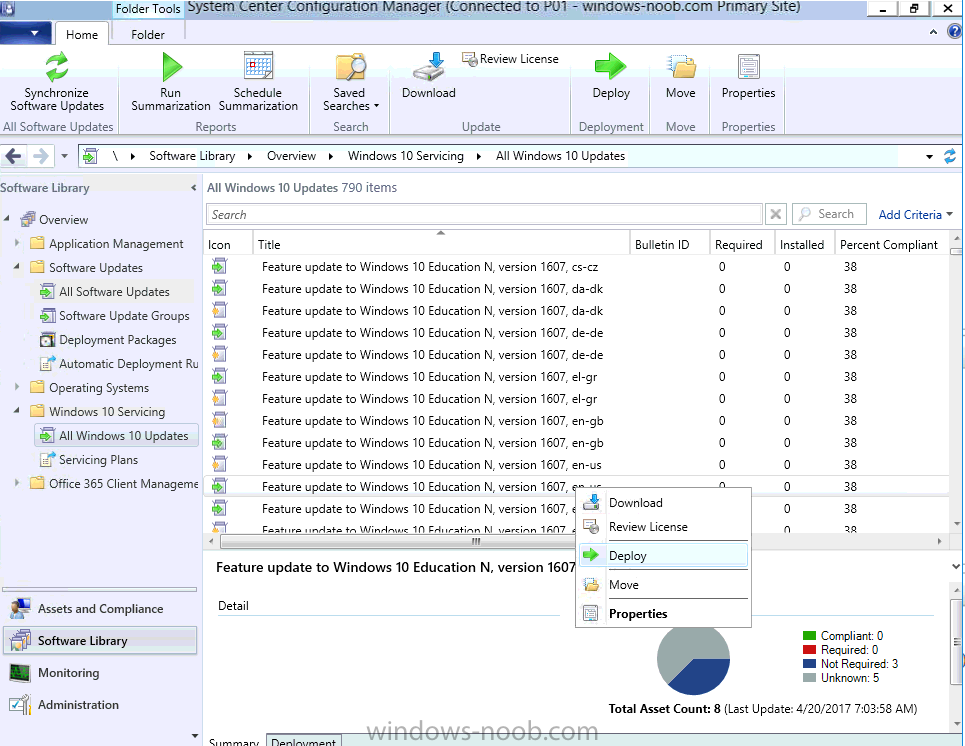

What can you actually do with those upgrades?
because as i understand it, you must use a servicing plan or task sequence (and task sequence uses an ISO?)
I mean, you can't do as you would with other updates, right click and deploy?
sure you can right click and deploy, and follow the wizard, it's just a software update after all, the ADR created by Servicing Plans is just a way to automate that...

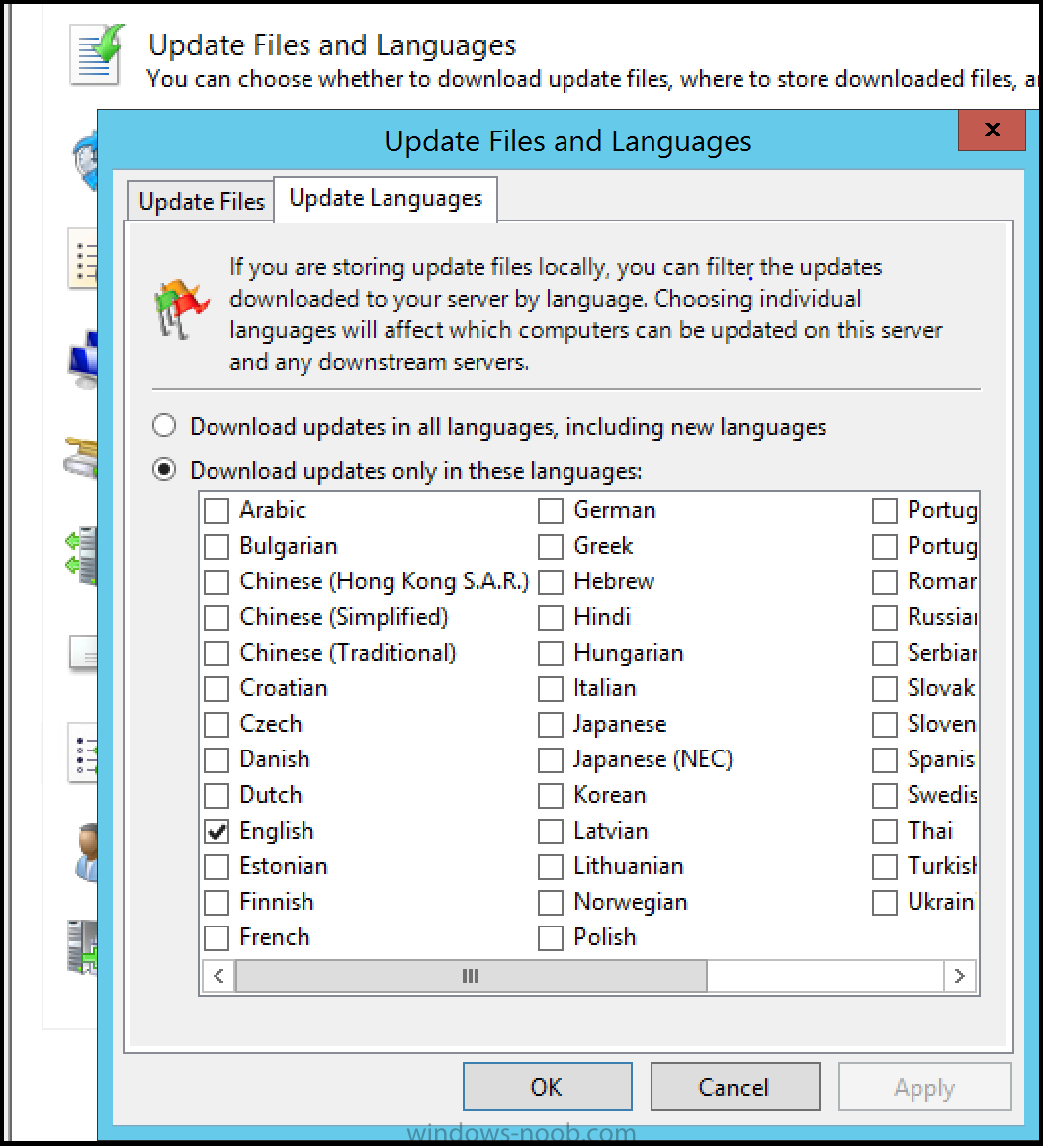

Niall,
Thanks for all the awesome guides! I got around the language issue by opening the WSUS console on the SUP, deselecting all languages besides the ones I needed and then syncing updates in the SCCM console. I performed these steps before my initial sync. It's odd that all of the other SUP settings carry over to WSUS besides the languages.

I got stuck at the end of the step 2, can someone please try to help?
This is what in my wsyncmgr.log:
Found 1 SUPs SMS_WSUS_SYNC_MANAGER 11/9/2016 4:11:04 PM 5832 (0x16C8)
Found active SUP CM01.sccmlab.com from SCF File. SMS_WSUS_SYNC_MANAGER 11/9/2016 4:11:04 PM 5832 (0x16C8)
DB Server not detected for SUP CM01.sccmlab.com from SCF File. skipping. SMS_WSUS_SYNC_MANAGER 11/9/2016 4:11:05 PM 5832 (0x16C8)
Sync failed: WSUS update source not found on site P01. Please refer to WCM.log for configuration error details.. Source: getSiteUpdateSource SMS_WSUS_SYNC_MANAGER 11/9/2016 4:11:05 PM 5832 (0x16C8)
STATMSG: ID=6703 SEV=E LEV=M SOURCE="SMS Server" COMP="SMS_WSUS_SYNC_MANAGER" SYS=CM01.sccmlab.com SITE=P01 PID=2492 TID=5832 GMTDATE=Thu Nov 10 00:11:05.594 2016 ISTR0="getSiteUpdateSource" ISTR1="WSUS update source not found on site P01. Please refer to WCM.log for configuration error details." ISTR2="" ISTR3="" ISTR4="" ISTR5="" ISTR6="" ISTR7="" ISTR8="" ISTR9="" NUMATTRS=0 SMS_WSUS_SYNC_MANAGER 11/9/2016 4:11:05 PM 5832 (0x16C8)
Sync failed. Will retry in 60 minutes SMS_WSUS_SYNC_MANAGER 11/9/2016 4:11:06 PM 5832 (0x16C8)
Setting sync alert to active state on site P01 SMS_WSUS_SYNC_MANAGER 11/9/2016 4:11:06 PM 5832 (0x16C8)
This is the WSUSCtrl:
Successfully connected to local WSUS server SMS_WSUS_CONTROL_MANAGER 11/9/2016 4:11:34 PM 6836 (0x1AB4)
Errors were reported in these WSUS Server components WSUSService, on WSUS Server CM01.sccmlab.com SMS_WSUS_CONTROL_MANAGER 11/9/2016 4:11:34 PM 6836 (0x1AB4)
STATMSG: ID=7001 SEV=E LEV=M SOURCE="SMS Server" COMP="SMS_WSUS_CONTROL_MANAGER" SYS=CM01.sccmlab.com SITE=P01 PID=2492 TID=6836 GMTDATE=Thu Nov 10 00:11:34.243 2016 ISTR0="CM01.sccmlab.com" ISTR1="WSUSService," ISTR2="" ISTR3="" ISTR4="" ISTR5="" ISTR6="" ISTR7="" ISTR8="" ISTR9="" NUMATTRS=0 SMS_WSUS_CONTROL_MANAGER 11/9/2016 4:11:34 PM 6836 (0x1AB4)
Why i am getting "DB Server not detected for SUP CM01.sccmlab.com from SCF File. skipping. SMS_WSUS_SYNC_MANAGER 11/9/2016 4:11:05 PM 5832 (0x16C8)"
My SQL is up and running, console is up an no issues as well?
hi
the reason it's failing is because you need to configure the connection_account username (line 40) in the powershell script to use an account with permissions to do that configuration of WSUS
