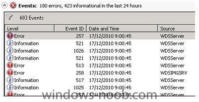

  2. Hello Anyweb, I might have found something (no, it's not working yet ...) I found the first error in the WDS-log, so after the capture of the laptop when WDS didn't want to start up anymore: 1. Error 1811 BINLSVC - an error occurred while checking for existence or creation of Service Control Point for BINLSVC Provider 2. Error 261 WDSXPE 3. Error 265 WDSXPE 4. Error 513 WDSSERVER Before these entries, everything worked just fine. I had some errors and an occasional warning prior to these ones, but the WDS worked ... Error 266 WdsImgSrv - An error occurred while refreshing settings (Error info: 0x3A) Warning 1291 BINLSVC - An image in the WIM file D:\remoteInstall\..... does not have a System Root defined. The WDS server wil use \\windows as the default ... Especially the 1811 error troubles me, I haven't got a clue why this problem occurred all of a sudden ... and very little info about this on the net (could be that I'm not looking in the right place ...) I hope this info can help resolve this really annoying problem. Thanks!
  3. Hello Anyweb and thanks for your time! The OS the server is running is Windows 2008 standard SP2 - 32bit (fully updated) Roles installed: DHCP and WDS Role services installed: Deployment server and Transport server WDS service startup type: Manual. I changed in automatic, automatic (delayed), ... same result Error ID's : 257-258-513. 513 says:"An error occured while trying to initialize provider WdsImgSrv from c:\windows\system32\WdsImgSrv.dll. Windows deployment server will be shut down... And like I said, it just stopped all of a sudden (after a capture), and no way to restart it ... Thanks again!
  4. Hello Anyweb, Sorry for the late reply, a little holyday ... I did what you suggested, but it doesn't work .... By the way, I didn't find anything in c:\windows\temp concerning WDS ... So I get the same error, ID 257, error info: 0xc1030104. Keywords: Classic. I'm seriously thinking about re-formatting the server; but on the other hand, after all the troubles I've had with SCCM (the WDS part) and the WDS server now, would it still be worth the work? Maybe I'll search for another solution ... BUT I still want to try and fix this problem and get my WDS to work again ... Many thanks again!
  5. Hello Any and All, I have a problem, and I hope someone can explain how this can happen. My WDS server has been working for almost half a year now, made tens of different images (Custom xp's, vista's, win7, 2K3&2K8 servers, ...), deployed much more. Works like a charm! Untill yesterday .... Captured a laptop XP image, and all of a sudden the WDS service stopped ... and no way to start it anymore. This is the exact same problem that I had with SCCM. Problem with SCCM is that when this wds stopped, I had to do a lot of stuff (take server out of domain, uninstall stuff, install stuff again, put back in domain, restart a few times ... iow no good for a server) EVERY time I captured an image. So I choose for a simpel solution: 1 win2K8 server with ONLY DHCP and WDS server. In the mean time, I've uninstalled ALL roles & services, but WDS is not starting anymore... The only thing left is to re-install the whole server, but that can't be right, no? I've also updated the server, but to no avail ... I dunno what more I can do. Hereby attached, the errors. I really hope that someone can help me figure this out!! Thanks in advance...

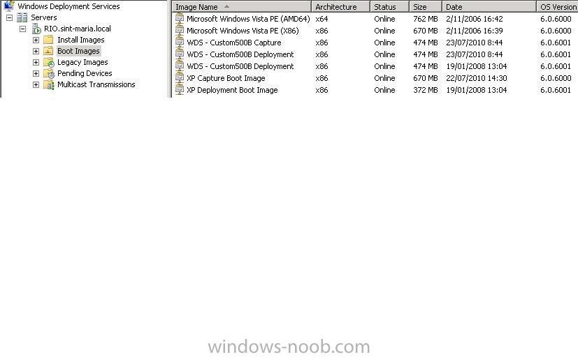

  6. Hi AnyWeb, thanks for this excellent Guide! I followed your guide step by step, then I had to inject some drivers to an image, all of that works finally. It's a bit confusing to me what image to use to make a custom boot.wim, and how to add it in WDS. But ok, after 2 days I found it. But now there's something bothering me: When I look in the boot images, I see 2 deployment images ... This I don't understand ... Could you tell me which is the correct one to use? And can I delete the other one?? (See attached JPG) You'll see "WDS-Custom500B Deployment" twice, with 2 different dates, while I made only 1 Deployment image on 23/07 ... I'm a bit stumped here ... dunno which image to use ... Could you help me please? Many thanks!!

  22. Hello All, Ok, i got my WDS running again ..... I was just about to re-install the whole server ... Little recap : errors where: 0x32, 0x41B, Event 257: An error occurred trying to start the Windows Deployment Services server. Event 258: An error occurred trying to start the Windows Deployment Services image server. Event 266: An error occurred while to refreshing settings. Event 513: An error occurred trying to initialize provider WDSImgSrv from C:\Windows\system32\WdsImgSrv.dll. Windows Deployment Services server will be shutdown. Start of the problems: Uninstalled WDS, removed PXE role from SCCM, (reboot), re-installed WDS, re-installed PXE --> unable to start WDS again ... Solution that worked for me: Remove PXE role Uninstall WDS Reboot Removed my server from AD (put in in a workgroup) Deleted my (SCCM) server-account from AD Reboot Then I ran CCleaner, deleted all program and Register issues Reboot Put the (SCCM) server back into our Domain Install WDS Install PXE role Intialized WDS with command line which gave me the same error as before Open Windows Deployment Services, Properties: Respond to all (known and unknown)computers, delay 5 sec Obtain IP from DHCP Do not listen on port 67, Configure DHCP option to 60 'PXEClient' Started the WDS service and off it goes!!! I read that a lot of people have a problem with this, and i think it's a bug somewhere. I don't think it's a user-related problem. I hope that people can use these steps I took to make it run again, and don't lose precious time as I did. So now my client gets a DHCP-address again, but now I get Kingskawn 3rd screen (Windows failed to start). Before fixing that, I'm going to take an ghost-image of my server so that if i have this or another problem I'll just need to put the image back. Cheers!
