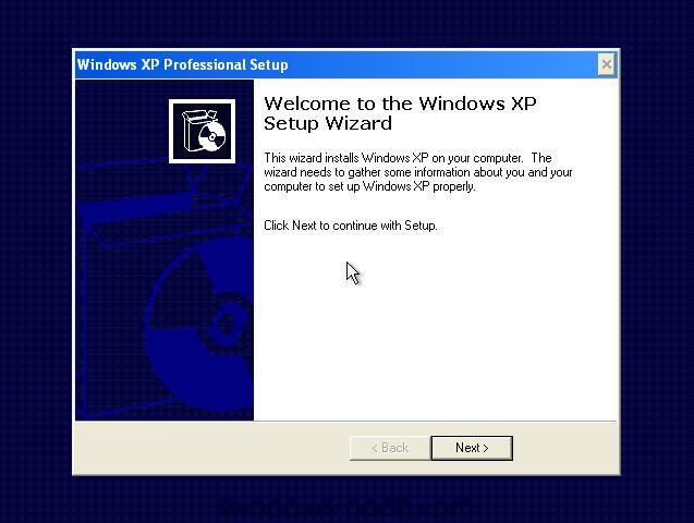

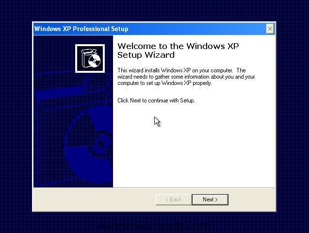

anyweb Posted October 30, 2008 Report post Posted October 30, 2008 PXE boot the client and start the deployment PXE boot your client Windows PE should start and the Task Sequence should kick in... and XP is being installed after a reboot you'll see some old familiar XP setup screens... then back to the XP setup GUI if you get this error then you'll know that you need to edit your Task Sequence and change the following setting (Apply Windows Settings) back to the Task Sequence... Just before running Sysprep, the task sequence will run the 'Install Deployment Tools' section within our Task Sequence and you may see a failure here where you get an error similar to task sequence failed with the error code 0x00000002 If you get this error then verify the following: 1. you have added the Windows XP network driver for the client's network card as a driver in SCCM and added it to a driver package and added in to the Task Sequence 2. create a distribution point and then updated the distribution point for the network driver package Once done, re-run the TS and all should be ok. running Sysprep capturing the sysprepped XP image to a WIM file and storing it on our SCCM server After the capture is done, the computer will restart and boot into XP, at this point you now have a captured WIM file with your Windows XP image. You can use that WIM file to Deploy your XP clients. In other words, you now have a WIM image of a Sysprepped Windows XP installation targetted for the hardware you just ran this on. You now have the options to * create a new Operating System Image using this WIM file,. and then create a new Task Sequence for deploying it to bare metal pcs, or * use a Custom Installation DVD. or deploy this image using imageX or other methods like WDS\MDT, but you really want to use SCCM for this right ? Quote Share this post Link to post Share on other sites More sharing options...

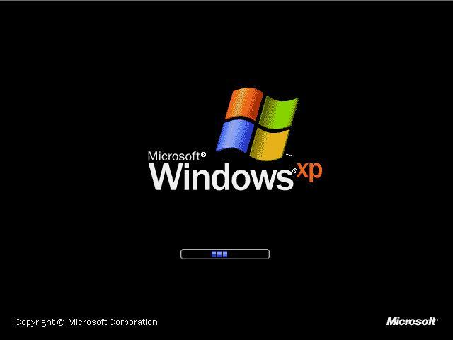

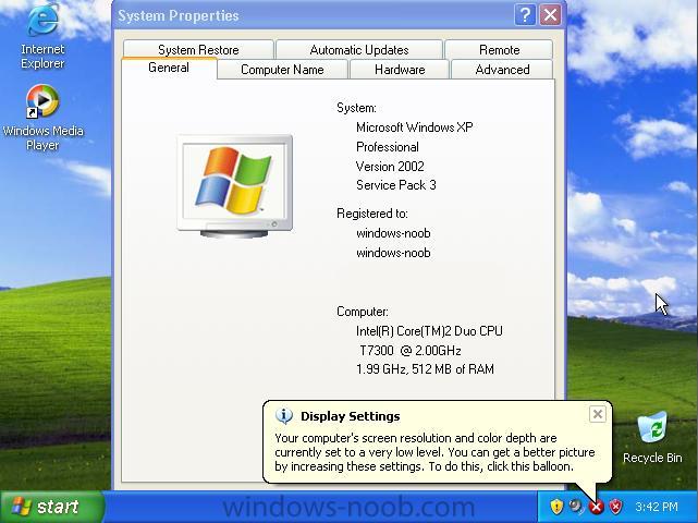

anyweb Posted April 4, 2009 Report post Posted April 4, 2009 Please note that all screenshots below here are what your systems will see on first boot after being deployed with the captured WIM we have just created above. after the computer restarts you'll get the chance to see your sysprep settings... after a few more screens and one last reboot you'll get to play with your XP SP3 client, if you are left with some drivers not installing correctly then take a look at this post. Now all you have to do is deploy the image by creating One more task sequence, this time the task sequence will use the Captured XP sp3 image as the operating system image. If you find the SCCM client is not installed after deploying this image then read this post You can then install 974571 as the very last step in the TS using for example an install software step. Apparently we’ve seen very similar symptoms a few times now and this resolves. 974571 MS09-056: Vulnerabilities in CryptoAPI could allow spoofing http://support.microsoft.com/default.aspx?scid=kb;EN-US;974571 cheers anyweb Quote Share this post Link to post Share on other sites More sharing options...
