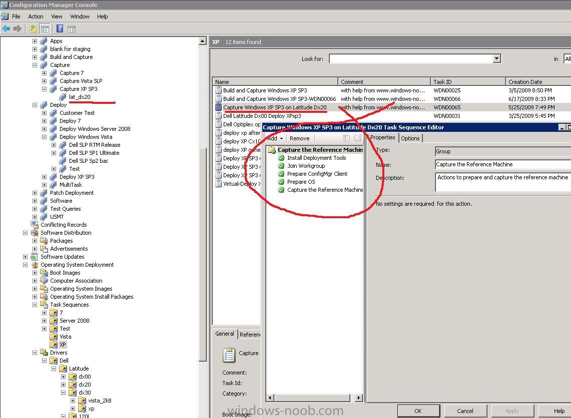

I'm trying to break down my XP build and capture into 2 parts. One the build and two the capture. This way I have a pause in between so I can load custom software/settings etc. My question is how do I separate the capture phase from the build phase.
Attached is the task process I believe the way it is supposed to be. My question is do I need to add the "restart in pe phase" to the capture phase? Is this the proper way to set this up? Any help would be appreciated.

Ok I have it setup like the 3rd box in the image above. I added this task sequence to a collection and rebooted the PC. But it did not work. Here are the errors i received.
The step (Install Deployment Tools) must be running in full OS TSManager 9/1/2009 5:32:39 PM 1428 (0x0594)
Failed to run the action: Install Deployment Tools.
The request is not supported. (Error: 80070032; Source: Windows) TSManager 9/1/2009 5:32:39 PM 1428 (0x0594)
The execution of the group (Capture the Reference Machine) has failed and the execution has been aborted. An action failed.
Operation aborted (Error: 80004004; Source: Windows) TSManager The execution of the group (Capture the Reference Machine) has failed and the execution has been aborted. An action failed.
Operation aborted (Error: 80004004; Source: Windows) TSManager 9/1/2009 5:32:39 PM 1428 (0x0594)
Failed to run the last action: Install Deployment Tools. Execution of task sequence failed.
The request is not supported. (Error: 00000032; Source: Windows) TSManager 9/1/2009 5:32:39 PM 1428 (0x0594)
Task Sequence Engine failed! Code: enExecutionFail TSManager 9/1/2009 5:47:51 PM 1428 (0x0594)
Task sequence execution failed with error code 80004005 TSManager 9/1/2009 5:47:51 PM 1428 (0x0594)
