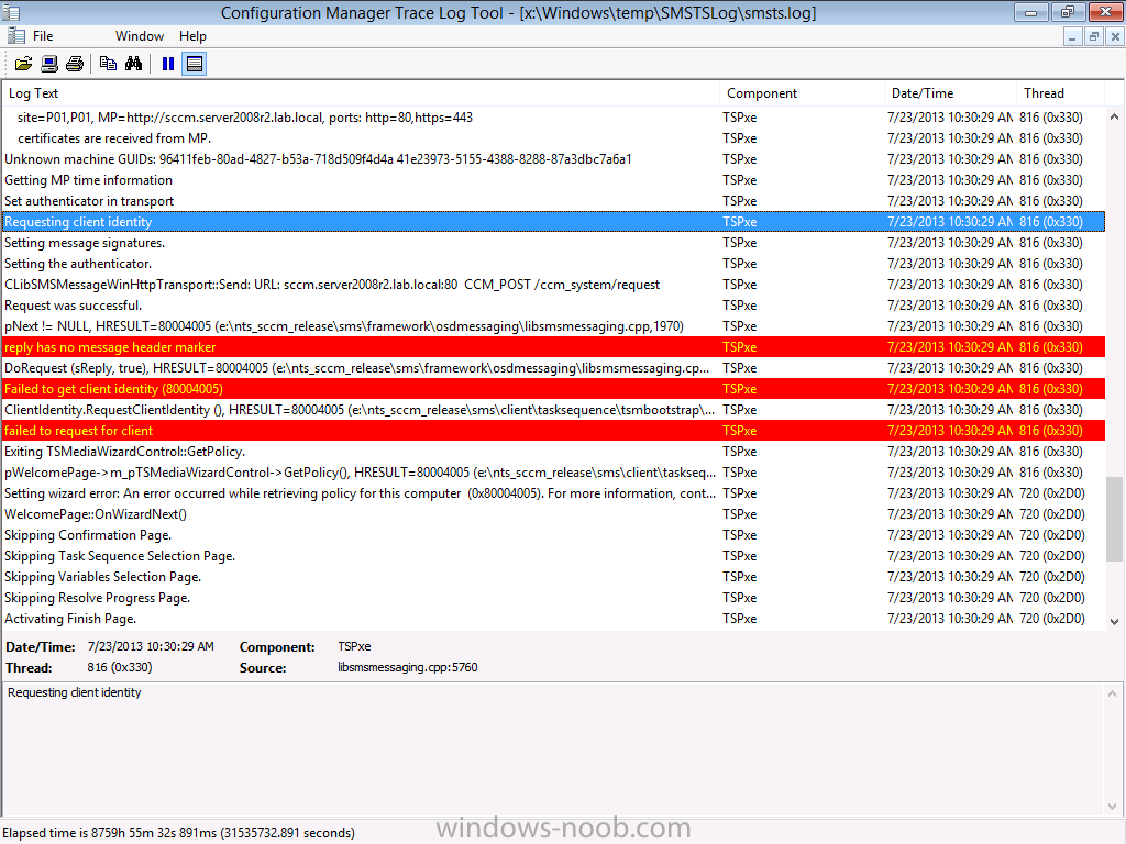

Problem
Failure to retrieve policy means you cannot run any task sequence and the failure will in turn produce an error just before running any Required (Mandatory) task sequence or before displaying a list of one or more Available (optional) task sequences.
Note: The error produced occurs immediately after entering the PXE password if one is set. The error message displayed to the end user is shown below, in the example below the DATE was set to one year earlier than the current date:
Failed to Run Task Sequence An error occurred while retrieving policy for this computer (0x80004005). For more information, please contact your system administrator or helpdesk operator.
and the actual error message shown using CMTrace in red text in the SMSTS.LOG file found in x:\windows\temp\smstslog is shown below
and the text of the error message contained in SMSTS.LOG will appear something like the below
<![LOG[reply has no message header marker]LOG]!><time="17:18:38.515+480" date="07-22-2013" component="TSPxe" context="" type="3" thread="1260" file="libsmsmessaging.cpp:1970">
<![LOG[DoRequest (sReply, true), HRESULT=80004005 (e:\qfe\nts\sms\framework\osdmessaging\libsmsmessaging.cpp,5868)]LOG]!><time="17:18:38.515+480" date="07-22-2013" component="TSPxe" context="" type="0" thread="1260" file="libsmsmessaging.cpp:5868">
<![LOG[Failed to get client identity (80004005)]LOG]!><time="17:18:38.530+480" date="07-22-2013" component="TSPxe" context="" type="3" thread="1260" file="libsmsmessaging.cpp:6148">
<![LOG[ClientIdentity.RequestClientIdentity (), HRESULT=80004005 (e:\qfe\nts\sms\client\tasksequence\tsmbootstrap\tsmediawizardcontrol.cpp,1114)]LOG]!><time="17:18:38.530+480" date="07-22-2013" component="TSPxe" context="" type="0" thread="1260" file="tsmediawizardcontrol.cpp:1114">
<![LOG[failed to request for client]LOG]!><time="17:18:38.530+480" date="07-22-2013" component="TSPxe" context="" type="3" thread="1260" file="tsmediawizardcontrol.cpp:1114">
<![LOG[Exiting TSMediaWizardControl::GetPolicy.]LOG]!><time="17:18:38.530+480" date="07-22-2013" component="TSPxe" context="" type="0" thread="1260" file="tsmediawizardcontrol.cpp:1420">

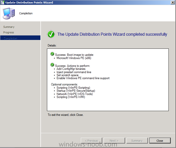

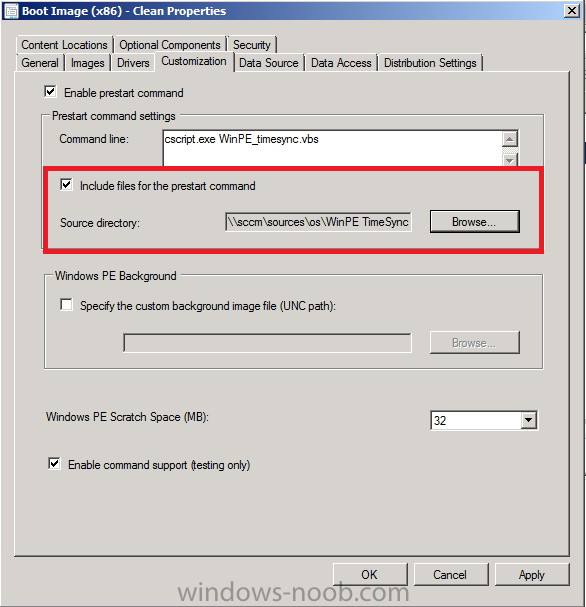

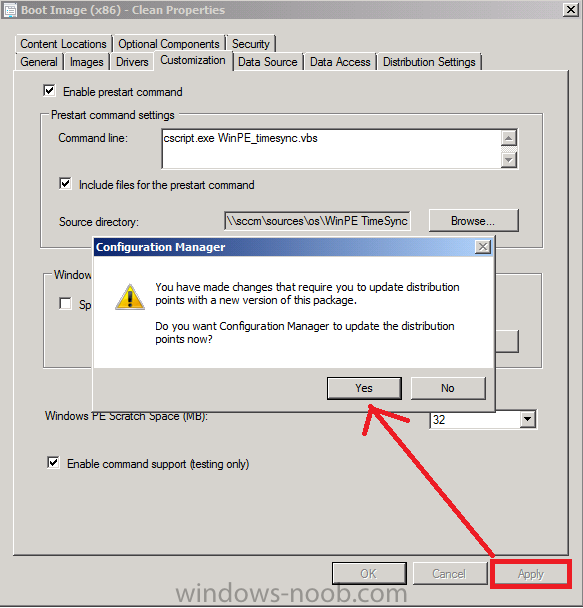

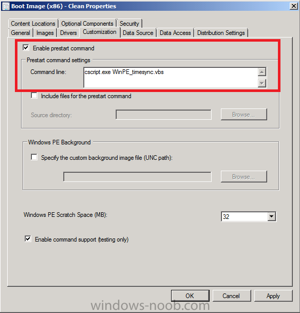

Step 2. Add a prestart command to your boot wim
Locate a boot image that you are using in your Task Sequences, and right click it, choose properties.
click on the Customization tab and place a checkmark in Enable Prestart Command as in the screenshot below, enter the following in the box provided
cscript.exe WinPE_TimeSync.vbs
Next, place a checkmark in the Include files for the prestart command and click on browse, then browse to the network share where the script downloaded above is stored as shown in the screenshot below
Apply the changes above, and answer yes when prompted as shown below
Click next when prompted and continue through that wizard to completion.

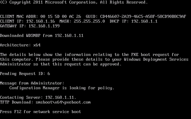

Step 3. Test PXE boot
Using a computer that has the bios DATE deliberately set incorrectly (like 05-05-05) PXE boot the computer. If you only have access to a virtual machine such as hyperV then PXE boot and before entering the PXE password press F8, then type Date and enter the date 05-05-05.

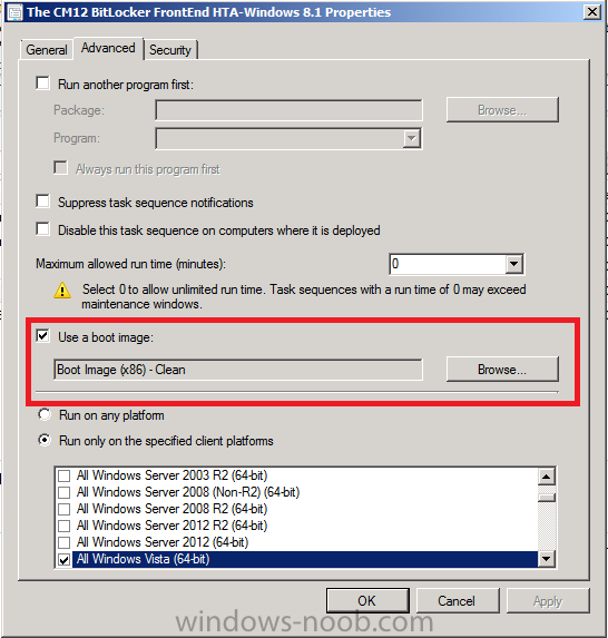

Note: Please make sure that the last deployed task sequence contain the boot image used above otherwise this prestart won't be used. You can do this by right clicking on the last deployed task sequence and verify what boot image is listed in the Advanced tab like below.
Once done, PXE boot the computer with that you plan on testing with.

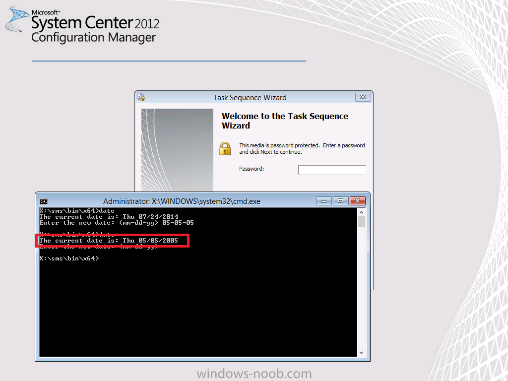

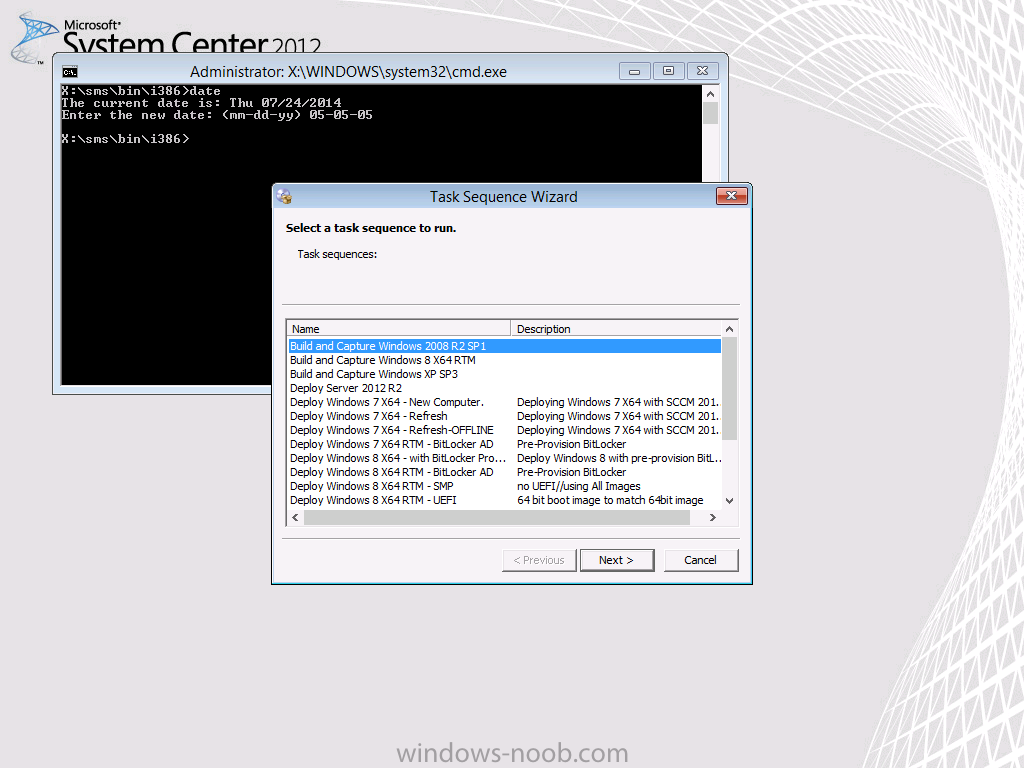

If it's a virtual machine like mine, press F8 and type date to set the date to something incorrect like 05-05-05 as shown below
Note: Without the prestart command and script provided here, the above date would be enough to produce the problem mentioned at the start of this guide !
Now you are ready to enter the PXE password, so go ahead and enter it, then press next, if you did the above correctly the prestart will pop up a command prompt window before running the script

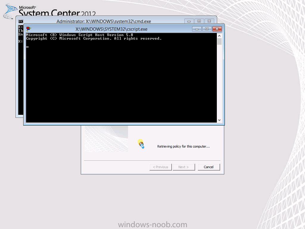

After a while, you'll see the list of task sequences displayed even though the computer had an incorrect BIOS date, now that is a result, no reboot needed !

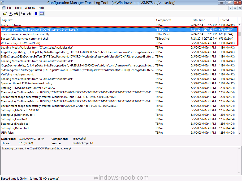

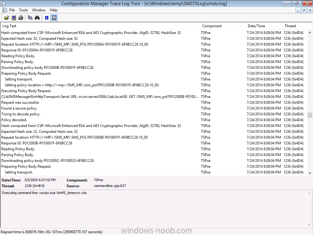

In the screenshot below we see the first command prompt we opened to forcefully change the date manually.

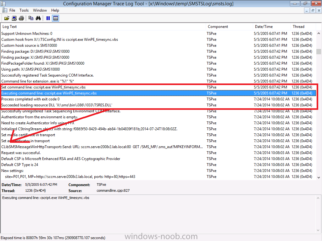

Notice how the logging jumps from the real date/time to 2005, that's the incorrect date now in 'action'.
scroll down a bit until you see it executing the prestart command as shown in the screenshot below, notice how before the prestart the date is 05-05-2005 but after it's changed to the correct date and that the date change correction occurs before the Management point is contacted
the rest of the smsts.log file will look like any normal one processing and downloading policy before displaying the list of task sequences, this would not be possible without the fix above.

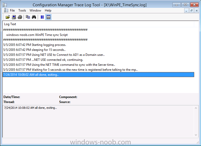

The script generates three log files listed below
  • WinPE_TimeSync.log
  • WinPE_Net_Use.log
  • WinPE_Net_Time.log
please refer to these logs when troubleshooting non-working scenarios, for comparison purposes you can see what my successful log files look like below:
WinPE_TimeSync.log
WinPE_Net_Use.log
WinPE_Net_Time.log
Also to note, the script outputs the net use and net time commands to the CMD prompt window (for troubleshooting), but you can REM those lines out by changing any line that begins with:

CryptDecrypt (hKey, 0, 1, 0, pData, &dwDecryptedLen), HRESULT=80090005 (e:\qfe\nts\sms\framework\smscrypt\windes.cpp,165) TSPxe 7/24/2014 6:00:27 PM 416 (0x01A0)
SMS::Crypto::DES::DecryptBuffer( (BYTE*)pszPassword, (DWORD)(wcslen(pszPassword)*sizeof(WCHAR)), encryptedBuffer.getBuffer(), (DWORD)encryptedBuffer.size(), pbDecryptedBuffer, dwDecryptedBufferSize ), HRESULT=80090005 (e:\qfe\nts\sms\framework\tscore\tsremovablemedia.cpp,387) TSPxe 7/24/2014 6:00:27 PM 416 (0x01A0)
Verifying media password. TSPxe 7/24/2014 6:00:27 PM 416 (0x01A0)
Loading Media Variables from "X:\sms\data\variables.dat" TSPxe 7/24/2014 6:00:27 PM 416 (0x01A0)
Spawned thread 852 to download policy. TSPxe 7/24/2014 6:00:27 PM 416 (0x01A0)
Entering TSMediaWizardControl::GetPolicy. TSPxe 7/24/2014 6:00:27 PM 852 (0x0354)
Creating key 'Software\Microsoft\SMS\47006C006F00620061006C005C007B00350031004100300031003600420036002D0046003000440045002D0034003700350032002D0042003900370043002D003500340045003600460033003800360041003900310032007D00' TSPxe 7/24/2014 6:00:27 PM 852 (0x0354)
Environment scope successfully created: Global\{51A016B6-F0DE-4752-B97C-54E6F386A912} TSPxe 7/24/2014 6:00:27 PM 852 (0x0354)
Creating key 'Software\Microsoft\SMS\47006C006F00620061006C005C007B00420041003300410033003900300030002D0043004100360044002D0034006100630031002D0038004300320038002D003500300037003300410046004300320032004200300033007D00' TSPxe 7/24/2014 6:00:27 PM 852 (0x0354)
Environment scope successfully created: Global\{BA3A3900-CA6D-4ac1-8C28-5073AFC22B03} TSPxe 7/24/2014 6:00:27 PM 852 (0x0354)
Setting LogMaxSize to 1000000 TSPxe 7/24/2014 6:00:27 PM 852 (0x0354)
Setting LogMaxHistory to 1 TSPxe 7/24/2014 6:00:27 PM 852 (0x0354)
Setting LogLevel to 0 TSPxe 7/24/2014 6:00:27 PM 852 (0x0354)
Setting LogEnabled to 1 TSPxe 7/24/2014 6:00:27 PM 852 (0x0354)
Setting LogDebug to 1 TSPxe 7/24/2014 6:00:27 PM 852 (0x0354)
UEFI: true TSPxe 7/24/2014 6:00:27 PM 852 (0x0354)
Loading variables from the Task Sequencing Removable Media. TSPxe 7/24/2014 6:00:27 PM 852 (0x0354)
Loading Media Variables from "X:\sms\data\variables.dat" TSPxe 7/24/2014 6:00:27 PM 852 (0x0354)
Succeeded loading resource DLL 'X:\sms\bin\x64\1033\TSRES.DLL' TSPxe 7/24/2014 6:00:27 PM 852 (0x0354)
Setting SMSTSMP TS environment variable TSPxe 7/24/2014 6:00:27 PM 852 (0x0354)
Setting _SMSMediaGuid TS environment variable TSPxe 7/24/2014 6:00:27 PM 852 (0x0354)
Setting _SMSTSBootMediaPackageID TS environment variable TSPxe 7/24/2014 6:00:27 PM 852 (0x0354)
Setting _SMSTSHTTPPort TS environment variable TSPxe 7/24/2014 6:00:27 PM 852 (0x0354)
Setting _SMSTSHTTPSPort TS environment variable TSPxe 7/24/2014 6:00:27 PM 852 (0x0354)
Setting _SMSTSIISSSLState TS environment variable TSPxe 7/24/2014 6:00:27 PM 852 (0x0354)
Setting _SMSTSLaunchMode TS environment variable TSPxe 7/24/2014 6:00:27 PM 852 (0x0354)
Setting _SMSTSMediaPFX TS environment variable TSPxe 7/24/2014 6:00:27 PM 852 (0x0354)
Setting _SMSTSPublicRootKey TS environment variable TSPxe 7/24/2014 6:00:27 PM 852 (0x0354)
Setting _SMSTSSiteCode TS environment variable TSPxe 7/24/2014 6:00:27 PM 852 (0x0354)
Setting _SMSTSSiteSigningCertificate TS environment variable TSPxe 7/24/2014 6:00:27 PM 852 (0x0354)
Setting _SMSTSUseFirstCert TS environment variable TSPxe 7/24/2014 6:00:27 PM 852 (0x0354)
Setting _SMSTSx64UnknownMachineGUID TS environment variable TSPxe 7/24/2014 6:00:27 PM 852 (0x0354)
Setting _SMSTSx86UnknownMachineGUID TS environment variable TSPxe 7/24/2014 6:00:27 PM 852 (0x0354)
Root CA Public Certs= TSPxe 7/24/2014 6:00:27 PM 852 (0x0354)
Missing root CA environment variable from variables file TSPxe 7/24/2014 6:00:27 PM 852 (0x0354)
Support Unknown Machines: 0 TSPxe 7/24/2014 6:00:27 PM 852 (0x0354)
Custom hook from X:\\TSConfig.INI is cscript.exe WinPE_timesync_.vbs TSPxe 7/24/2014 6:00:27 PM 852 (0x0354)
Custom hook source is SMS10000 TSPxe 7/24/2014 6:00:27 PM 852 (0x0354)
Finding package: C:\SMS\PKG\SMS10000 TSPxe 7/24/2014 6:00:28 PM 852 (0x0354)
Finding package: D:\SMS\PKG\SMS10000 TSPxe 7/24/2014 6:00:28 PM 852 (0x0354)
Finding package: E:\SMS\PKG\SMS10000 TSPxe 7/24/2014 6:00:28 PM 852 (0x0354)
Finding package: X:\SMS\PKG\SMS10000 TSPxe 7/24/2014 6:00:28 PM 852 (0x0354)
FindPackageFolder found: X:\SMS\PKG\SMS10000 TSPxe 7/24/2014 6:00:28 PM 852 (0x0354)
Using path: X:\SMS\PKG\SMS10000 TSPxe 7/24/2014 6:00:28 PM 852 (0x0354)
Successfully registered Task Sequencing COM Interface. TSPxe 7/24/2014 6:00:28 PM 852 (0x0354)
Command line for extension .exe is "%1" %* TSPxe 7/24/2014 6:00:28 PM 852 (0x0354)
Set command line: cscript.exe WinPE_timesync_.vbs TSPxe 7/24/2014 6:00:28 PM 852 (0x0354)
Executing command line: cscript.exe WinPE_timesync_.vbs TSPxe 7/24/2014 6:00:28 PM 852 (0x0354)
Executing command line: X:\WINDOWS\system32\cmd.exe /k TSBootShell 7/24/2014 6:00:31 PM 836 (0x0344)
The command completed successfully. TSBootShell 7/24/2014 6:00:31 PM 836 (0x0344)
Successfully launched command shell. TSBootShell 7/24/2014 6:00:31 PM 836 (0x0344)
Process completed with exit code 0 TSPxe 7/24/2014 6:01:00 PM 852 (0x0354)
Succeeded loading resource DLL 'X:\sms\bin\x64\1033\TSRES.DLL' TSPxe 7/24/2014 6:01:00 PM 852 (0x0354)
Successfully unregistered Task Sequencing Environment COM Interface. TSPxe 7/24/2014 6:01:00 PM 852 (0x0354)
Authenticator from the environment is empty. TSPxe 7/24/2014 6:01:00 PM 852 (0x0354)
Need to create Authenticator Info using PFX TSPxe 7/24/2014 6:01:00 PM 852 (0x0354)
Initialized CStringStream object with string: d22caf5b-9681-4fad-9943-a115fdcbc76a;2014-07-25T02:01:00Z. TSPxe 7/24/2014 6:01:00 PM 852 (0x0354)
Set media certificate in transport TSPxe 7/24/2014 6:01:00 PM 852 (0x0354)
Set authenticator in transport TSPxe 7/24/2014 6:01:00 PM 852 (0x0354)
CLibSMSMessageWinHttpTransport::Send: URL: MyConfigMgr2012R2-FQDN:80 GET /SMS_MP/.sms_aut?MPKEYINFORMATIONMEDIA TSPxe 7/24/2014 6:01:00 PM 852 (0x0354)
Request was successful. TSPxe 7/24/2014 6:01:00 PM 852 (0x0354)
Default CSP is Microsoft Enhanced RSA and AES Cryptographic Provider TSPxe 7/24/2014 6:01:00 PM 852 (0x0354)
Default CSP Type is 24 TSPxe 7/24/2014 6:01:00 PM 852 (0x0354)
New settings: TSPxe 7/24/2014 6:01:00 PM 852 (0x0354)
site=My-SiteCode,My-SiteCode, MP=http://MyConfigMgr2012R2-FQDN, ports: http=80,https=443 TSPxe 7/24/2014 6:01:00 PM 852 (0x0354)
certificates are received from MP. TSPxe 7/24/2014 6:01:00 PM 852 (0x0354)
Unknown machine GUIDs: ee25c72b-934d-4008-a952-d1217ec70954 7a9dfbae-3783-4769-851c-3d60d84775c1 TSPxe 7/24/2014 6:01:00 PM 852 (0x0354)
Getting MP time information TSPxe 7/24/2014 6:01:00 PM 852 (0x0354)
Requesting client identity TSPxe 7/24/2014 6:01:00 PM 852 (0x0354)
Setting message signatures. TSPxe 7/24/2014 6:01:00 PM 852 (0x0354)
Setting the authenticator. TSPxe 7/24/2014 6:01:00 PM 852 (0x0354)
CLibSMSMessageWinHttpTransport::Send: URL: MyConfigMgr2012R2-FQDN:80 CCM_POST /ccm_system/request TSPxe 7/24/2014 6:01:01 PM 852 (0x0354)
Request was successful. TSPxe 7/24/2014 6:01:01 PM 852 (0x0354)
pNext != NULL, HRESULT=80004005 (e:\qfe\nts\sms\framework\osdmessaging\libsmsmessaging.cpp,1970) TSPxe 7/24/2014 6:01:01 PM 852 (0x0354)
reply has no message header marker TSPxe 7/24/2014 6:01:01 PM 852 (0x0354)
DoRequest (sReply, true), HRESULT=80004005 (e:\qfe\nts\sms\framework\osdmessaging\libsmsmessaging.cpp,5868) TSPxe 7/24/2014 6:01:01 PM 852 (0x0354)
Failed to get client identity (80004005) TSPxe 7/24/2014 6:01:01 PM 852 (0x0354)
ClientIdentity.RequestClientIdentity (), HRESULT=80004005 (e:\qfe\nts\sms\client\tasksequence\tsmbootstrap\tsmediawizardcontrol.cpp,1114) TSPxe 7/24/2014 6:01:01 PM 852 (0x0354)
failed to request for client TSPxe 7/24/2014 6:01:01 PM 852 (0x0354)
Exiting TSMediaWizardControl::GetPolicy. TSPxe 7/24/2014 6:01:01 PM 852 (0x0354)
pWelcomePage->m_pTSMediaWizardControl->GetPolicy(), HRESULT=80004005 (e:\qfe\nts\sms\client\tasksequence\tsmbootstrap\tsmediawelcomepage.cpp,303) TSPxe 7/24/2014 6:01:01 PM 852 (0x0354)
Setting wizard error: An error occurred while retrieving policy for this computer (0x80004005). For more information, contact your system administrator or helpdesk operator. TSPxe 7/24/2014 6:01:01 PM 416 (0x01A0)
WelcomePage::OnWizardNext() TSPxe 7/24/2014 6:01:01 PM 416 (0x01A0)
Skipping Confirmation Page. TSPxe 7/24/2014 6:01:01 PM 416 (0x01A0)
Skipping Task Sequence Selection Page. TSPxe 7/24/2014 6:01:01 PM 416 (0x01A0)
Skipping Variables Selection Page. TSPxe 7/24/2014 6:01:01 PM 416 (0x01A0)
Skipping Resolve Progress Page. TSPxe 7/24/2014 6:01:01 PM 416 (0x01A0)
Activating Finish Page. TSPxe 7/24/2014 6:01:01 PM 416 (0x01A0)
Initializing the countdown timer. TSPxe 7/24/2014 6:01:01 PM 416 (0x01A0)
Loading bitmap TSPxe 7/24/2014 6:01:01 PM 416 (0x01A0)
Exiting task sequence wizard. TSPxe 7/24/2014 6:01:16 PM 416 (0x01A0)
Exiting with return code 0x00000000 TSPxe 7/24/2014 6:01:16 PM 416 (0x01A0)
Execution complete. TSBootShell 7/24/2014 6:01:16 PM 840 (0x0348)
hMap != 0, HRESULT=80070002 (e:\qfe\nts\sms\framework\tscore\environmentscope.cpp,493) TSBootShell 7/24/2014 6:01:16 PM 840 (0x0348)
m_pGlobalScope->open(), HRESULT=80070002 (e:\qfe\nts\sms\framework\tscore\environmentlib.cpp,335) TSBootShell 7/24/2014 6:01:16 PM 840 (0x0348)
this->open(), HRESULT=80070002 (e:\qfe\nts\sms\framework\tscore\environmentlib.cpp,553) TSBootShell 7/24/2014 6:01:16 PM 840 (0x0348)
::RegOpenKeyExW (HKEY_LOCAL_MACHINE, sKey.c_str(), 0, KEY_READ, &hSubKey), HRESULT=80070002 (e:\qfe\nts\sms\framework\tscore\utils.cpp,809) TSBootShell 7/24/2014 6:01:16 PM 840 (0x0348)
RegOpenKeyExW is unsuccessful for Software\Microsoft\SMS\Task Sequence TSBootShell 7/24/2014 6:01:16 PM 840 (0x0348)
GetTsRegValue() is unsuccessful. 0x80070002. TSBootShell 7/24/2014 6:01:16 PM 840 (0x0348)
End program: TSBootShell 7/24/2014 6:01:16 PM 840 (0x0348)
Finalizing logging from process 832 TSBootShell 7/24/2014 6:01:16 PM 840 (0x0348)
Finalizing logs to root of first available drive TSBootShell 7/24/2014 6:01:16 PM 840 (0x0348)
LOGGING: Setting log directory to "C:\SMSTSLog". TSBootShell 7/24/2014 6:01:16 PM 840 (0x0348)
WinPE_net_use.log:
WinPE_TimeSync.log:
WinPE Time sync Script
7/24/2014 6:00:28 PM Starting logging process.
7/24/2014 6:00:28 PM sleeping for 15 seconds..
7/24/2014 6:00:43 PM Using NET USE to Connect to ConfigMgr-2012R2-Server as a Domain user..
7/24/2014 6:00:45 PM ...NET USE connected ok, continuing.
7/24/2014 6:00:45 PM Using the NET TIME command to sync with the Server time..
7/24/2014 6:00:45 PM Waiting for 15 seconds so the new time is registered before talking to the mp..
7/24/2014 6:01:00 PM all done, exiting..
