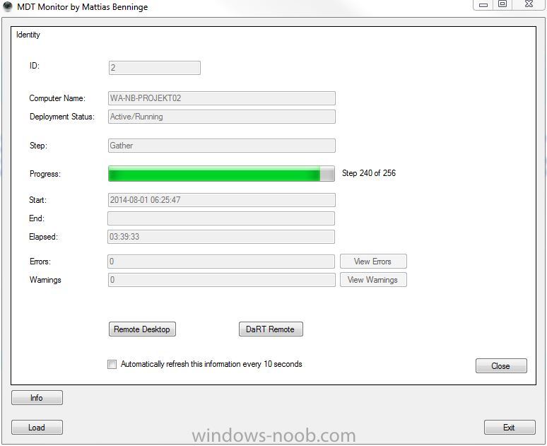

Hello,
i have configured the monitoring from the MDT-Workbench and it works like a charm. I can see the SCCM-Task-Sequences running and reporting every time the MDT-Gather step runs. My only problem is now, that i would not show, when the TS is finished. It hangs on "Running" forever and change to "not responding" after some time. Do i need some "finishing" step at the end of the UDI-Tasksequence to inform the Monitoring-Web-Service that the TS is finished? I have tryed to put a "Gather"-Step at the end, but its not working. Additionally i have added a FinishAction= and SkipFinalSummary= Step to the CustomSettings.ini in the settings-files. Haven't tested that yet, because of running installations of other users. Is that maybe the right step?
Thanks for helping.
Dominik
