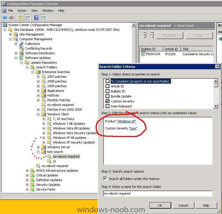

you could specify in the custom severity field that it's LOW for example and search for that
but then you'd have to do a lot of manual work deciding which updates were 'LOW', however I did a quick test and it seems to work
see pic, the update in the pic may require a reboot but I marked the custom severity of it under the All Windows XP Updates search folder as LOW for this test, then created a new search folder as you can see below
