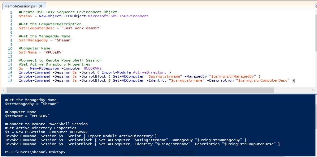

I opted for the 2nd. Here is the script.
#Create OSD Task Sequence Environment Object
$tsenv = New-Object -COMObject Microsoft.SMS.TSEnvironment
#Get the ComputerDescription
$strComputerDesc = $tsenv.Value("OSDComputerDesc")
#Get the ManagedBy Name
$strManagedBy = $tsenv.Value(“OSDManagedBy”)
#Computer Name
$strName = $env:computername
#Connect to Remote PowerShell Session
#Set Active Directory Properties
$s = New-PSSession -Computer SERVERNAME
Invoke-Command -Session $s -Script { Import-Module ActiveDirectory }
Invoke-Command -Session $s -ScriptBlock { Set-ADComputer "$using:strname" -ManagedBy "$using:strManagedBy" }
Invoke-Command -Session $s -ScriptBlock { Set-ADComputer -Identity "$using:strname" -Description "$using:strComputerDesc" }
When I run this script on a machine, and replace the ComputerDesc, ManagedBy, and Name variables with static variables - the script runs off without a hitch. When I run it in the task sequence, it fails with this log entry.

Well I got it working finally - and it turned out to be a bit more complicated than previously expected, so I will post sort of a "How To" on how to modify the ManagedBy and Description fields during OSD should anyone find any use for that.
After first using the UDI Wizard Editor to add the page into the wizard, generating the OSDComputerDesc and OSDManagedBy variables, I then needed to develop the PowerShell to use those variables.
Below is the code that ended up doing the trick.
#Computer Name
#Get PSSession Credentials
$strUser = "Domain\OSD-Account"
$strPassword = "Password"
$pw = ConvertTo-SecureString -AsPlainText -Force -String $strPassword
$cred = New-Object -TypeName System.Management.Automation.PSCredential -ArgumentList "$strUser", $pw
$s = New-PSSession -Computer SERVER -Credential $cred
