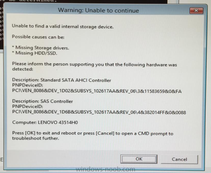

After implementing the new script in your boot image this is what you'll see when it detects missing storage drivers.
As you can see from the message it provides the following info
  • a reason for the popup (no storage detected)
  • lists the detected storage controller
  • lists the PNP Device ID
  • identifies the Computer model
and gives the user some options
  • click OK to reboot.
  • click CANCEL to open a CMD prompt if further troubleshooting is needed

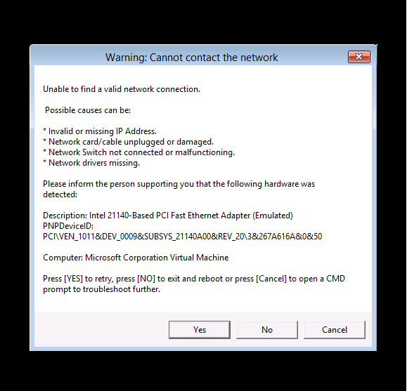

In addition to the above, it also checks for network (if and only if the storage check above passes), and in the event of a network connectivity failure you'll see this
which provides the following info
  • a reason for the popup (no network connectivity)
  • lists the detected Network Card
  • click YES to retry (for example if the network cable was not connected)
