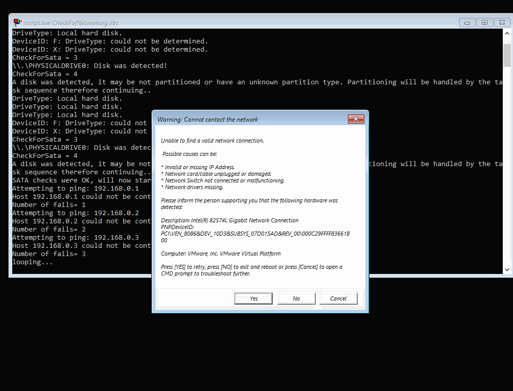

Updated Script: How can I check for network connectivity & storage before starting a task sequence in System Center 2012 R2 Configuration Manager ?
we are using it in a SCCM 1702 CB environment with 1703 adk boot wims. no problems
you have probably made a 'mistake' in the script editing, causing it to fail and reboot, you can test the scripts 'manually'  by creating standalone media (usb) and testing that way... over and over
Good to know. And good point. The only change I made was the edit of the IPs to check, but I probably got a little ambitious by replacing the IPs with a DNS hostname. I'll try swapping it out with the IP.
Thanks,
== Matt
Edit: Actually it looks like I messed up the wim injection. Disregard!
Edited by mmseng

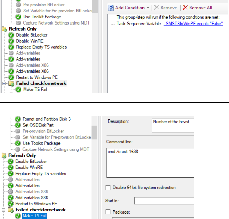

Fix for bootloops when a TS is initiated from Software Center and the script is detecting failures during the checks.

This will also cause the TS to continue in the full OS.
If you want to prevent that add something like this after the first reboot. (Since checkfornetwork.vbs shouldn't fail if it succeeded the first time)
