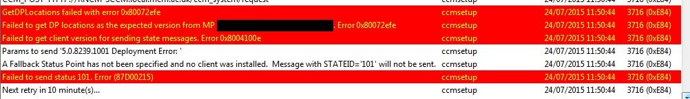

Attached is the error from ccmsetup

Do these lines suggest the request meets the MP or not?
