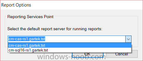

I install the second node without NLB and after i shutdown the first reporting node the reports didnt shown in the sccm consle???
But i can see the reports on the second node by browsing the HTTP://reporting2/reportserver
what is the issue ?
First off it is not recommend to run the report via the console. Running the report via the console add extra over head.
Secondly, if you have created two RP then they will automatically show up within the console. However you will first have to change over to the other RP.
