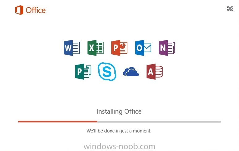

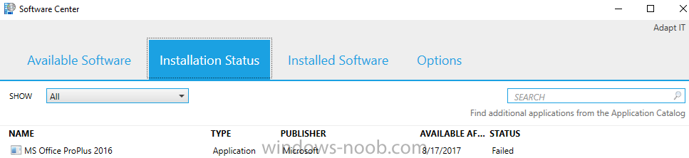

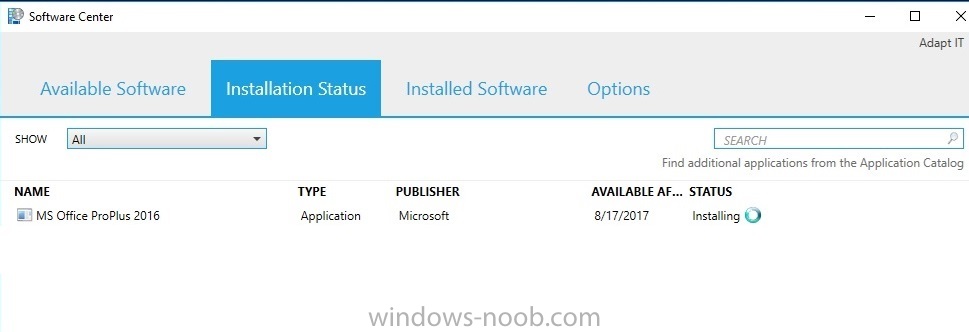

Hi, I am having a problem with my Office 365 ProPlus deployment on SCCM. If I deploy it via an application, it does deploy to the device and installs and there are no issues. However, if i look at my software center, it says that it failed. How can I get that failed to change as this will cause a problem with my users. Also, is it possible to have it install completely silently without the user seeing anything.

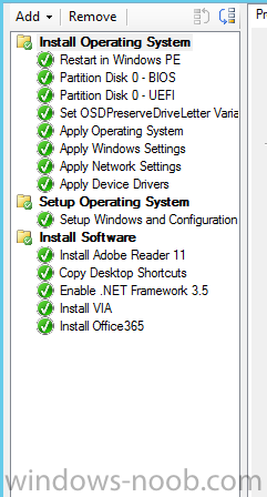

I then tried to add it my my Task Sequence, but it does not install. How can I get Office 365 to be included in my TS? My TS goes through fine and installs everything else fine except. Office

It looks like you're just missing the detection method, hence why it's installing but saying failed. Use the MSI code {90160000-008F-0000-1000-0000000FF1CE} as your detection method in SCCM and it should work fine.

Thank you Sir,
I've recreated my XML and changed the detection from registry to MSI code and the standard deployment works with no failed message. I am going to test it on my TS now and feedback later
I tried my TS but Office still did not apply. My TS just completed as normal and did not fail. When I logged in to my imaged machine however, Office was not deployed. any other ideas to get it to apply during my TS?
Can you possible provide a screen shot of your task sequence?  I have o365 working in a task sequence with other applications.
Do you see any thing in deployment logs to indicate the issue.
Hi, nothing strange in my logs. Is it possible that I need to change the order in my TS? Is your TS order something like this or is it different?
