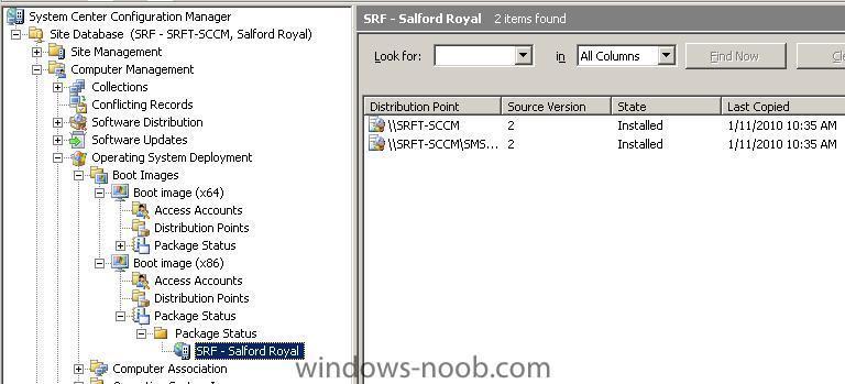

When the client pxe boots now, it says the following:
Downloaded WDSNBP...
Architecture: x64
Pending Request ID: 270
Contacting Server: 192.168.210.240
TFTP Download: smsboot\x64\pxeboot.com
Immediately after this it exits from the pxe boot and continues booting via HDD.
Thank you.
Just a quick message to say that I have finally got this working.
Thank you for your advice.
I now have another issue, although I suspect this is easier to resolve.
The task sequence bombs out with the following error:
It is not supported to deploy an x86 architecture OS from a amd64 boot image ApplyOperatingSystem 1/14/2010 11:03:59 AM 1432 (0x0598)
