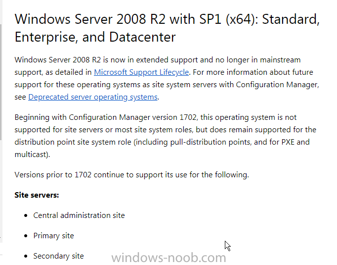

Once done with the upgrade to 1702, you can upgrade the Operating System of the server.
Thank You Admin,
But my Current Infra is running with Windows Server 2008 R2 along with SQL 2008 R2 as Single Standalone Primary Site with 20+ DP.
All Distribution Points are running with Windows Server 2008 R2 STD.
So, I believe the Upgrade Windows Server and SQL Server is needed to reach SCCM CBV1710 from SCCM 2012 SP2. However, We Preferred to retain the Version of Windows Server 2008 R2 STD for all Distribution Points
https://docs.microsoft.com/en-us/sccm/core/plan-design/configs/supported-operating-systems-for-site-system-servers
Please suggest..
