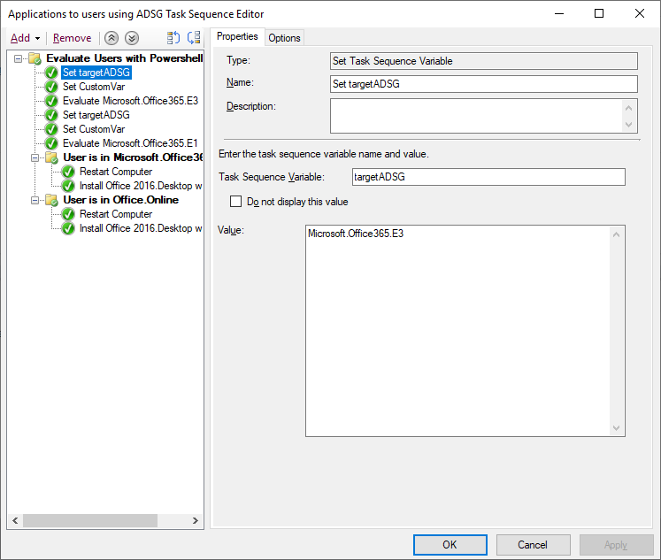

Step 1. Set TargetADSG
set the target Active Directory Security Group you want to test if the user is present in
step 2. Set a custom variable for that

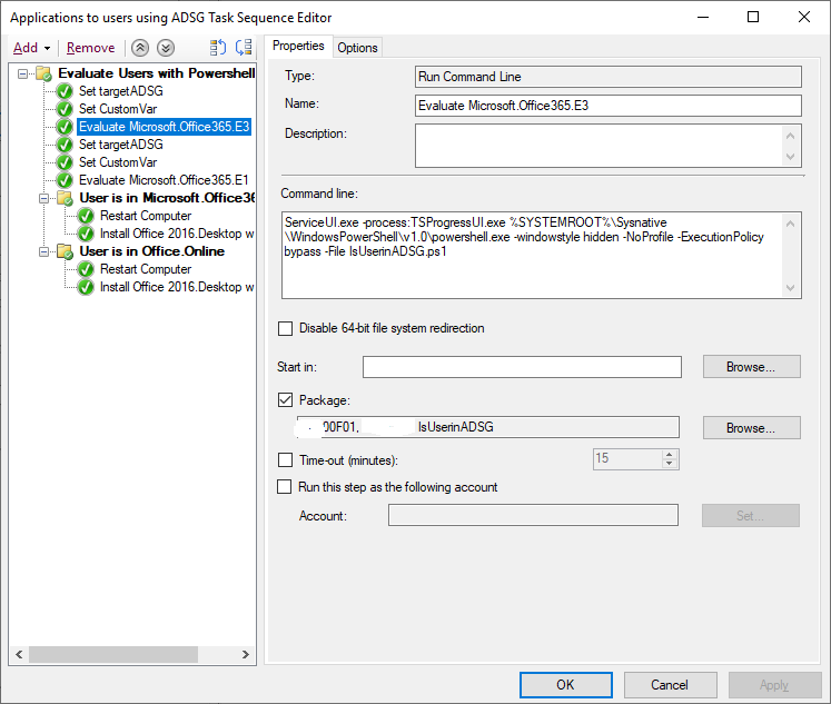

Step 3. call the powershell script
(uses ServiceUI.exe from the MDT Toolkit, use the correct architecture for the version of Windows you are deploying)
ServiceUI.exe -process:TSProgressUI.exe %SYSTEMROOT%\Sysnative\WindowsPowerShell\v1.0\powershell.exe -windowstyle hidden -NoProfile -ExecutionPolicy bypass -File IsUserinADSG.ps1

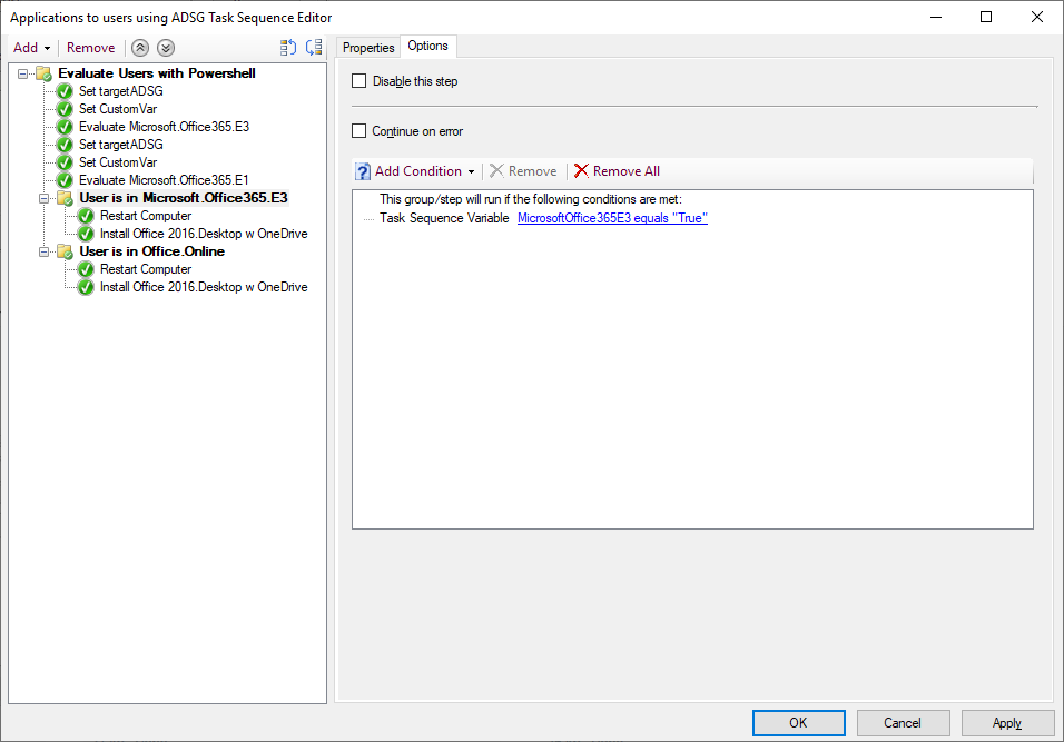

Step 4, Run the Group to install software if the CustomVar set earlier is true
