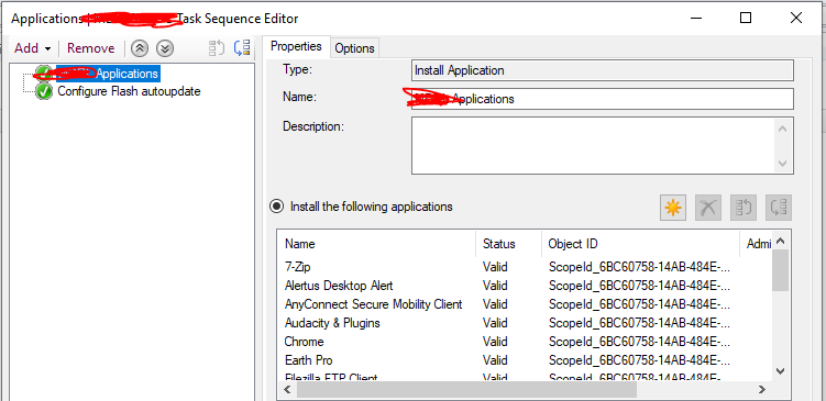

This statement doesn't make sense. The applications you are deploying using the install application step shouldn't be reliant on which collections the computer objects are in, unless you're doing something like this (Separate Task Sequence to deploy applications to a specific collection):
If you're deploying applications during OSD, you should have a step similar to this (Install application), that is not reliant upon which device collection the object is in.

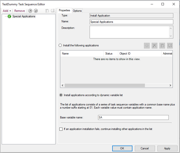

Thank you for your response. I should probably have explained this a little better. We have Device Collections for each faculty, each collection has a collection variable "SA" (Special App), 01, 02, 03 and so on. Each variable represents the name of an Application on SCCM. These collections query their membership based on Active Directory OU... so any new machines which aren't known on the network, can't be discovered in those collections.

You may have more success with that script, or not. One suggestion I might say try, is create a standalone application Task Sequence like this, and deploy the Task Sequence to your collection ("Academic...") as a required deployment. Image your systems, update your memberships manually (or fire off that PowerShell Script) after the systems are at the windows logon screen, and see if those collections reflect the new systems.
