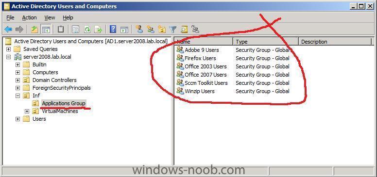

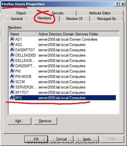

In the above Screenshot, the computer XP2 (amongst others) is a member of the FireFox Users Active Directory Security Group. Therefore if we run the Task Sequence (and thus the script) on that computer it will return a value of True for membership of the FireFox Users Active Directory Security Group and therefore the FireFox application will be installed during the Task Sequence dynamically.

  • You must have created some Active Directory Security Groups in AD for the applications you are intending to dynamically install and you should add the computer account to these groups, if the computer is not a member of the Active Directory Security Group then the software will not be installed via the task sequence.

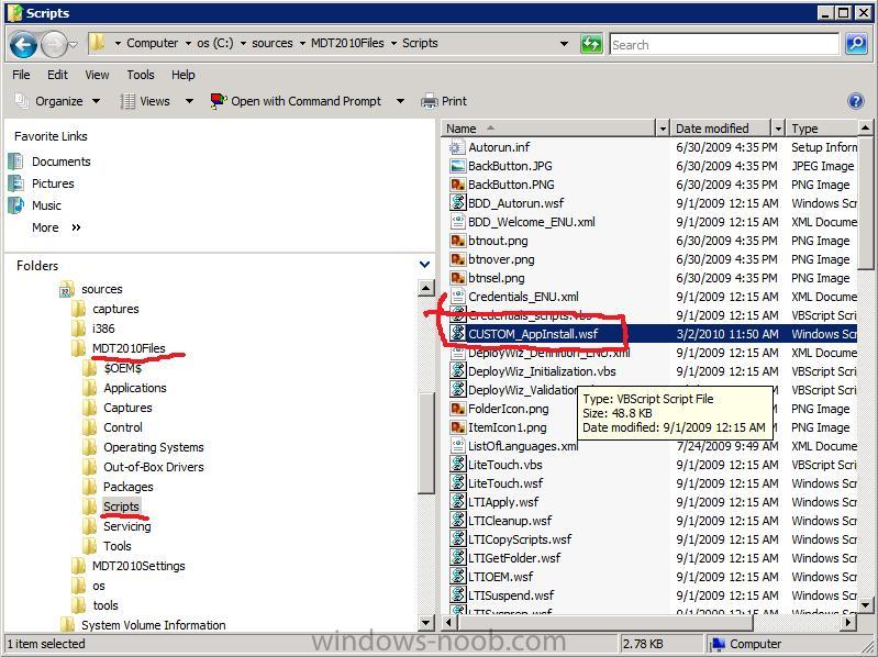

  • You will need MDT 2010 integrated with SCCM and you will need to add the custom script CUSTOM_AppInstall.wsf to the scripts folder contained within the MDT2010Files package.

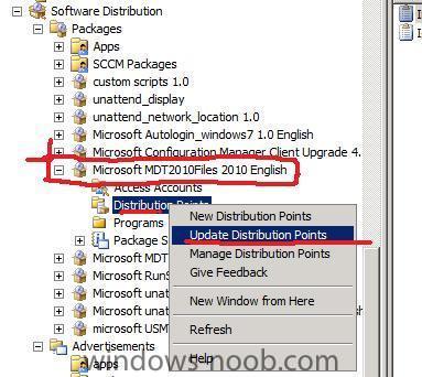

    Once you have added the file you must update the Distribution Points for that package.

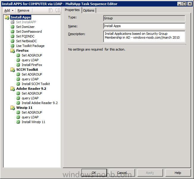

Ok let's go through the Task Sequence Step by Step. If you import the Task Sequence above you'll have all this work done for you and you'll just need to edit your application names/distinguished names/package/program location etc, but below is an explanation of how it all works and what it means.
Set DomUser

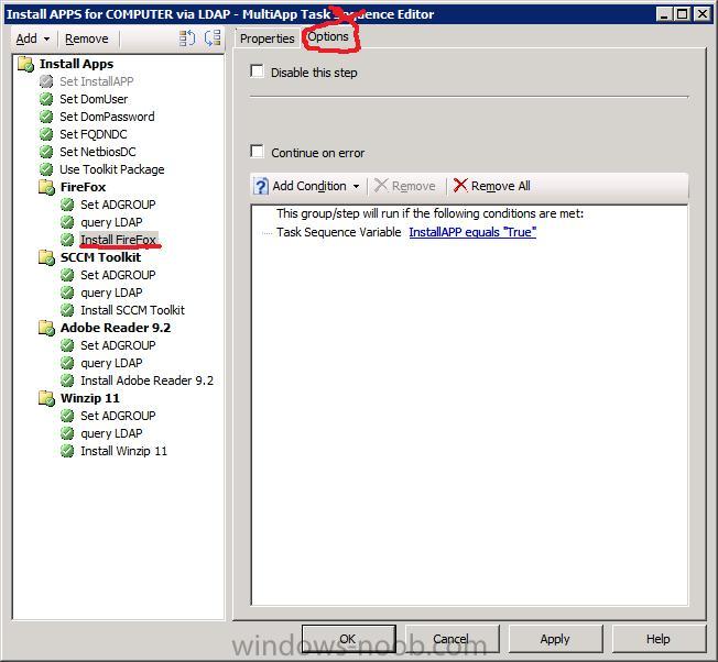

Install FireFox
This is a standard package installer step (Install a single application) which will point to your chosen application package and the program contained within. If no Program appears in the drop down menu then verify that the Program options below are set:
On the Environment tab of the program,
* Program can run: whether or not a user is logged on
* Run Mode: Allow users to interact with the program must be UNCHECKED (not selected).
On the Advanced tab of the program,
* select Allow this program to be installed from the Install Software task sequence without being advertised
Note: Click on the options tab and set it as follows, click on the Add condition drop down menu, select Task Sequence Variable, for Variable name enter InstallAPP for Value set True

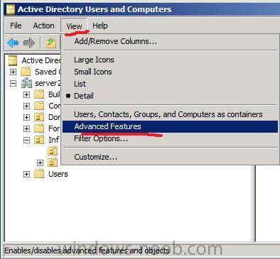

Getting the Distinguished Name info from AD
One of the big requirements of this task sequence is correctly identifying the Distinguished Names of your Active Directory User and the Active Directory Security Group. Our applications groups may look something like this in Active Directory Computers and Users.

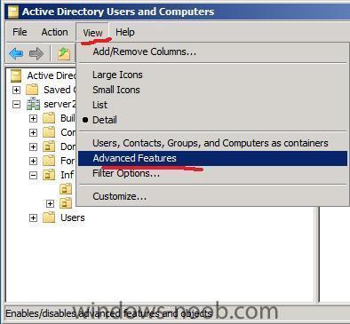

So how do we find that info, On your AD, open up Computers and Users. Click on the View option and enable Advanced Features.

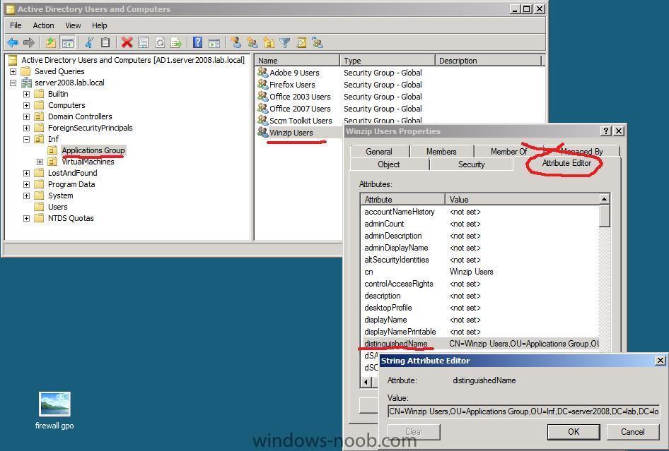

Now you can browse to the Applications respective Security Group and right click on it, in the example below we are looking at the Winzip AD Security Group. Double click on the group, choose the Attribute Editor tab and scroll down to Distinguished Name. The result is what we need for our task Sequence.

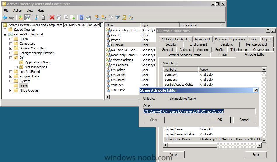

While you are at it, verify the Distinguished Name of your Active Directory QueryAD user.

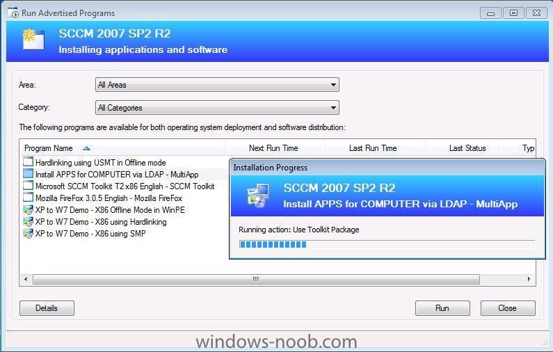

Start the Task Sequence via RAP
and verify that your applications install as part of the Task Sequence.

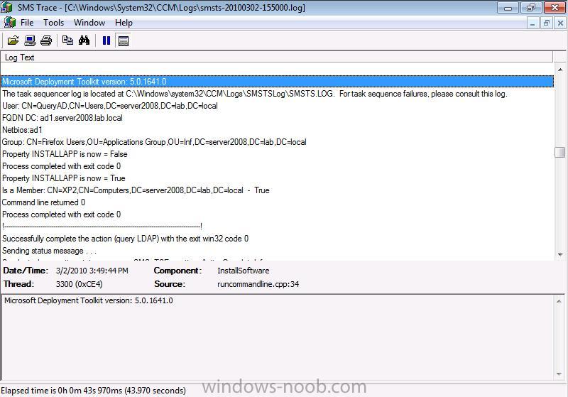

The Custom_AppInstall.wsf script contains some debugging lines which will write to your SMSTS.log file during the task sequence being deployed,
below is a sample where it has correctly found that a computer account is in an Active Directory Security Group and therefore sets the InstallApp variable to True.
and the following is an application install being skipped because the computer account was not found in AD and therefore InstallAPP was set to False.
