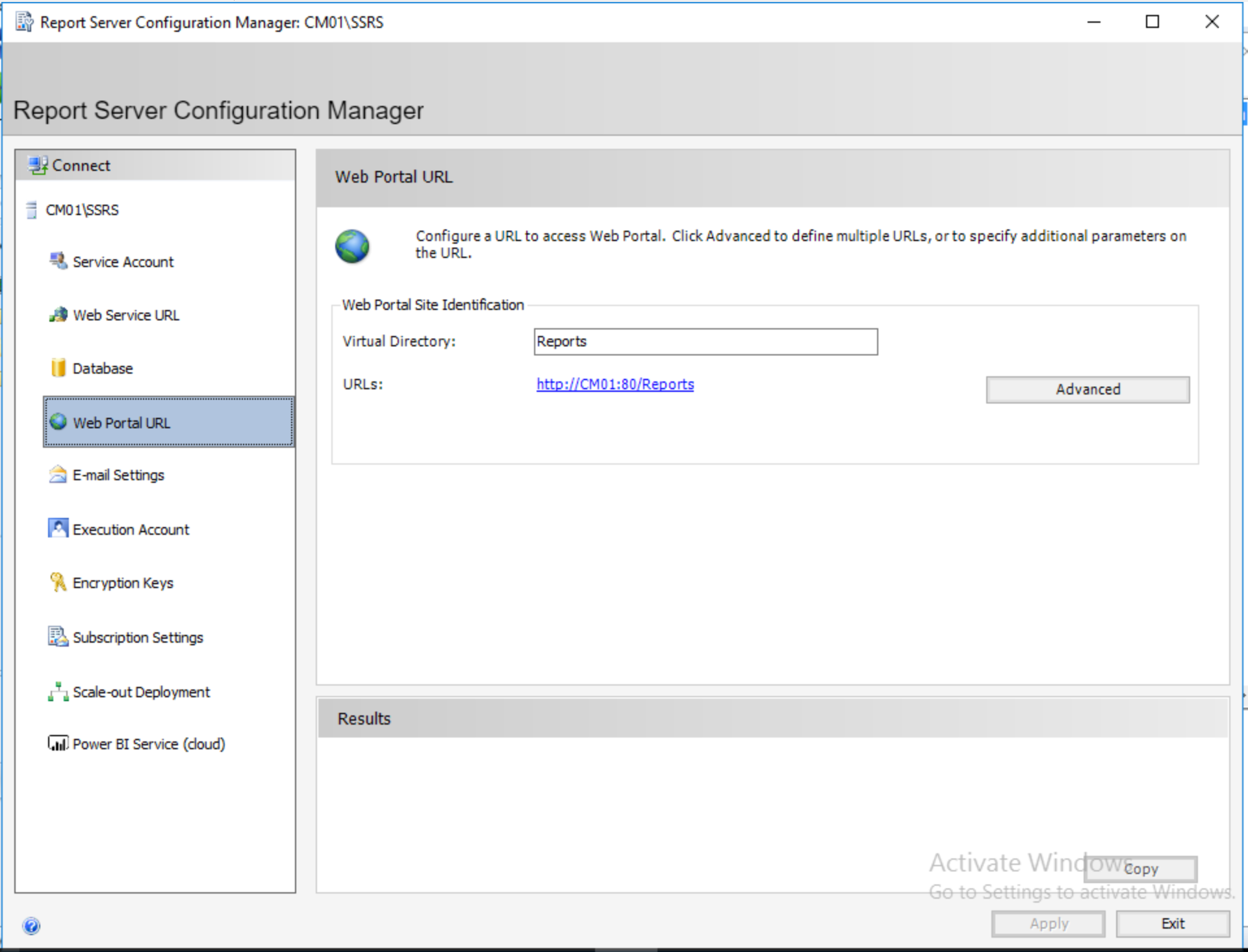

But I can’t get to the web interface for /Reports
in the start menu locate the SSRS Report Server Configuration Manager, and run it, you need to configure the Reports url in there and click apply.
