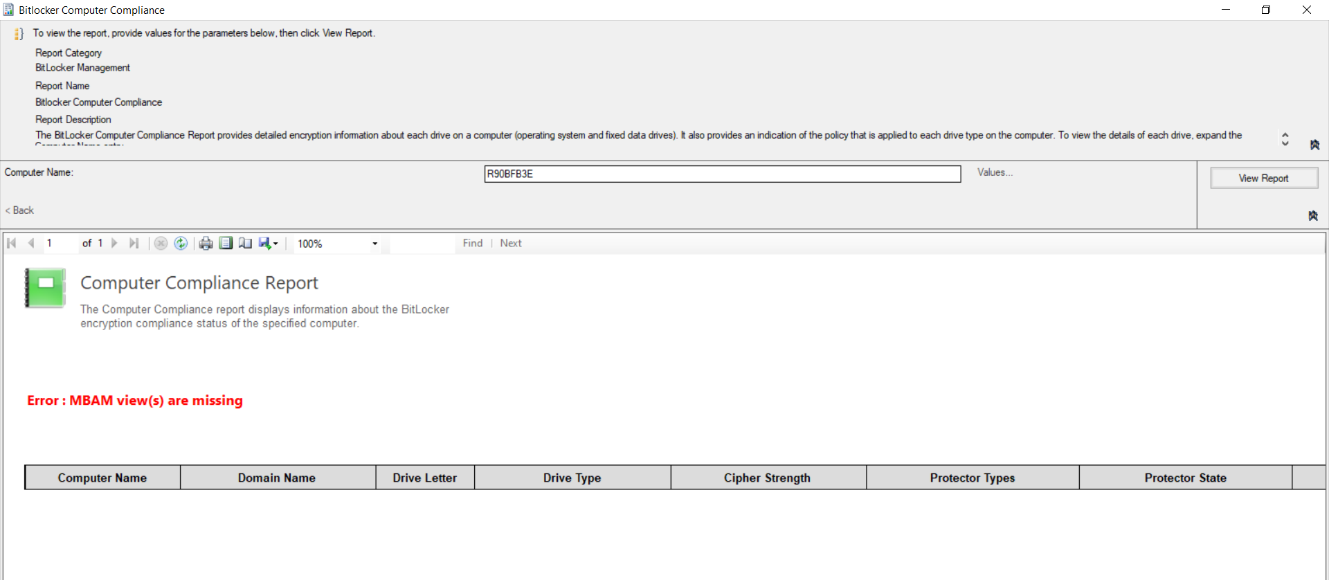

I have a question, I've got SQL reportigng services working okay I can run reports except for any of the Bitlocker ones.
I ge the below error message? MBAM seems to be working well, pops up on machines and also store recovery key in database however trying to work on a report that would all me to input a Pc number and it would return the recovery key number. However for that I need to get the reports working to start with.
Any ideas? I assume I've forgotten to do something!

what version of Configuration Manager are you using ?
ok that's odd, so are you getting errors on all the 5 bitlocker reports ?
do all other non-bitlocker reports render correctly for the same user ?
lastly, have you looked at this post to see does it give you any pointers
https://www.niallbrady.com/2019/11/12/a-quick-look-at-reporting-in-mbam-integrated-with-microsoft-endpoint-manager-configuration-manager/
I only have 4 bitlocker report avalible?
All other work fine.
Just followed steps on the the link and it still doesnt work.
One thing i did notice was i hadn't set the hardware inventory classes for bitlocker. I have no done this, i assume i need to wait for inventory to catch up for theview to be created perhaps?
Not sure if i need to make the MOF change or not.

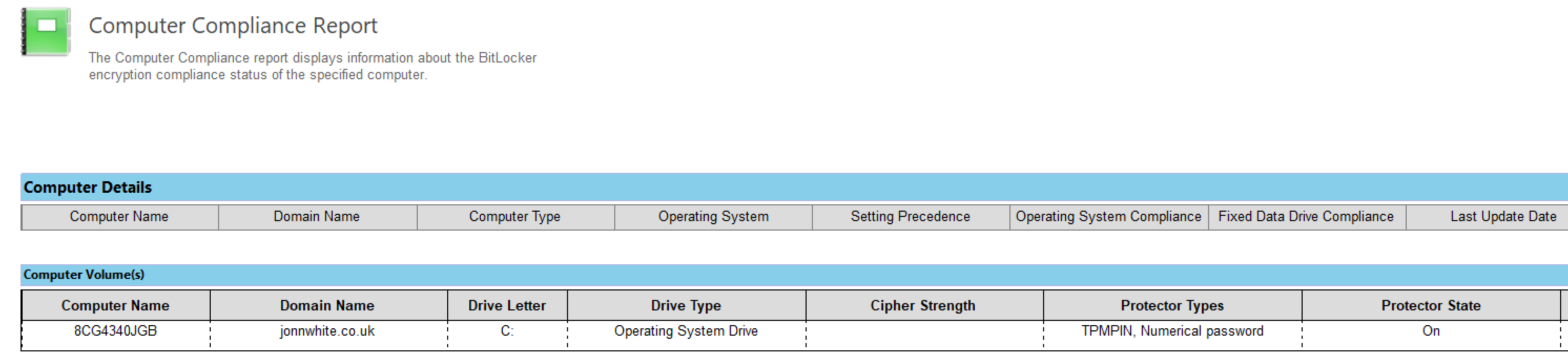

Scrap that, forced inventory and it now seems to be working!
good to hear it, the 5th report is the one in the language specific folder, eg: en-us. for auditing of recovery keys.
to confirm you only did a HINV cycle on the client and the error above vanished ? can you also confirm that you had the up to date 1910 client installed on the client or was that also part of your problem ?
