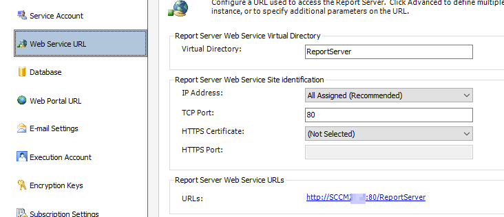

1) your Reporter Service should run, it means you have to access http://yourserver/Reporterserver or https://yourserver/Reporterserver
See here your SQL Reporter
2) Your Reporter Point service on the SCCM should have a user with sysadmin right on the SQL server
