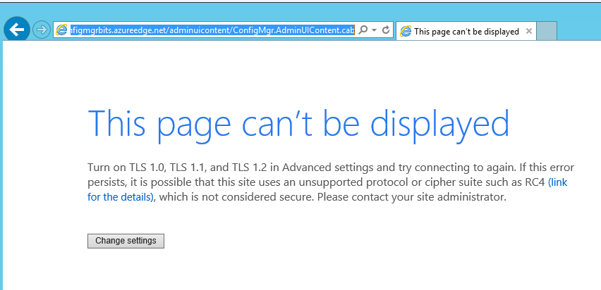

Kiran chandra B Posted October 10, 2021 Report post Posted October 10, 2021 Hi, We see Dmpdownloader.log failing as per below log , please check on this error and let me know what we can do to resolve it asap- Regards Kiran Quote Share this post Link to post Share on other sites More sharing options...
anyweb Posted October 11, 2021 Report post Posted October 11, 2021 what happens if you copy the url mentioned into your web browser on the same server, does it download correctly, yes/no Quote Share this post Link to post Share on other sites More sharing options...
Kiran chandra B Posted October 15, 2021 Report post Posted October 15, 2021 I see this error when i open the URL in web browser, should i turn on TLS1.0, 1.1 ,1.2 on CAS server and what is impact of doing tht on network and other things Quote Share this post Link to post Share on other sites More sharing options...
anyweb Posted October 15, 2021 Report post Posted October 15, 2021 why do you have a CAS ? how many clients are you supporting ? start reading this docs to determine how to resolve your TLS problem https://docs.microsoft.com/en-us/mem/configmgr/core/plan-design/security/enable-tls-1-2-server Quote Share this post Link to post Share on other sites More sharing options...
Kiran chandra B Posted October 17, 2021 Report post Posted October 17, 2021 We have 3 primary servers in different regions, so need CAS server , on checking doc to to resolve your TLS problem, I see below error when i open the URL in web browser, should i turn on TLS1.0, 1.1 ,1.2 on CAS server and what is impact of doing Turning on TLS 1.0,1.1,1.2 on SCCM servers, network and other things Quote Share this post Link to post Share on other sites More sharing options...
GarthMJ Posted October 17, 2021 Report post Posted October 17, 2021 On 10/17/2021 at 5:08 PM, Kiran chandra B said: We have 3 primary servers in different regions, so need CAS server , on checking doc to to resolve your TLS problem, I see below error when i open the URL in web browser, should i turn on TLS1.0, 1.1 ,1.2 on CAS server and what is impact of doing Turning on TLS 1.0,1.1,1.2 on SCCM servers, network and other things Expand Nothing, as that is the default to have TLS 1.2 enabled. But keep in mind that since you have a CAS and therefore over 150, 000 computers, you should be opening a support ticket with MS directly. As their might be a reason why TLS 1.2 was turned off. Quote Share this post Link to post Share on other sites More sharing options...
