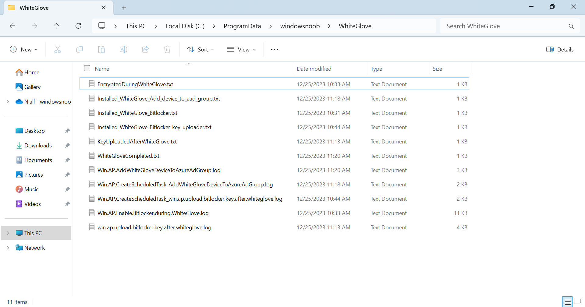

Troubleshooting
The Win32 app used in this part logs to C:\Windows\Temp\win.ap.enable.bitlocker.during.whiteglove.log
The contents of which are shown below from a working WhiteGlove deployment, please use this as a reference to compare your log file.
02/27/2023 04:33:46 Starting script: 'win.ap.enable.bitlocker.during.whiteglove' version: '0.11'...

02/27/2023 04:35:03 Current BL Status: C:, FullyEncrypted, XtsAes256,Tpm ExternalKey
02/27/2023 04:35:03 removing drive letter assigned to the SYSTEM partition now...
02/27/2023 04:35:04 The drive is fully encrypted now :-), we are exiting the script !
Once encryption during WhiteGlove is completed a reg key is created (and we look for that later)
