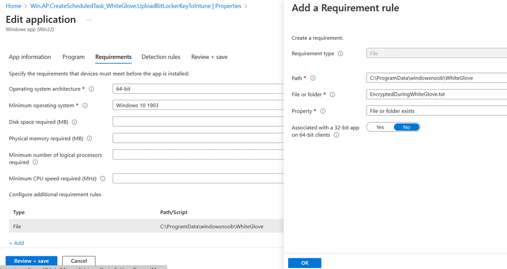

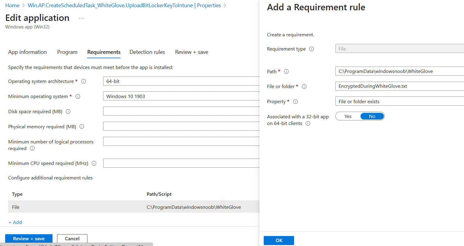

Requirements
Operating system architecture: x64
Minimum operating system Windows 10 1903
Registry: HKEY_LOCAL_MACHINE\SOFTWARE\WOW6432Node\windows-noob\WhiteGlove
as per the screenshot below:

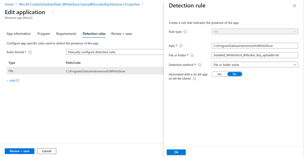

Detection rules
Rules format: Manually configure detection rules
Detection rules File: C:\Windows
File or folder: Installed_WhiteGlove_Bitlocker_key_uploader.txt
Detection method: File or folder exists
