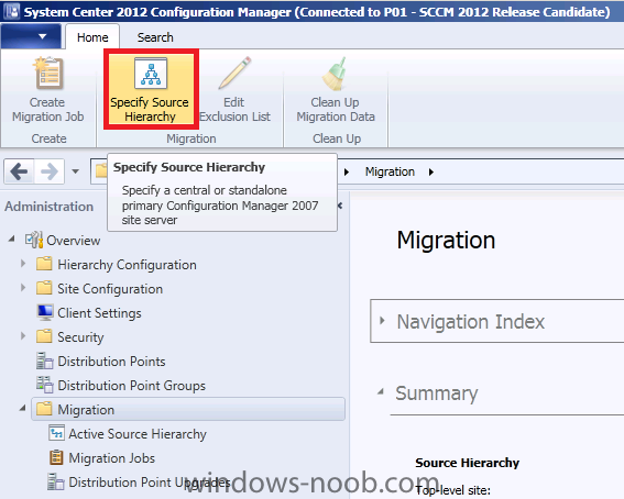

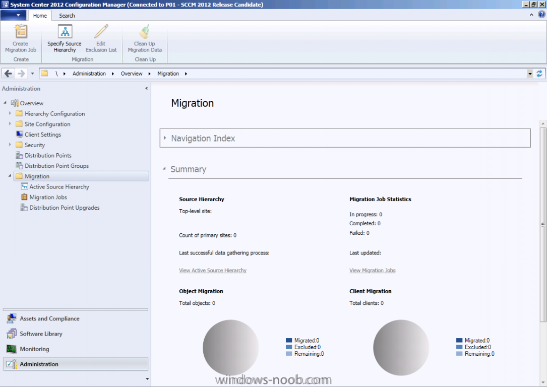

In the Administration workspace, expand Overview and select Migration, as we havn't migrated anything yet it's going to look pretty bland.

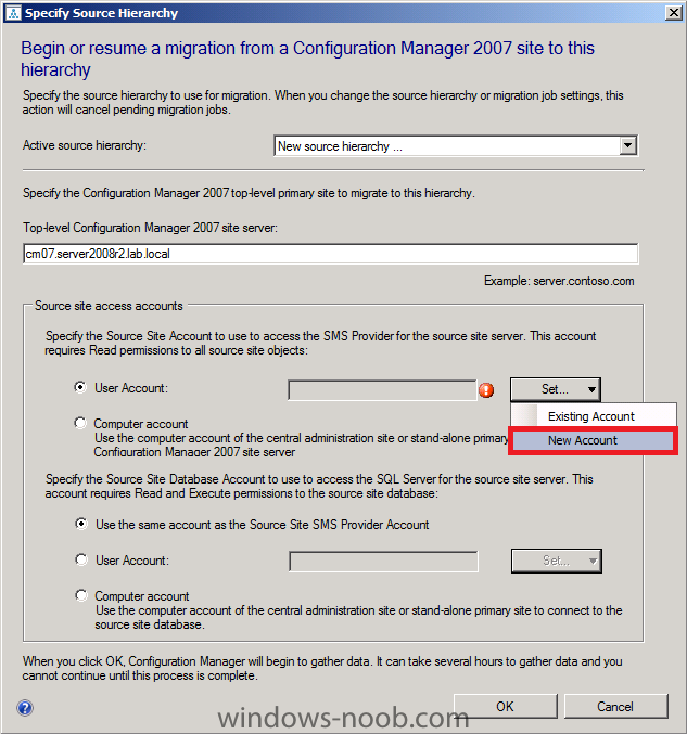

We need to specify the source hierarchy in order to establish a connection between the source (CM07) and destination (CM12) servers, so click on Specify Source Hierarchy in the ribbon.

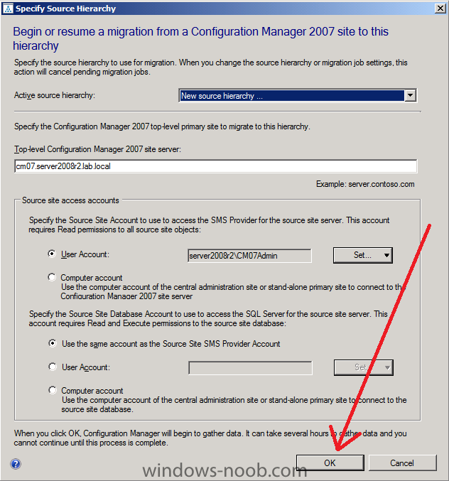

when the wizard appears we need to specify the Top-Level Configuration Manager 2007 site server. So fill in those details.

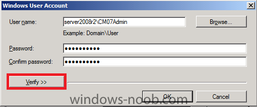

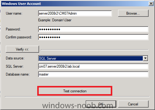

Next we need to specify the Source site account to use to access the SMS Provider for that site server. The account needs read permissions on all source site objects. In our LAB we will specify the CM07Admin account which was the same account used to install that site server. So click on the Set drop down menu and select New Account.
Input your account credentials and click on Verify
Click on Test connection
make sure you see a successful connection before proceeding.
We will use the same account as the source site SMS provider account, so click on OK to exit this wizard.

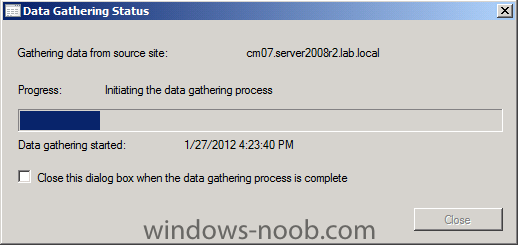

after clicking ok you'll see a window informing you that it is gathering data from the source site

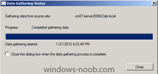

a few minutes later and it's done, close that window.

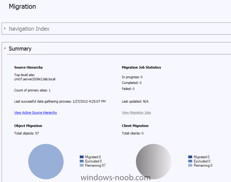

at this point we can now see that our migration summary window has populated with some information.

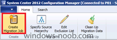

In the ribbon click on Create Migration Job

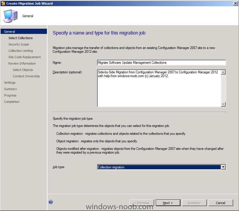

When the Migration Job wizard appears give it a name that is descriptive of what we are planning on migrating. Notice that in the drop down menu for Job Type we have three choices
  • Collection Migration
  • Object Migration
  • Objects modified after migration
In this case we are going to migrate collections, so we will name this migration job as follows:- Migrate Software Update Management Collections

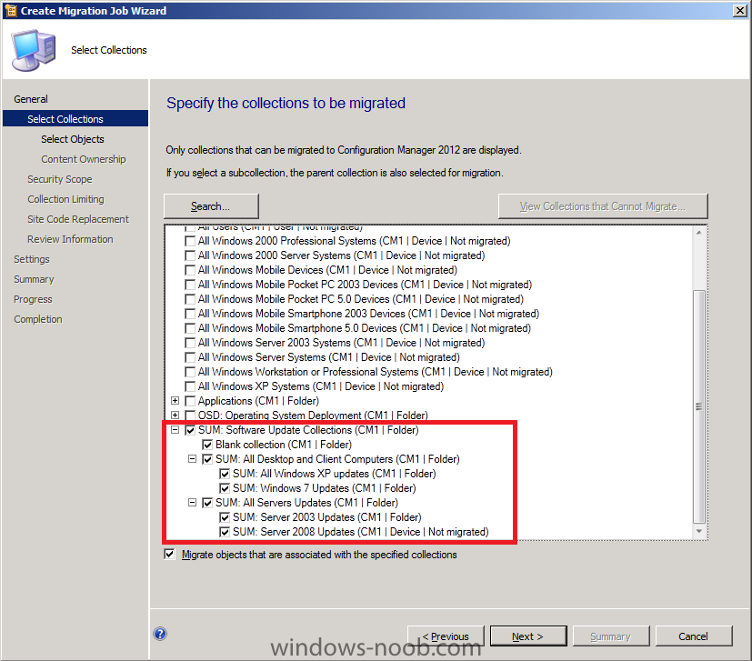

Click next and a list of collections that can be migrated to Configuration Manager 2012 are displayed. As we are only interested in migrating our Software Update collections, let's select them. If you have advertisements associated with these collections (Deployment Management Tasks) then they will be migrated also if you select Migrate objects that are associated with the specified collections.

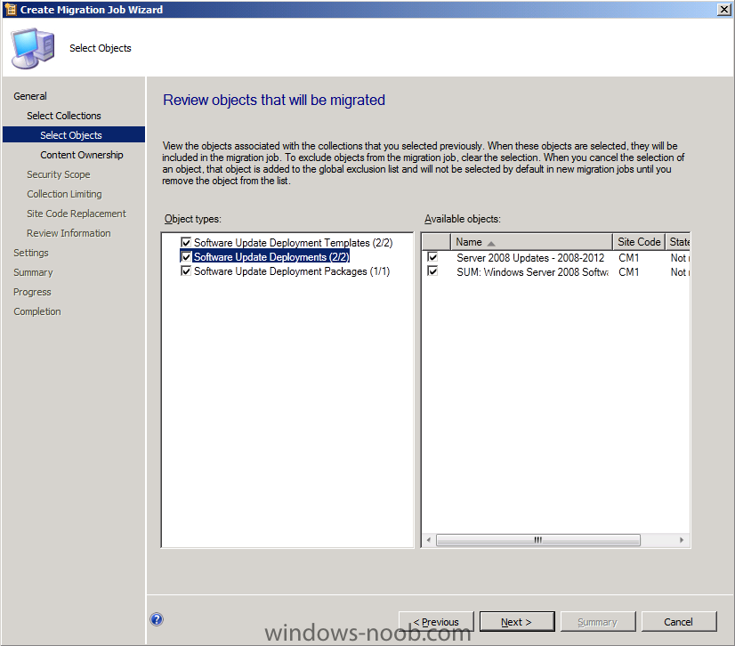

next we get to select objects that we want to migrate. Look through what is highlighted and decide if you really want to migrate it or not, this is a LAB so we'll let everything stay selected.

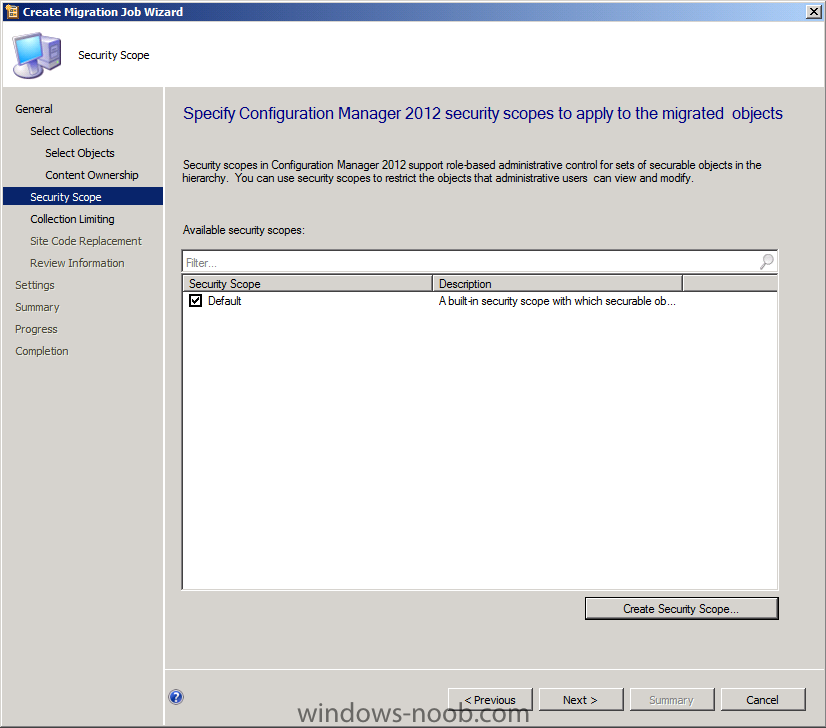

next you can specify the Security Scope to be applied to the migrated objects, select the Default option. (I will return to Security Scopes in a separate Part).

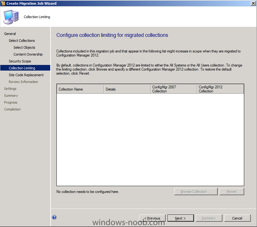

if any collections need to be limited to All Systems or All Users then they'll appear here, we are ok so lets proceed.

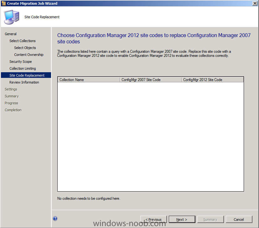

On the Site Code Replacement screen you may see collections that are based on Queries that are limited to Site codes, we don't have any in this LAB so nothing appears, but if you have any queries like this in your LAB then you'll see those collections listed here. What it's telling you is that you'll have to edit the queries to point to the new site code.

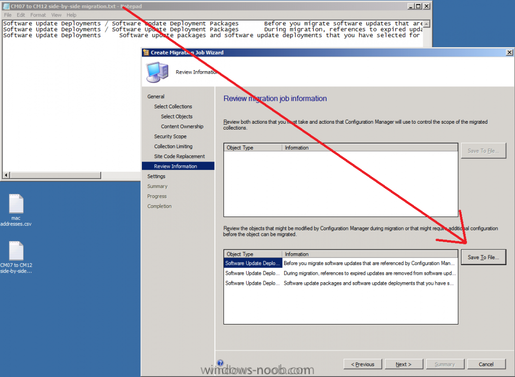

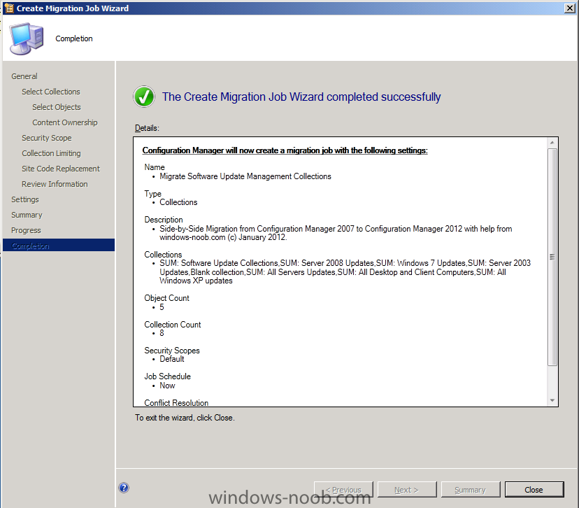

and now you get to review the information, you can save it to a file (recommended) which is a plain text file that lists things that you should be aware of. Save the file, read it. Action it.

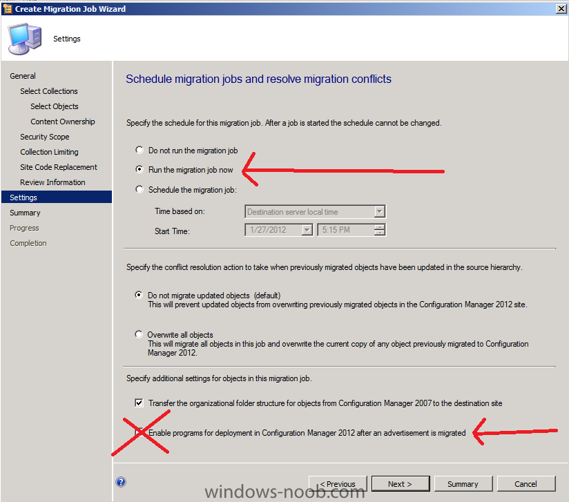

Next you can decide to run the migration job now (default) or schedule it until later. We want to migrate now so let's do that. Note that we don't want any new deployments being enabled after an advertisement is migrated so verify that setting is not selected (by default it is not selected). This will mean that you have to manually enable the deployments in Configuration Manager 2012, but that's ok isn't it.
click next at the summary and let the wizard do its work...then review the confirmation screen

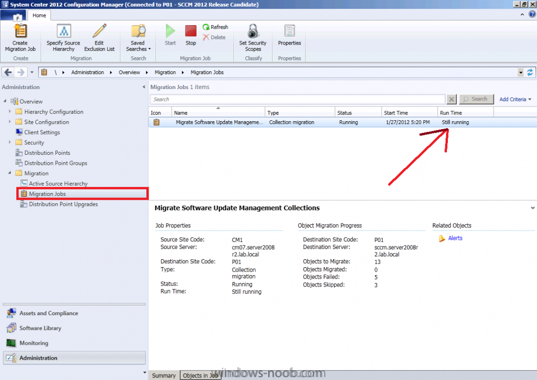

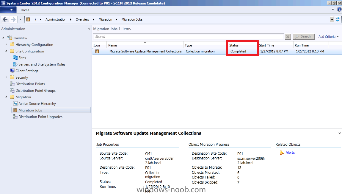

In the console click on Migration Jobs and you'll see the status of our newly created migration job, in the screenshot below it is still running.

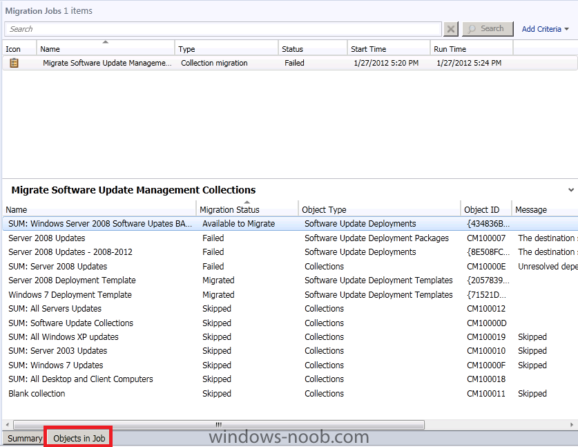

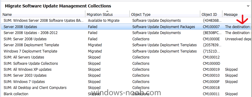

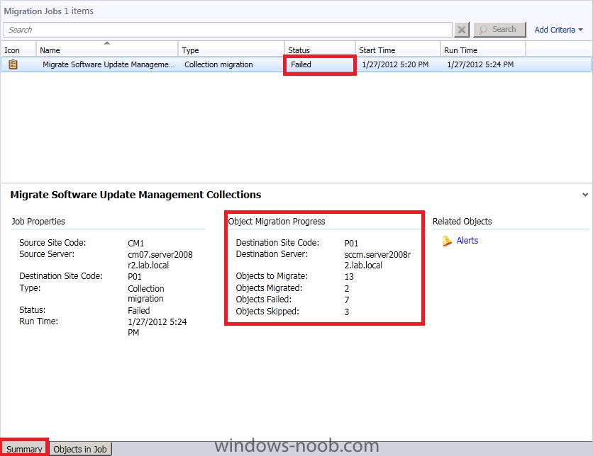

After a while it should complete, note that the status in our LAB says Failed. Before we find out why, let's review the information that the job shows us in the summary, in particular let's review the Object Migration Progress. We can see that it has migrated 2 objects, 7 failed and 3 were skipped.
Click on the Objects in Job tab to get specific information about the status of migration.
The objects that are skipped are empty collections (empty collections are NOT migrated). The failed objects are more interesting and you can select each object that has failed and read its corresponding message (by scrolling to the right) to find out what you need to do to fix it.
for example, the following message appears on one of the objects:-
  Quote

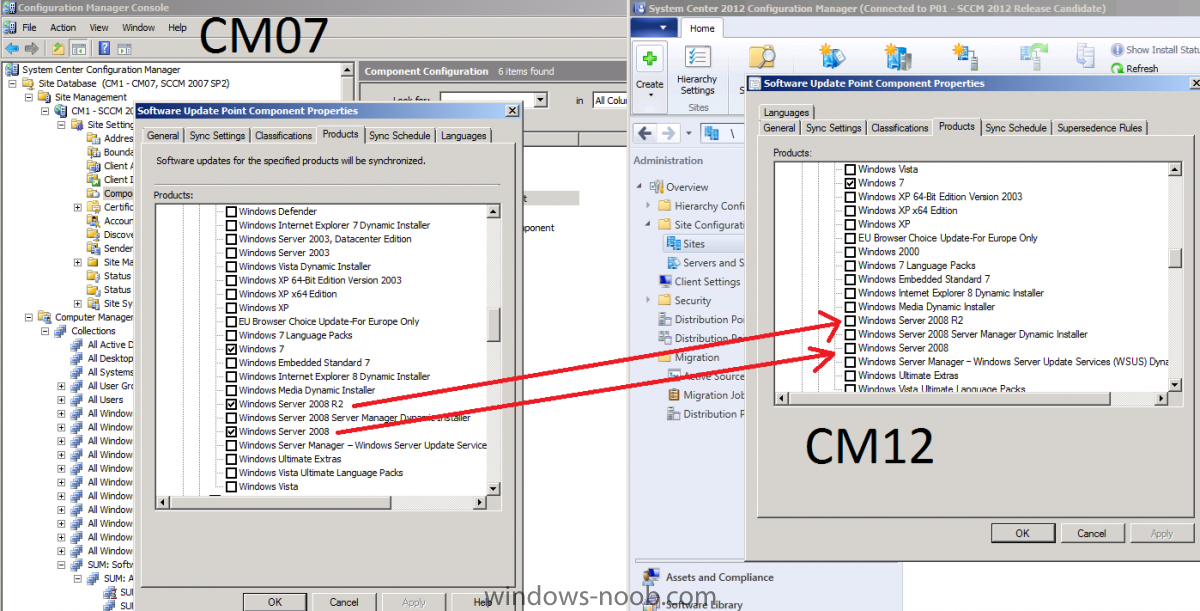

The destination site has not yet synchronized the software update with UniqueID 5f8a1117-.....required for migration of the software update package. Ensure the software update point has been configured and the software updates are synchronized at the destination site.
Great, now we know what's wrong and how to fix it.
The message in this example is telling us that the products synched are not matching on the destination (it doesn't understand how to deal with them) so let's verify how our Products are configured on both sites, CM07 on the left, CM12 on the right, see the difference ?
They should both be identical prior to running the Migration Job, this is an important lesson for you :-)
So correct the problem, do a Software update sync on CM12 and run your migration job again. Repeat this process for each failed message until all messages have been actioned upon. Note that you will most likely have to go and Gather Data again particularly if the logs/messages tell you to do so. But once you've resolved the problems your migration should complete as per the screenshot below.

Finally, you can review the Migration Summary screen to get an overview of your total Migration Progress (you'll need to create more migration jobs to get the other objects if you want them

Connection string = Data Source=EJWP115;Initial Catalog=SMS_EJZ;Integrated Security=True;Persist Security Info=False;MultipleActiveResultSets=True;Encrypt=True;TrustServerCertificate=True;Application Name="Migration Manager". SMS_MIGRATION_MANAGER 29/02/2012 8:08:10 2900 (0x0B54)
[MigrationManager]: Impersonation is reverted. SMS_MIGRATION_MANAGER 29/02/2012 8:08:26 2900 (0x0B54)
STATMSG: ID=8610 SEV=E LEV=M SOURCE="SMS Server" COMP="SMS_MIGRATION_MANAGER" SYS=SCCM2012SCSQL.ejsarea.net SITE=CAS PID=2024 TID=2900 GMTDATE=mié feb 29 07:08:26.681 2012 ISTR0="SCCM2012SCSQL.ejsarea.net (CAS)" ISTR1="ejwp115.ejsarea.net" ISTR2="-2146232060" ISTR3="" ISTR4="" ISTR5="" ISTR6="" ISTR7="" ISTR8="" ISTR9="" NUMATTRS=0 SMS_MIGRATION_MANAGER 29/02/2012 8:08:26 2900 (0x0B54)
[MigrationManager]: Set the schedule item 16777224 to Failed. SMS_MIGRATION_MANAGER 29/02/2012 8:08:26 2900 (0x0B54)
ERROR: [MigrationManager]: Error occurred when trying to make sql connection to EJWP115. Contact product support for help. Error Information -2146232060, Timeout expired. The timeout period elapsed prior to completion of the operation or the server is not responding. SMS_MIGRATION_MANAGER 29/02/2012 8:08:26 2900 (0x0B54)
ERROR: [MigrationManager]: Microsoft.ConfigurationManagement.Migration.MigrationException: Error occurred when trying to make sql connection to EJWP115. Contact product support for help. Error Information -2146232060, Timeout expired. The timeout period elapsed prior to completion of the operation or the server is not responding. ---> System.Data.SqlClient.SqlException: Timeout expired. The timeout period elapsed prior to completion of the operation or the server is not responding. at System.Data.SqlClient.SqlInternalConnection.OnError(SqlException exception, Boolean breakConnection) at System.Data.SqlClient.TdsParser.ThrowExceptionAndWarning(TdsParserStateObject stateObj) at System.Data.SqlClient.TdsParserStateObject.ReadSniError(TdsParserStateObject stateObj, UInt32 error) at System.Data.SqlClient.TdsParserStateObject.ReadSni(DbAsyncResult asyncResult, TdsParserStateObject stateObj) at System.Data.SqlClient.TdsParserStateObject.ReadNetworkPacket() at System.Data.SqlClient.TdsParser.ConsumePreLoginHandshake(Boolean encrypt, Boolean trustServerCert, Boolean& marsCapable) at System.Data.SqlClient.TdsParser.Connect(ServerInfo serverInfo, SqlInternalConnectionTds connHandler, Boolean ignoreSniOpenTimeout, Int64 timerExpire, Boolean encrypt, Boolean trustServerCert, Boolean integratedSecurity, SqlConnection owningObject) at System.Data.SqlClient.SqlInternalConnectionTds.AttemptOneLogin(ServerInfo serverInfo, String newPassword, Boolean ignoreSniOpenTimeout, Int64 timerExpire, SqlConnection owningObject) at System.Data.SqlClient.SqlInternalConnectionTds.LoginNoFailover(String host, String newPassword, Boolean redirectedUserInstance, SqlConnection owningObject, SqlConnectionString connectionOptions, Int64 timerStart) at System.Data.SqlClient.SqlInternalConnectionTds.OpenLoginEnlist(SqlConnection owningObject, SqlConnectionString connectionOptions, String newPassword, Boolean redirectedUserInstance) at System.Data.SqlClient.SqlInternalConnectionTds..ctor(DbConnectionPoolIdentity identity, SqlConnectionString connectionOptions, Object providerInfo, String newPassword, SqlConnection owningObject, Boolean redirectedUserInstance) at System.Data.SqlClient.SqlConnectionFactory.CreateConnection(DbConnectionOptions options, Object poolGroupProviderInfo, DbConnectionPool pool, DbConnection owningConnection) at System.Data.ProviderBase.DbConnectionFactory.CreatePooledConnection(DbConnection owningConnection, DbConnectionPool pool, DbConnectionOptions options) at System.Data.ProviderBase.DbConnectionPool.CreateObject(DbConnection owningObject) at System.Data.ProviderBase.DbConnectionPool.UserCreateRequest(DbConnection owningObject) at System.Data.ProviderBase.DbConnectionPool.GetConnection(DbConnection owningObject) at System.Data.ProviderBase.DbConnectionFactory.GetConnection(DbConnection owningConnection) at System.Data.ProviderBase.DbConnectionClosed.OpenConnection(DbConnection outerConnection, DbConnectionFactory connectionFactory) at System.Data.SqlClient.SqlConnection.Open() at Microsoft.ConfigurationManager.ManagedBase.SqlConnectionBuilder.GetSqlConnection(String sqlServerName, String sqlInstanceAndDatabaseName, String applicationName, SqlConnectionSecurityLevel securityLevel) at Microsoft.ConfigurationManagement.MigrationManager.ConnectionBuilder.BuildSqlConnection(Dictionary`2 context) --- End of inner exception stack trace --- at Microsoft.ConfigurationManagement.MigrationManager.ConnectionBuilder.BuildSqlConnection(Dictionary`2 context) at Microsoft.ConfigurationManagement.MigrationManager.JobManagerBase`1.<get_ConnectionFactory>b__0(Dictionary`2 n) at Microsoft.ConfigurationManagement.MigrationManager.ObjectFactory.<>c__DisplayClass1`1.<Register>b__0(Dictionary`2 n) at Microsoft.ConfigurationManagement.MigrationManager.ObjectFactory.TryCreate[T](Dictionary`2 context) at Microsoft.ConfigurationManagement.MigrationManager.JobManagerBase`1.ConnectToLegacySite(IMigrationSiteInfo siteInfo) at Microsoft.ConfigurationManagement.MigrationManager.SyncAgentJobManager.CreateJob(MigrationRepository repository, MIG_SiteMapping scheduleItem) at Microsoft.ConfigurationManagement.MigrationManager.JobManagerBase`1.GetNextJob(Int32& sleepMilliseconds) SMS_MIGRATION_MANAGER 29/02/2012 8:08:26 2900 (0x0B54)
[MigrationManager]: Start two step scheduling for MIG_SiteMapping SMS_MIGRATION_MANAGER 29/02/2012 8:08:26 2900 (0x0B54)
[MigrationManager]: Step 1. Query the schedule items that was running or requested to start immediately ... SMS_MIGRATION_MANAGER 29/02/2012 8:08:26 2900 (0x0B54)
[MigrationManager]: Step 2. Query the first item in order of DateNextRun ... SMS_MIGRATION_MANAGER 29/02/2012 8:08:26 2900 (0x0B54)
[MigrationManager]: The item MIG_SiteMapping 16777224 is scheduled to run at 02/29/2012 11:07:38 UTC, 02/29/2012 12:07:38 Local Time, sleep for 03:59:11.8270000. SMS_MIGRATION_MANAGER 29/02/2012 8:08:26 2900 (0x0B54)
[MigrationManager]: End two step scheduling for MIG_SiteMapping SMS_MIGRATION_MANAGER 29/02/2012 8:08:26 2900 (0x0B54)
Connection string = Data Source=(local);Initial Catalog=CM_CAS;Integrated Security=True;Persist Security Info=False;MultipleActiveResultSets=True;Encrypt=True;TrustServerCertificate=False;Application Name="Migration Manager". SMS_MIGRATION_MANAGER 29/02/2012 8:08:26 2900 (0x0B54)
Created new sqlConnection to (local) SMS_MIGRATION_MANAGER 29/02/2012 8:08:26 2900 (0x0B54)
[MigrationManager]: Start two step scheduling for MIG_Job SMS_MIGRATION_MANAGER 29/02/2012 8:08:26 2900 (0x0B54)
[MigrationManager]: No item found. Sleep until the next event. SMS_MIGRATION_MANAGER 29/02/2012 8:08:26 2900 (0x0B54)
[MigrationManager]: End two step scheduling for MIG_Job SMS_MIGRATION_MANAGER 29/02/2012 8:08:26 2900 (0x0B54)
[MigMCtrl]: the workitem queue is full! SMS_MIGRATION_MANAGER 29/02/2012 8:08:26 2900 (0x0B54)
[MigMCtrl]: WAIT 3 event(s) for 60 minute(s) and 0 second(s). SMS_MIGRATION_MANAGER 29/02/2012 8:08:26 2900 (0x0B54)
The error says something about a timeout period expires. I have test the connection from the CAS server to the SCCM 2007 server and is OK and this error appears after 1 minuto more or less (so it cannot be a timeout error). Could anyone give any ideas?
Thanks a lot!
