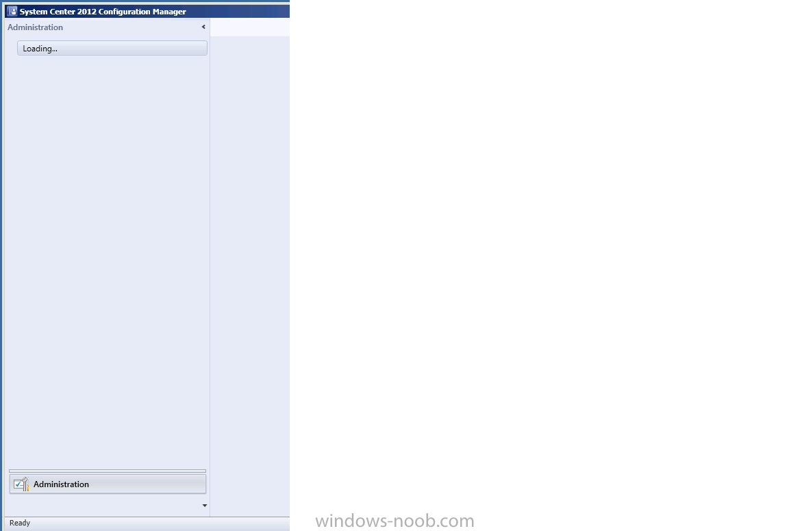

Attached is a screen shot of the error message
I get the option of selecting my default site (sccm2012-sccm.kg.sccmtest) or of submitting a new connection in FQDN format
But this does not connect either

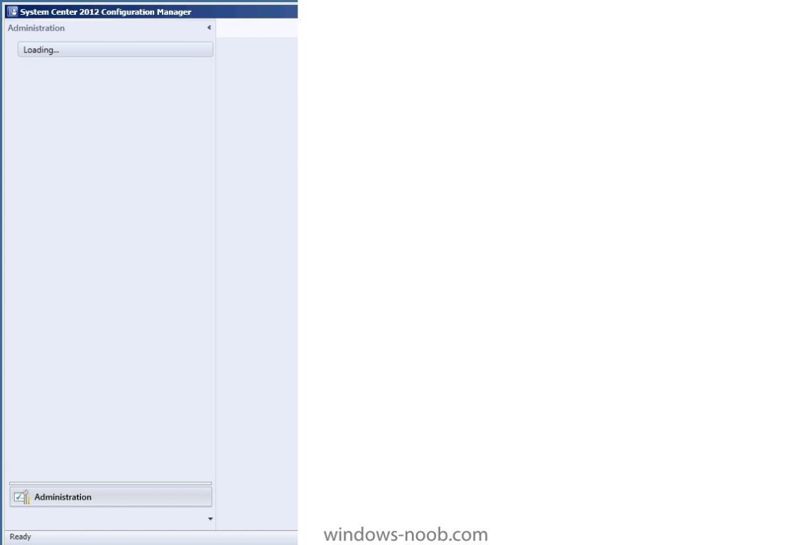

Was able to snag this screen shot before the no access popup:
