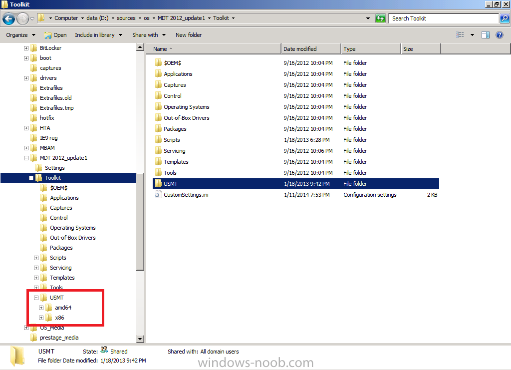

Yeah, that would be cool. I did have a quick look though, and it looks like imagex is not recommended for this sort of thing - http://support.microsoft.com/kb/935467/en-gb What are your thoughts on that?
Could you also please give me your thoughts on the partition stuff in my earlier post too please, as it would help me understand things a lot more.
One last thing, I'm now having issues with a step in the HTA:
xcopy X86 USMT to USMTbits\X86
Looks like the source location doesn't exist - does this mean I haven't installed the USMT package to the machine? Can you also please clarify why one step uses x86 USMT and another further along uses x64?
Cheers.
Keeop
i've backed up and restored Windows XP,7 and Windows 8 just fine with imagex, i'd suggest you test it yourself and come to your own conclusions as to it's effectiveness.
it's copied from the MDT Toolkit package (which you've populated with the USMT folders on page one of this guide) by the task sequence
so your toolkit package source looks like this and the usmt x86 (and x64..) sub folders are within the USMT dir..
