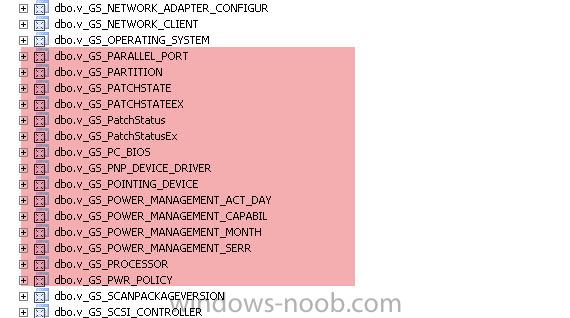

Thanks Garth! I had a look in there. Don't seem to see it. I see dbo.v_GS_Parallel_Port to PWR_Policy but no PRINTERINV.

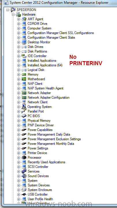

I was also under the assumption that I would be able to see the pulled information per device under the Resource Explorer from the CCM console. However, no luck. I am terrible with SQL but my next step was to build a report then then push the above mentioned VBS/INI scripts to more computers; once I verified it is working.
