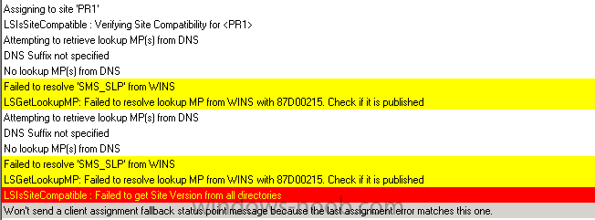

Niall, you have saved me! Your documentation spelled out exactly what I was missing - entries in my LMHOSTS file! Once I made the entries, I just had to find an installation command line that worked for our environment. In my case, I had already copied the CCMsetup installation source files over to the workgroup machine and used the following syntax: ccmsetup.exe /mp:{Our MP Server in the DMZ FQDN} SMSSITECODE={Our SMS Site Code} FSP={Our Primary Site Server} After installation, I went into Devices in SCCM Admin Console and voila! Found the Workgroup server in Unapproved state, right-clicked, chose Approve, YES! Thank you so very, very much! -

Hi All, I am trying to get SCCM client to install and talk to servers that are Workgroup (non-domain joined) and sitting in a DMZ, i.e. outside our regular domain. We have a MP installed in the DMZ that is intended to communicate with devices in the DMZ, domain-joined or not. The DMZ domain-joined machines SCCM clients work fine, its the DMZ workgroup machines that don't. I am installing SCCM client with syntax like: ccmsetup.exe /mp:{MPserver for DMZ FQDN} SMSSITECODE={our site code} FSP={MP for our regular domain} * I have added the IP and hostname of our MP DMZ server into our Hosts file, so the workgroup machine can resolve the hostname of the MP. * Our networks team has confirmed that there are no ports or firewalling blocking communication between the DMZ workgroup machines and our SCCM infrastructure. * We have used our Active Directory Certification Services to install a Personal certificate to allow communicate between the host machine and our SCOM infrastructure. SCOM talks to these machines without issue, but SCCM is not. The repeating errors in LocationServices.log of our DMZ Workgroup machines are as follows: Any tips on troubleshooting?

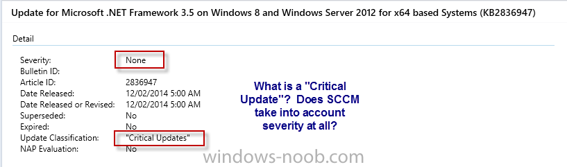

dverbern posted a question in Software Update Point
Hello, Using SCCM 2012 with a Software Update Point. Can someone advise how SCCM determines the "Update Classification" for each update it pulls down from Internet? I ask because many updates being downloaded in our environment are being put in the Update Classification of "Critical Updates", yet the "Severity" of the updates are set to "None". I've been asked to account for which is the case - are these updates truly "Critical" or this a product of how our environment is set up? I attach an example update and a look at our update classification settings. -

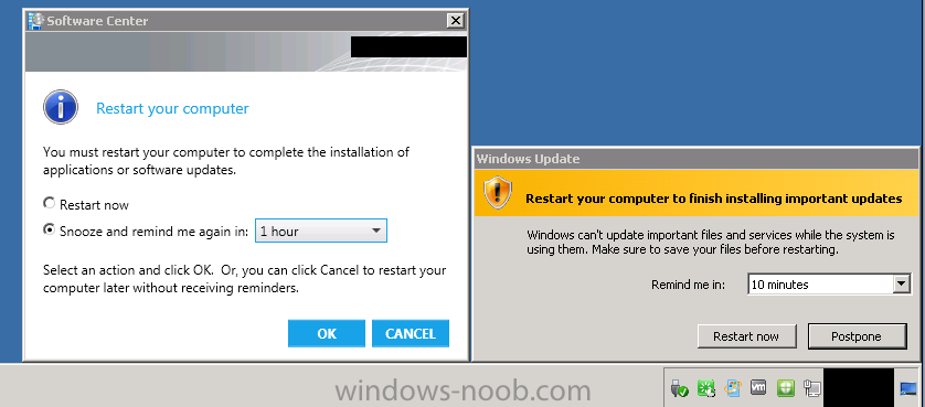

Hi All, We are using SCCM 2012 to manage our fleet of workstations and servers. We are using SCCM to manage operating system updates as well. Most of our servers obediently follow instruction by SCCM to install updates when they are supposed to. However, a small number seem to have two sets of update components - Windows Update and SCCM's Updates. If anyone has seen this before, I'd be appreciative to know whether there is a routine we can run to remove any Windows Updates components that are not required, so that it is purely SCCM managing the updates process. Here is an example screenshot showing a server with the two components seemingly on at the same time, prompting for a restart: (Server 2008 R2 in this case)
