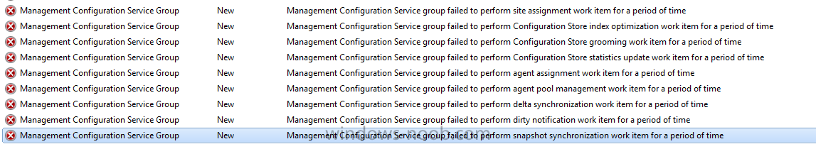

Hi there, I have a fairly new SCOM install up at the moment. It consists of: 2 Management Servers 2 Gateway servers on other domains using certificates 1 SQL Server with two instances, one for OperationsDB and one for WarehouseDB. Ever since I installed it a couple of weeks ago, I get the following error every now and then, and it can last for up to 2 days at a time: OpsMgr Management Configuration Service failed to execute 'SnapshotSynchronization' engine work item due to the following exception Microsoft.EnterpriseManagement.ManagementConfiguration.DataAccessLayer.DataAccessOperationTimeoutException: Exception of type 'Microsoft.EnterpriseManagement.ManagementConfiguration.DataAccessLayer.DataAccessOperationTimeoutException' was thrown. at Microsoft.EnterpriseManagement.ManagementConfiguration.DataAccessLayer.DataAccessOperation.ExecuteSynchronously(Int32 timeoutSeconds, WaitHandle stopWaitHandle) at Microsoft.EnterpriseManagement.ManagementConfiguration.CmdbOperations.CmdbDataProvider.GetConfigurationSnapshotNextBatch(SnapshotProcessWatermark watermark) at Microsoft.EnterpriseManagement.ManagementConfiguration.Engine.TracingConfigurationDataProvider.GetConfigurationSnapshotNextBatch(SnapshotProcessWatermark watermark) at Microsoft.EnterpriseManagement.ManagementConfiguration.Engine.SnapshotSynchronizationWorkItem.TransferData(SnapshotProcessWatermark initialWatermark) at Microsoft.EnterpriseManagement.ManagementConfiguration.Engine.SnapshotSynchronizationWorkItem.ExecuteSharedWorkItem() at Microsoft.EnterpriseManagement.ManagementConfiguration.Interop.SharedWorkItem.ExecuteWorkItem() at Microsoft.EnterpriseManagement.ManagementConfiguration.Interop.ConfigServiceEngineWorkItem.Execute() Now when this is happening, I also get a whole bunch of others: Once the original error above clears, the others also resolve, so I'm only interested in said error I'm assuming. I have been running the following query on the OperationsDB on SQL: Select WorkItemName, b.WorkItemStateName, ServerName, StartedDateTimeUtc, CompletedDateTimeUtc, DurationSeconds, ERRORMESSAGE from cs.WorkItem a , cs.WorkItemState b where a.WorkItemStateId= b.WorkItemStateId and WorkItemName = 'SnapshotSynchronization' Which returns the following: On one which was succeeded, the day before, the time shows 302. I have increased the timeouts on the config files on both Management servers and restarted the services (even the servers themselves), but still nothing helps. Pulling my hair out with this a bit! All machines are Windows Server 2012R2. We do run them on VMWare with DRS enabled, but they haven't migrated for some time, so it's not a host/network thing as far as I can see. OpsMgr is running as normal mostly, still monitoring things and reporting, but I cannot add new objects to monitor until this clears. The Management Servers and others also show this in the even log: "OpsMgr's configuration may be out-of-date for management group <Management Group>, and has requested updated configuration from the Configuration Service.", but I don't see successful update of the cookie until this issue resolves itself. Any help is much appreciated! Cheers Phil

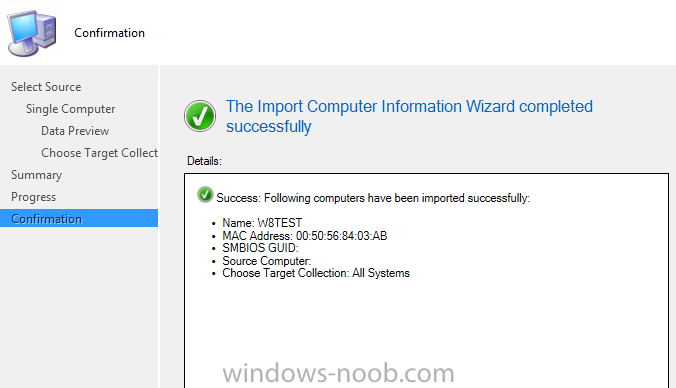

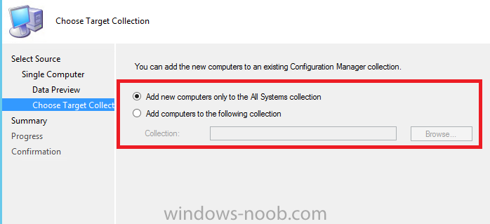

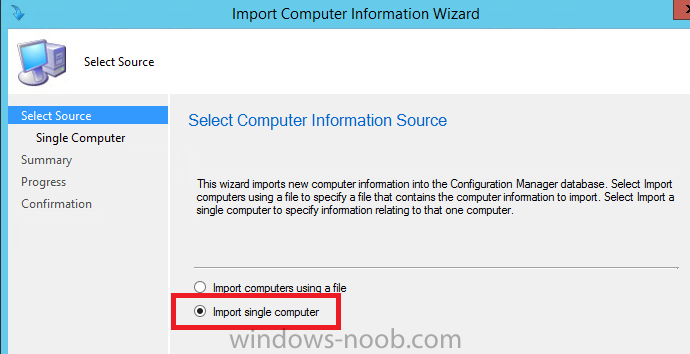

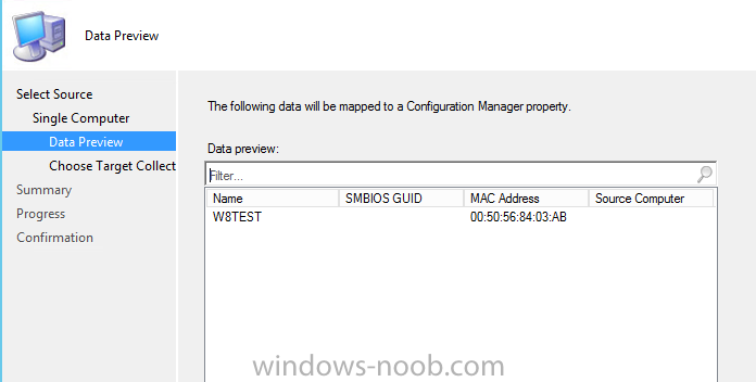

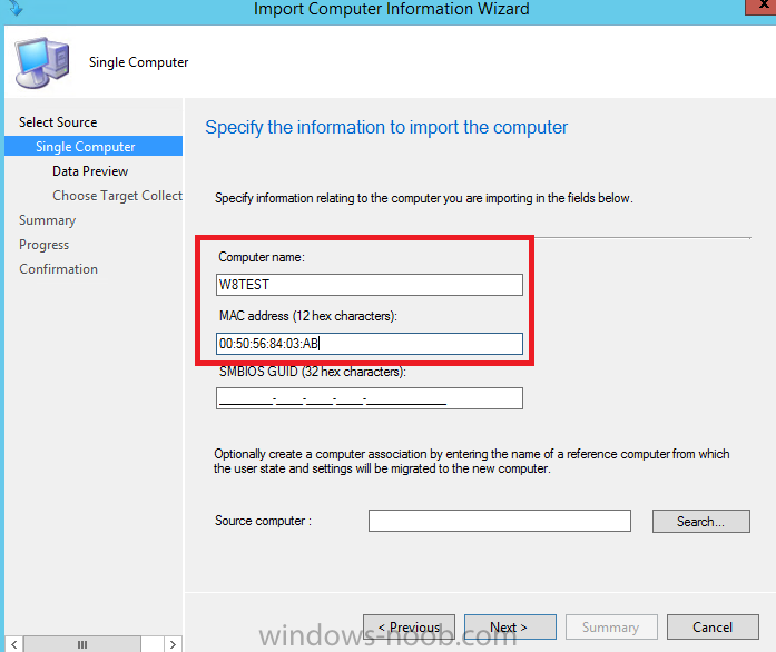

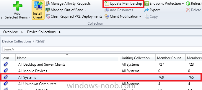

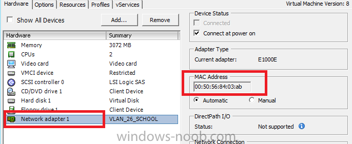

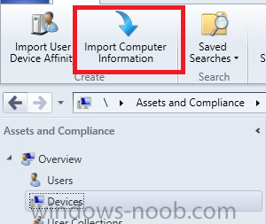

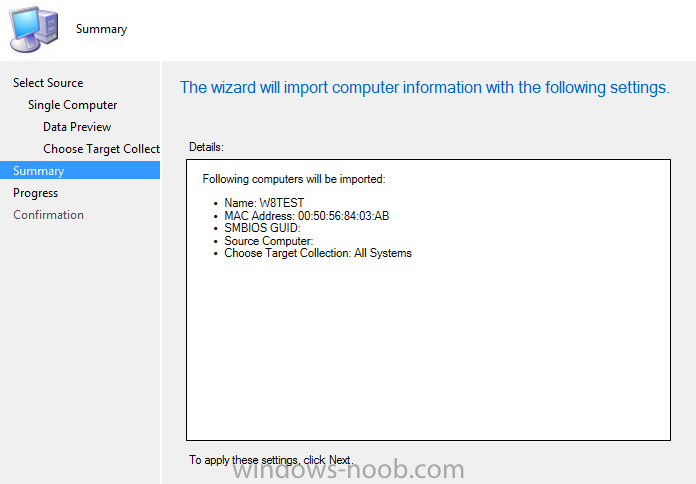

Okay, I will describe how to add a PC via mac address for OSD first: On VMWare, right click on the machine in question, choose "Edit Settings". In the "Hardware" tab, choose the network adapter. On the right hand side, you should see "MAC Address"... Make a note of the MAC address, we will add this to SCCM in a few seconds. (You can copy and paste it, so maybe highlight it and "copy" it. On the SCCM Console, go to "Assets and Compliance > Devices". Along the top will be a few options, choose "Import Computer Information" A new window will appear, choose "Import single computer" Give the computer a name (this will be the name SCCM will give the machine once it has been imaged). Insert the MAC Address which we made a note of earlier You can leave the "SMBIOS GUID" section blank. Leave the "Source computer" blank as well. Choose "Next >" You will see a preview Choose Next again. You will now be asked which collection you want to add the computer to. This, by default is "All Systems". You can choose the option underneath to select a collection which has the OSD Deployed to it, if you don't have it deployed to "All Systems". Once you have picked your collection, choose "Next" again, and you should be taken to the summary screen. Make sure everything is correct, and click next. Once it says successful, (should be a couple of seconds), go to the collection in SCCM where you added it to: Choose "Update Membership", this will hopefully speed the process up for SCCM to add the machine to it's database/collections. You may not need to do this step, but I find I have to, to speed it up. Give it a minute or so, and choose refresh and check to see if it's in the collection (with what name you gave it at the begining of adding it to SCCM). If it's there, boot the VM and see if it works . One thing you MAY find, is that if it boots, you'll get to the WinPE screen and it will say "Preparing network connections" and then suddenly restart. If this happens, you will need to add the VMWare network drives to the boot image. If you are able to, maybe try it with Hyper-V on a physical machine which supports virtualization. This is available on Windows 8.1, but I'm not sure about Windows 7...etc. But I have a feeling certain editions of it supported it. The boot image will already have support for Hyper-V on it, so you shouldn't have any issues with it. http://windows.microsoft.com/en-gb/windows-8/hyper-v-run-virtual-machines Good luck, hope this helps.
