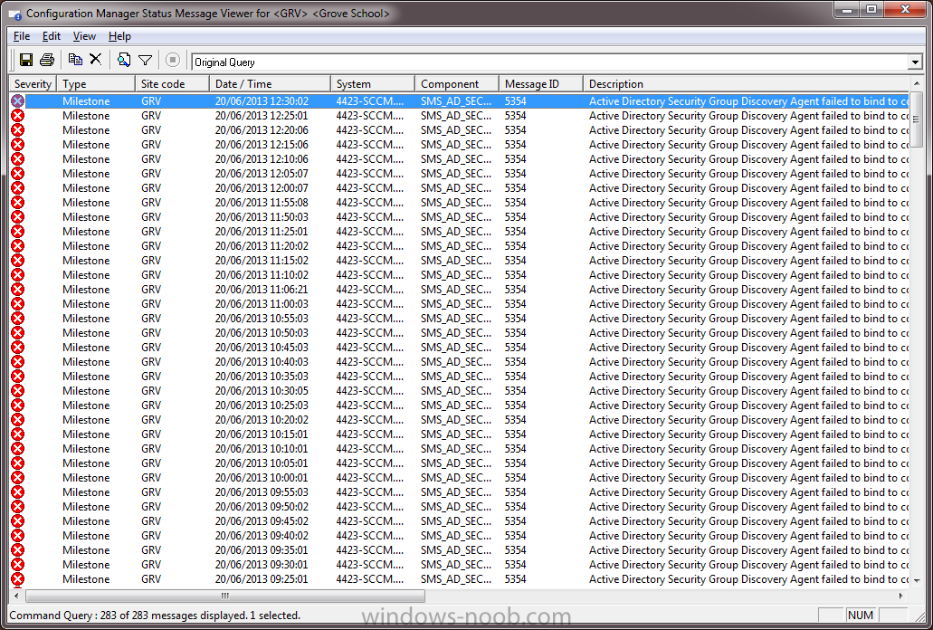

  2. Hi Guys, I have recently upgraded to SP1 (this morning lol). All seemed to go well (except that my icons for the console are blank now, but meh...never mind. I have reinstalled as well...). Anyway, upon checking some logs/monitors, I came accross this: It tells me that the Domain Controller is not there, and I need to tell it where it is. This is because, uknown to me, my boss decided to re-install ALL of the DC's because they were running Windows 2008 R2, when the hardware doesn't support R2, so he downgraded them, even though they were working for for the past how ever many years!!!!! This has only been happening since then, so it's obviously that which has caused it, and it makes sense. My question is, what do I do to help it? How to I tell it where it all is again? Everything actually seems to be working well, and if it wasn't for the SP1 upgrade, I wouldn't have checked it and seen it. Bit odd. Hope this makes sense Phil

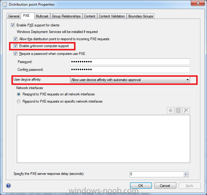

  3. No, don't touch WDS, as even though the setting says not to respond, there is another setting you have set (assuming you followed anyweb's guides), which says to respond from SCCM: As far as I know, that should be what you need to allow WDS to respond. There are three places you need PXE enabled for your computers to be able to successfuly boot to PXE for imaging: From anywebs post on deploying W7: Make sure they are all set. Is this a VM or real pc that you are booting to PXE? When you try to boot, does it have any error? Does it retireve an IP Address? Does it start to load anything, or just fail? Phil

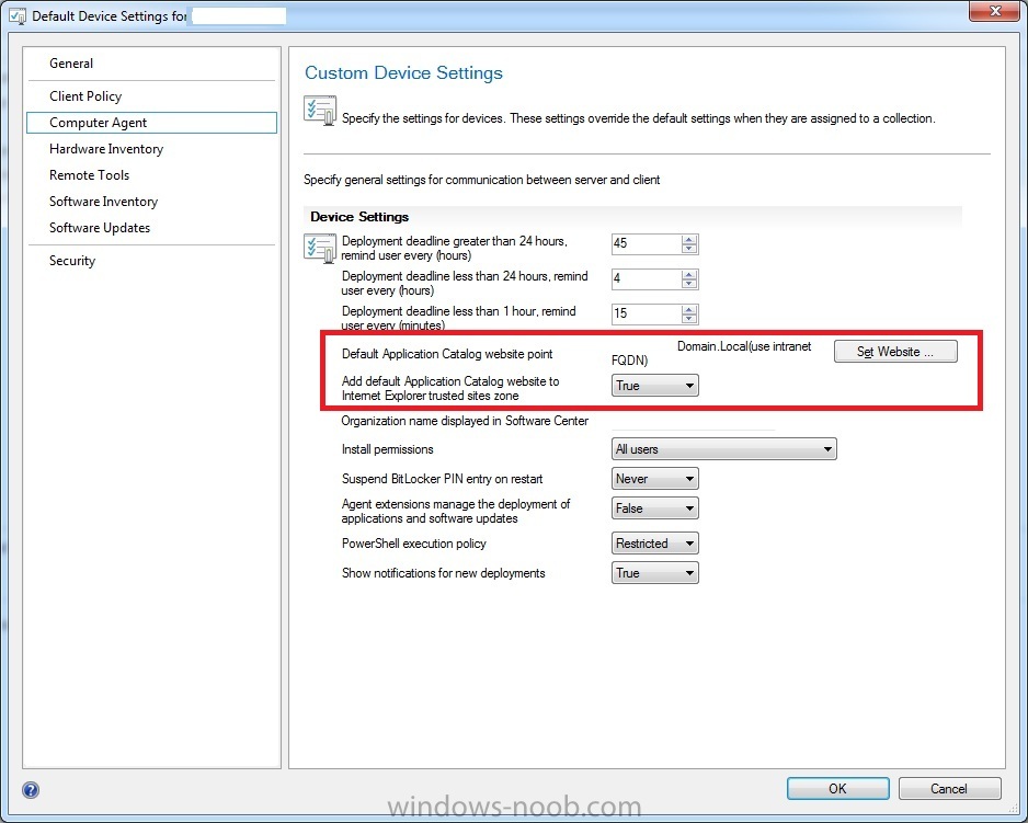

  6. Have you checked your client device settings? The ones where you have set "Computer Agent", is it set in there to use the correct server?

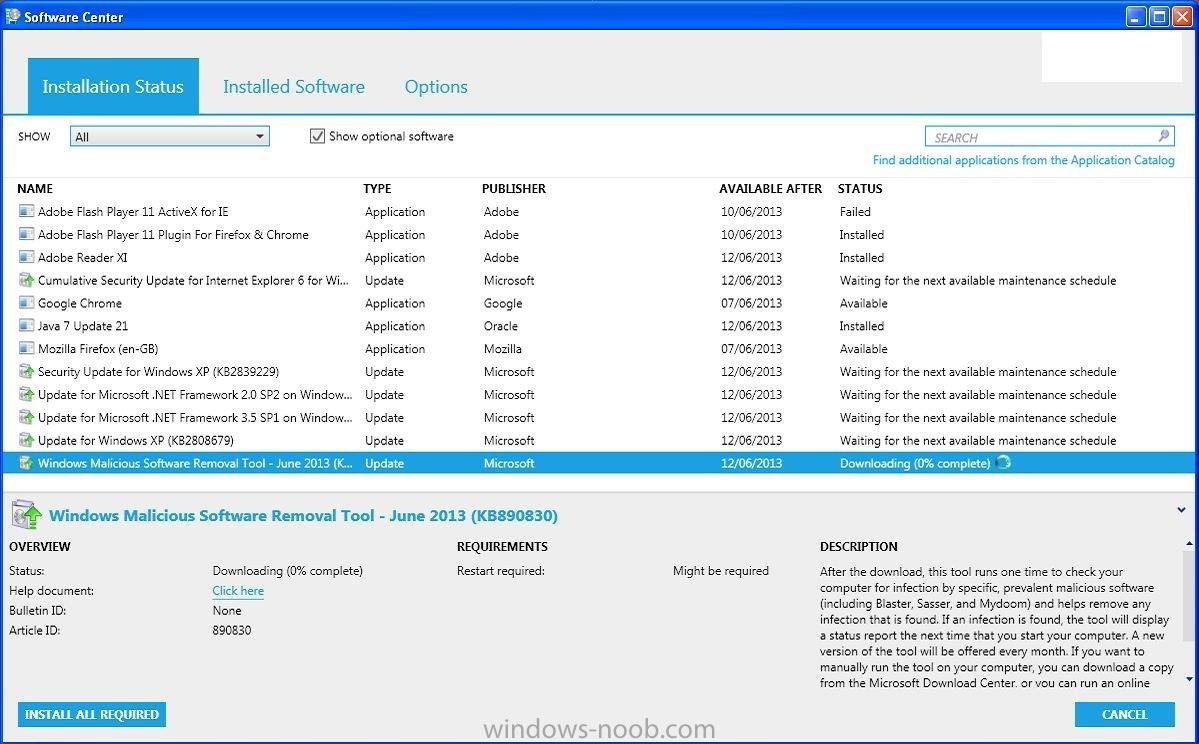

  11. Hello forum! Firstly, I would like to thank anyweb for all of his guides and help he has been able to give us all!! Anyway, I am after my own little bit of personal help. I have successfull installed and deployed SCCM 2012 to a live AD Environment. It already has a WSUS server, but I have since changed Group Policy to point to my new SCCM Server. I have added the SUP and DP roles to SCCM, and configured WSUS as you have explained i: using System Center 2012 Configuration Manager - Part 5& using System Center 2012 Configuration Manager - Part 9. Deploying Monthly UpdatesIt has successfully downloaded and deployed updates to my PC's (XP in this case, but I do have others like Server 2003, 2008, 2008R2 and Windows 7). It shows in the Software Center: As you can see, it is showing 0% downloaded. It has been like this for a couple of days now, and if I try to get another to run at the same time, it says no because there is an install already in progress. I have seen this post, and tried the boundary changes, and also adding the DP to a DP Group, but no luck (reverted the boundary back to AD now, but left DP in DP Group, as I can't see it being a bad thing?!?). I have followed the guides to the word, except for the odd word where I have had to name things to match our naming convention of course lol. I hope someone can help me, as I am in the middle of creating a new Image for my network (both Windows XP and Windows 7), and I would prefer as many updates already applied as possible before I take the image, and of course, I would like to have it all working . EVERYTHING else seems to work, from deploying software and images, to creating device collections with rules. This is the ONLY issue I have. And one last thing, WSUS has been installed on the new server, never touched, just opened once accidentaly and then closed immediately, nothing touched. Also, the old WSUS server is still up, but nothing is talking to it at the moment. Thanks very much to anyone who can help me, I hope this post can help and relate to others too! Phil
