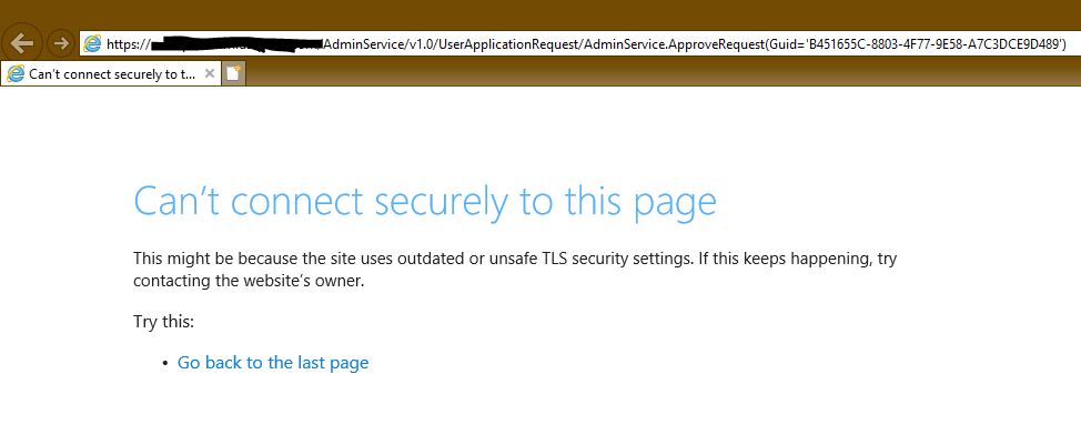

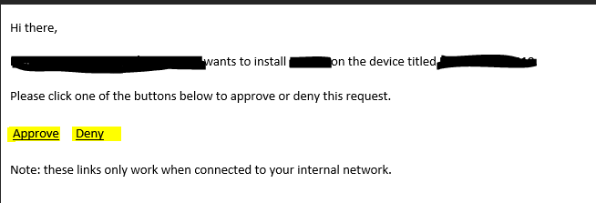

Been checking out the new email approval feature for application requests in CB1810, however, I am running into an issue and can't seem to figure it out. To start, I can successfully request an application and SCCM triggers the alert and I successfully receive an email. However, when I attempt to approve or deny the request, I get a website security error and can't proceed. I am not using Azure integration and I am attempting this on my local intranet. Any ideas? (Sensitive information removed) Thanks! Mark

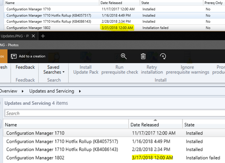

Well.....after jumping through a ton of hoops and unofficial Microsoft documentation to get SCCM to re-download the latest build of 1802, it unfortunately failed with the exact same error message. I copied all pertinent details and replied to the comment from the Microsoft engineer from within the Feedback Hub. So sadly at the moment, still no 1802 yet.

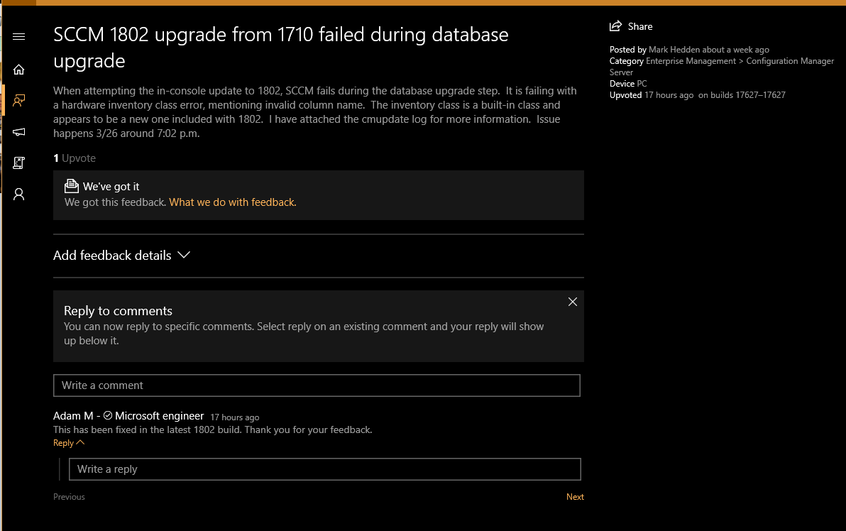

Hey Niall, Just wanted to post an update. I received a response this morning from Microsoft on the Windows 10 Feedback Hub. The response is attached to this post, but according to them, the database upgrade issue has been fixed in the latest 1802 build. No other details were given but I am assuming that if I retry the install, it should work, barring it downloads the latest version. Judging by the SCCM console the build was updated since I last tried it. I will post an update late this afternoon with the results.

HI, So I am attempting to upgrade my SCCM environment from 1710 to the new 1802 build and I am running into the same error message as Cordell. During the upgrade, SCCM fails to upgrade the database and when looking at the log files, it generates an error mentioning, "Invalid column name 'DeviceHardwareData00'.:v_HS_MDM_DEVDETAIL_EXT01". I have attached the cmupdate log for review. I did take a look at djammer's twitter post and left a comment there as well but from what I can tell, nothing has been determined yet. We haven't setup any custom hardware classes that I am aware of and the one that it errors out on appears to be built-in. Any help would be appreciated! Thanks! Mark CMUpdate.log
