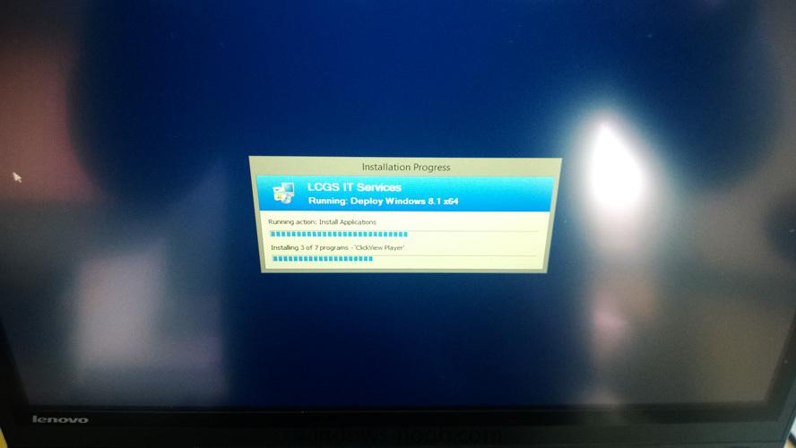

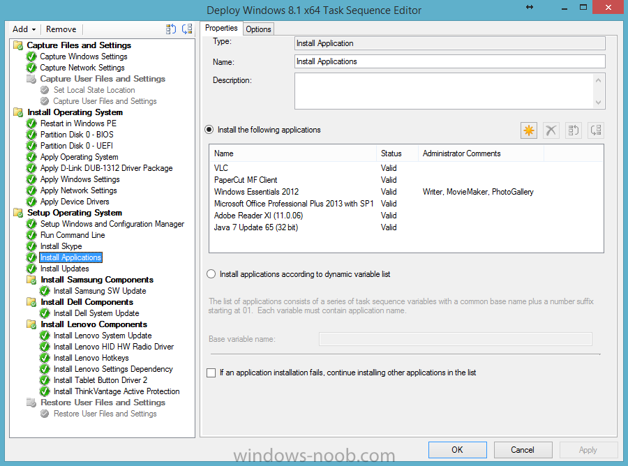

Had a machine do this today that we were imaging using PXE (also have another machine that is skipping some app installs, that's using TS media). First time through it imaged but just seemed to skip a bunch of applications (Office and a few others), so we kicked it off again and second time round it hung sometime after it started installing the second application in the list (see attached image of the TS). I did find the smsts.log file this time, it was as suggested in C:\_SMSTaskSequence\Logs - I have attached all the log files I could find.
