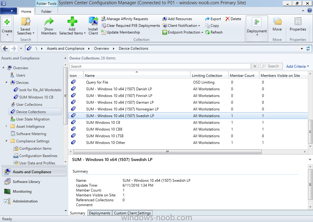

Step 1. Create some Collections
You'll need to identify what language pack is installed (set as the System UI), to do that you can create collections based on a few things namely:
  • Windows 10, for example Windows 10 Enterprise
  • The Build number, for example 10240
  • Language pack installed as the System UI, or LocaleID, for example Swedish is 1053
and that can be done via queries such as the following:
select SMS_R_SYSTEM.ResourceID,SMS_R_SYSTEM.ResourceType,SMS_R_SYSTEM.Name,SMS_R_SYSTEM.SMSUniqueIdentifier,SMS_R_SYSTEM.ResourceDomainORWorkgroup,SMS_R_SYSTEM.Client from SMS_R_System inner join SMS_G_System_OPERATING_SYSTEM on SMS_G_System_OPERATING_SYSTEM.ResourceID = SMS_R_System.ResourceId where SMS_R_System.OperatingSystemNameandVersion = "Microsoft Windows NT Workstation 10.0" and SMS_G_System_OPERATING_SYSTEM.BuildNumber = "10240" and SMS_G_System_OPERATING_SYSTEM.OSLanguage = "1053"
In the query above, the values looked for are:
  • SMS_R_System.OperatingSystemNameandVersion = "Microsoft Windows NT Workstation 10.0"
  • SMS_G_System_OPERATING_SYSTEM.BuildNumber = "10240"
  • SMS_G_System_OPERATING_SYSTEM.OSLanguage = "1053"
Assuming you are deploying Windows 10 Enterprise, the only two values you'll need to think about are the build number and language (locale ID). You can see a full list of locale IDs here. Remember that Windows 10 servicing is all about moving from one build to the next build number eg: build 10240 > 10586 so you need to create collection of devices that are running the build you want to service.
Note: The script mentioned below depends on a limiting collection called All Workstations which was created in this post. If you haven't run that script yet, please do so otherwise you'll see errors.

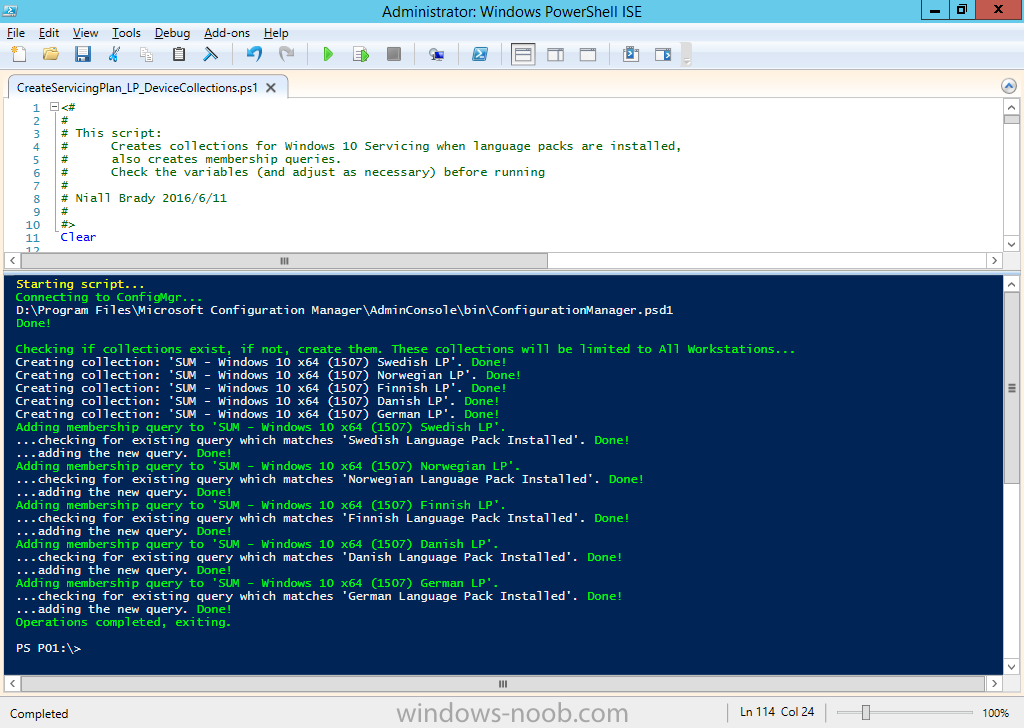

You could create the collections manually by manipulating the query used above or use a PowerShell script to do the hard work for you. In the downloads section of this guide you'll see a script called CreateServicingPlan_LP_DeviceCollections.ps1. Download it, open it in Windows PowerShell ISE and edit any variables prior to running it. This script will create collections for the following languages and for Windows 10 Enterprise version 1507, build 10240:
  • Danish
  • Finnish
  • German
  • Norwegian
  • Swedish
and you can easily edit it to create more collections with the corresponding queries. Below is an example output when the script runs.
after the script has run, you'll see the new Device Collections have been created and populated with the correct devices

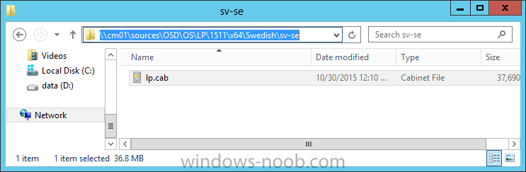

The <share> you specify in the text file must contain a sub-folder matching the language pack as shown below
and in that folder, the corresponding lp.cab file for the version of Windows you are updating to (in this example, version 1511) is present

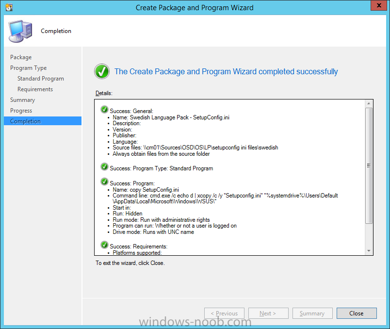

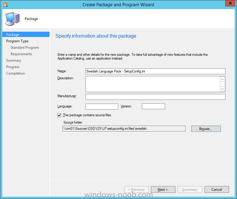

You can create a package/program to copy the appropriate file to all computers with the matching language package installed. To do that, do as folllows:
In the ConfigMgr console click on Software Library, then click on Application Management, Packages. Right click and choose Create Package. Fill in the following details:
  • Name: Swedish Language Pack - SetupConfig.ini
  • Source Folder: \\cm01\Sources\OSD\OS\LP\setupconfig ini files\swedish

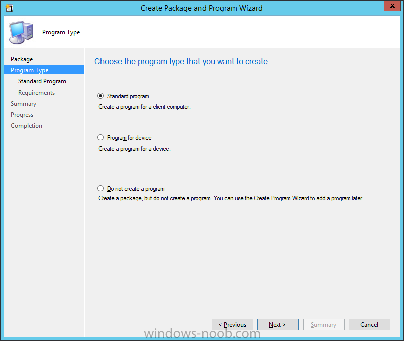

when prompted to create a program, choose Standard Program

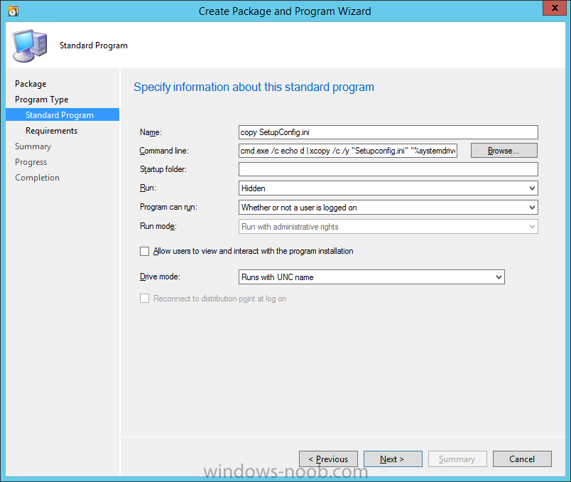

use the following settings for the program
Name: copy SetupConfig.ini
Command line:
cmd.exe /c echo d | xcopy /c /y "Setupconfig.ini" "%systemdrive%\Users\Default\AppData\Local\Microsoft\Windows\WSUS\"
Run: Hidden
Program can run: Whether or not a user is logged on
as per the screenshot:

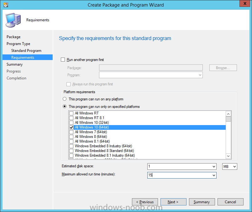

for requirements change it to Windows 10 x64 as shown here:
and continue through the wizard until completion

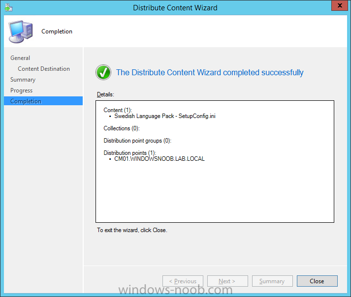

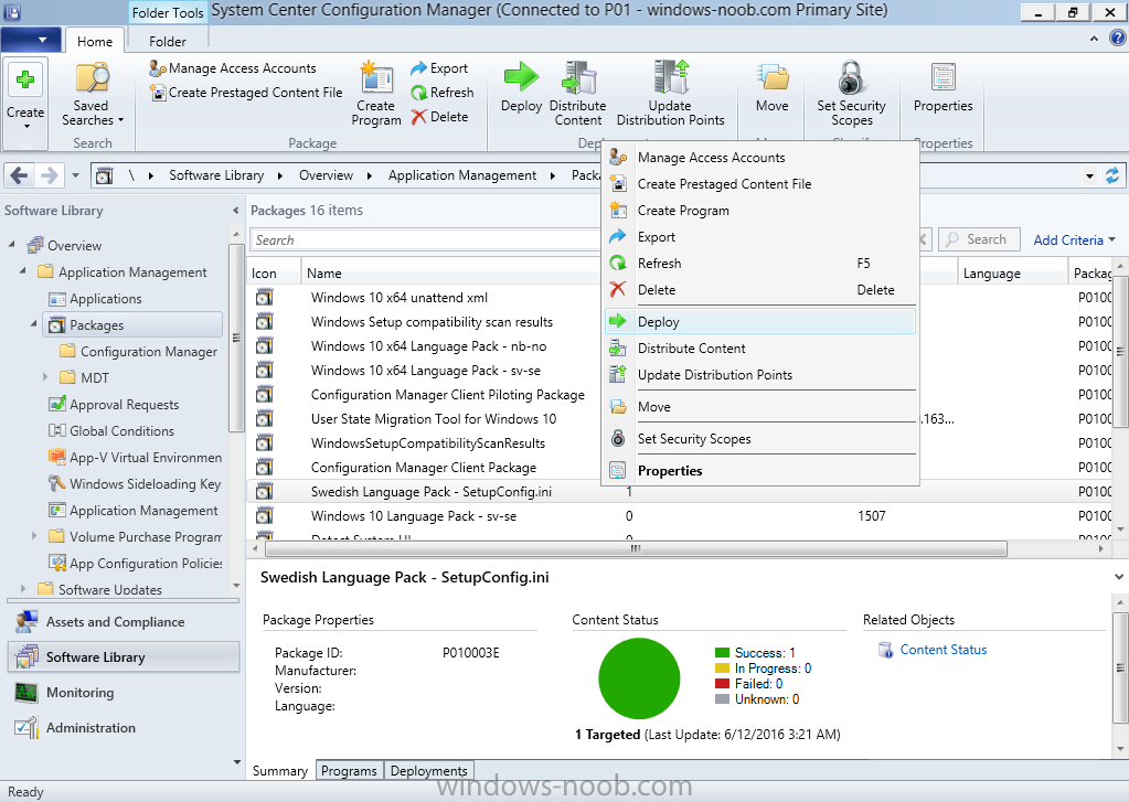

Now that the package is created, you need to distribute the content, right click on the package and choose Distribute Content.
add one or more distribution points and continue through that wizard until completion.

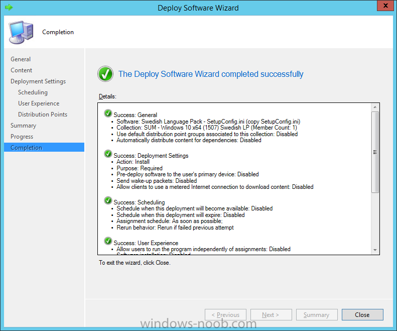

And in order to get the file on the computers, you must deploy the package, so go ahead, right click on the package and choose Deploy.

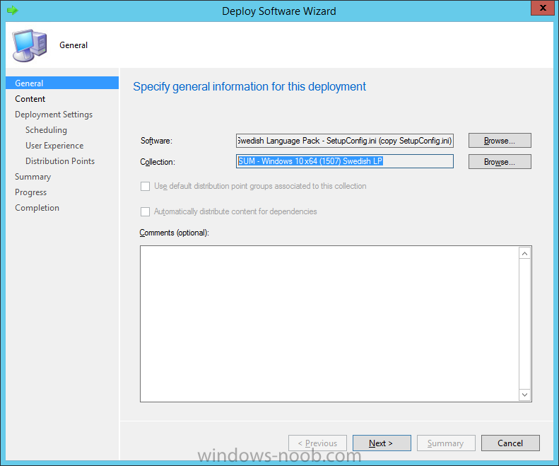

In the Deploy wizard, for collection choose the collection that matches the language pack the setupconfig.ini file was created for, in this example, Swedish, so use SUM - Windows 10 x64 (1507) Swedish LP

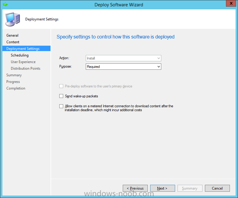

for Deployment Settings, use a purpose of Required
for Schedule, click on New and choose As soon as possible
and continue through the Deploy Software Wizard until completion.

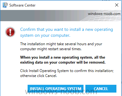

and once the policy is received by the client the update shows up in Software Center
notice the update warning text...

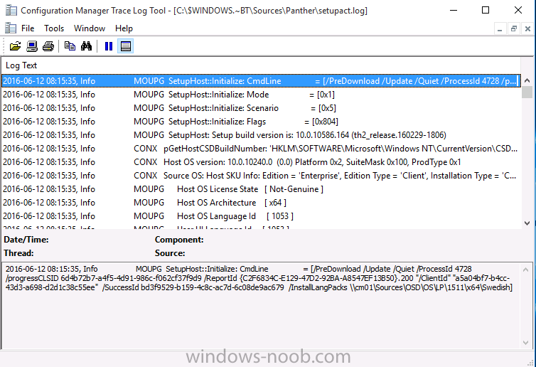

during the upgrade, the setupact.log log file will reveal information about the language pack involved and where it expects to find it (taken from the setupconfig.ini file)

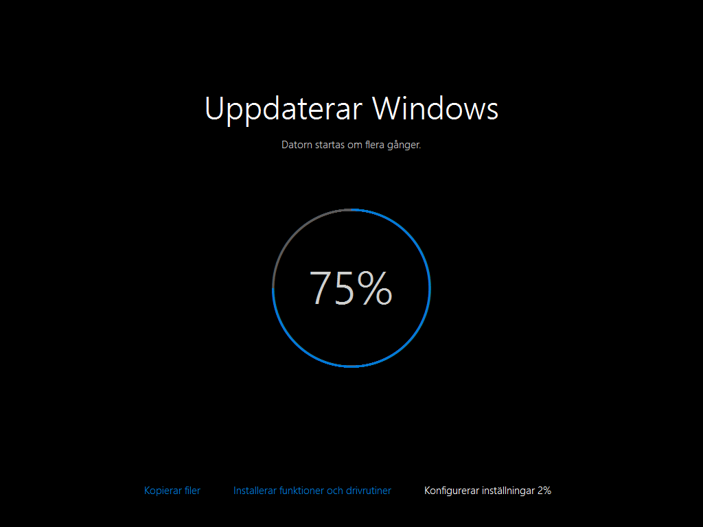

and the computer will restart and then the upgrade will being in earnest

Bit of a necro bump but has anyone tried this with 1803?  I had to revert to running the langpack installs with dism in my postoobe script.
The language packs fail to install during setup, and fail the upgrade. Might have something to do with how they restructured the upgrade process... Works ok from my script but I dont like how there is now a 6-8 minute wait to complete the install when the screen is sitting at "100%" status...
The collections are empty for me. I have changed the script to reflect my languages (see below) but they do not become members.
If I query SMS_G_System_OPERATING_SYSTEM.OSLanguage i get : "English - United States" or "Japanese" but not the LocaleID
Am I missing something?
$Collection_1 = "SUM - Windows 10 x64 ($Windows10Version) French LP"
$Collection_2 = "SUM - Windows 10 x64 ($Windows10Version) Japanese LP"
$Collection_3 = "SUM - Windows 10 x64 ($Windows10Version) Chinese LP"
$Collection_4 = "SUM - Windows 10 x64 ($Windows10Version) Spanish LP"
$Collection_5 = "SUM - Windows 10 x64 ($Windows10Version) Mexican LP"
$LimitingCollectionName = "All Workstations"
write-host "Starting script..." -ForegroundColor Yellow
# connect to ConfigMgr
# thanks Skatterbrainz - https://www.windows-noob.com/forums/topic/13613-how-can-i-configure-client-settings-and-install-the-configmgr-client-agent-in-system-center-configuration-manager-current-branch/?p=53923
Get-CmAdminConsolePath
# Create collections based on the list of collections
Create-Collections
# add some queries to our collections
$TargetCollection = $Collection_1
$RuleName = "French Language Pack Installed"
$RuleNameQuery = "select SMS_R_SYSTEM.ResourceID,SMS_R_SYSTEM.ResourceType,SMS_R_SYSTEM.Name,SMS_R_SYSTEM.SMSUniqueIdentifier,SMS_R_SYSTEM.ResourceDomainORWorkgroup,SMS_R_SYSTEM.Client from SMS_R_System inner join SMS_G_System_OPERATING_SYSTEM on SMS_G_System_OPERATING_SYSTEM.ResourceID = SMS_R_System.ResourceId where SMS_R_System.OperatingSystemNameandVersion = 'Microsoft Windows NT Workstation 10.0' and SMS_G_System_OPERATING_SYSTEM.BuildNumber = '$BuildNumber' and SMS_G_System_OPERATING_SYSTEM.OSLanguage = '1036'"
Add-Membership-Query($TargetCollection)
$TargetCollection = $Collection_2
$RuleName = "Japanese Language Pack Installed"
$RuleNameQuery = "select SMS_R_SYSTEM.ResourceID,SMS_R_SYSTEM.ResourceType,SMS_R_SYSTEM.Name,SMS_R_SYSTEM.SMSUniqueIdentifier,SMS_R_SYSTEM.ResourceDomainORWorkgroup,SMS_R_SYSTEM.Client from SMS_R_System inner join SMS_G_System_OPERATING_SYSTEM on SMS_G_System_OPERATING_SYSTEM.ResourceID = SMS_R_System.ResourceId where SMS_R_System.OperatingSystemNameandVersion = 'Microsoft Windows NT Workstation 10.0' and SMS_G_System_OPERATING_SYSTEM.BuildNumber = '$BuildNumber' and SMS_G_System_OPERATING_SYSTEM.OSLanguage = '1041'"
$TargetCollection = $Collection_3
$RuleName = "Chinese Language Pack Installed"
$RuleNameQuery = "select SMS_R_SYSTEM.ResourceID,SMS_R_SYSTEM.ResourceType,SMS_R_SYSTEM.Name,SMS_R_SYSTEM.SMSUniqueIdentifier,SMS_R_SYSTEM.ResourceDomainORWorkgroup,SMS_R_SYSTEM.Client from SMS_R_System inner join SMS_G_System_OPERATING_SYSTEM on SMS_G_System_OPERATING_SYSTEM.ResourceID = SMS_R_System.ResourceId where SMS_R_System.OperatingSystemNameandVersion = 'Microsoft Windows NT Workstation 10.0' and SMS_G_System_OPERATING_SYSTEM.BuildNumber = '$BuildNumber' and SMS_G_System_OPERATING_SYSTEM.OSLanguage = '2052'"
$TargetCollection = $Collection_4
$RuleName = "Spanish Language Pack Installed"
$RuleNameQuery = "select SMS_R_SYSTEM.ResourceID,SMS_R_SYSTEM.ResourceType,SMS_R_SYSTEM.Name,SMS_R_SYSTEM.SMSUniqueIdentifier,SMS_R_SYSTEM.ResourceDomainORWorkgroup,SMS_R_SYSTEM.Client from SMS_R_System inner join SMS_G_System_OPERATING_SYSTEM on SMS_G_System_OPERATING_SYSTEM.ResourceID = SMS_R_System.ResourceId where SMS_R_System.OperatingSystemNameandVersion = 'Microsoft Windows NT Workstation 10.0' and SMS_G_System_OPERATING_SYSTEM.BuildNumber = '$BuildNumber' and SMS_G_System_OPERATING_SYSTEM.OSLanguage = '3082'"
$TargetCollection = $Collection_5
$RuleName = "Mexican Language Pack Installed"
$RuleNameQuery = "select SMS_R_SYSTEM.ResourceID,SMS_R_SYSTEM.ResourceType,SMS_R_SYSTEM.Name,SMS_R_SYSTEM.SMSUniqueIdentifier,SMS_R_SYSTEM.ResourceDomainORWorkgroup,SMS_R_SYSTEM.Client from SMS_R_System inner join SMS_G_System_OPERATING_SYSTEM on SMS_G_System_OPERATING_SYSTEM.ResourceID = SMS_R_System.ResourceId where SMS_R_System.OperatingSystemNameandVersion = 'Microsoft Windows NT Workstation 10.0' and SMS_G_System_OPERATING_SYSTEM.BuildNumber = '$BuildNumber' and SMS_G_System_OPERATING_SYSTEM.OSLanguage = '2058'"
