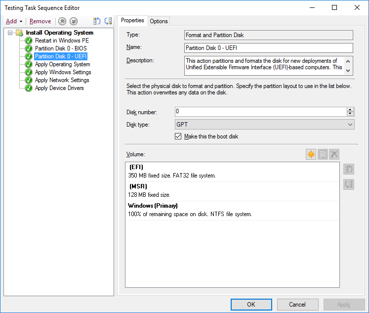

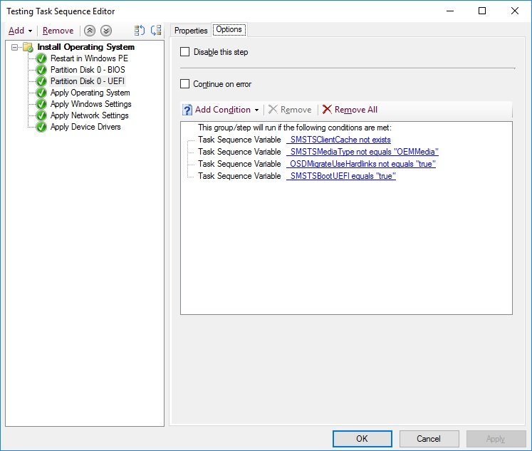

is your task sequence formatting the disc as GPT (uefi) ? I would leave your computer with UEFI/Secure Boot enabled.
Hi it is. Please find screenshot of my test TS atatched.

ok the bios mode of your computer is BIOS not UEFI, no wonder it's not working as you want
change it to UEFI with Secure boot enabled and try again.

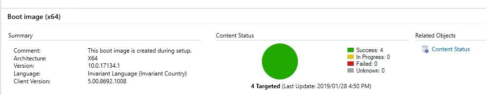

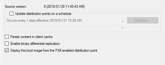

if you cannot PXE boot in UEFI mode have you verified youve distributed the x64 boot image to your dp's and enabled it for pxe ?

Yup positive. I even re-distributed the images. I also tested on E5580, and that imaged perfectly. I compared BIOS settings, and they are exact (apart from versions which I think I am going to upgrade now).
