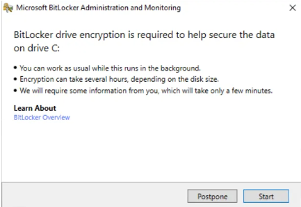

Now if I deploy my Bitlocker policy to a client, the client does get the policy and MBAM agent is installed.But The Bitlocker Administration and Monitoring does not appear. But I can start is manually
If I run now the proccess, it works but I cannot see any KEY under SQL server. After some research I saw in eventlog on the client-->MBAM-->Admin
The following warning: Unable to connect to the MBAM Recovery and Hardware service.

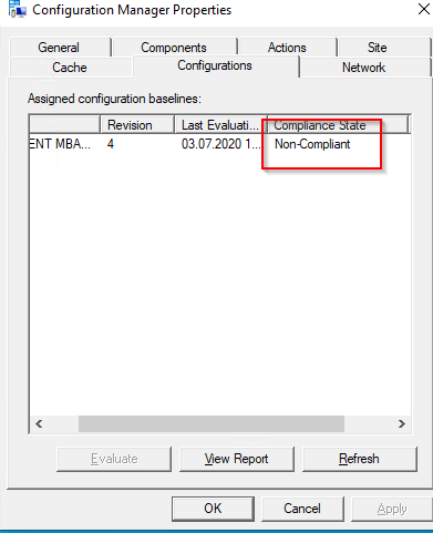

On the client machine you cansee, it is still Non-Complaint

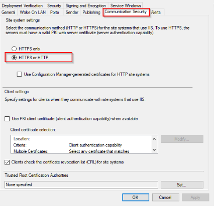

if you choose to not use PKI in your infrastructure then you need to add a PKI-based server auth cert to the IIS website hosting the recovery service – this can be the same cert you used when configuring HTTPS on the MP or another PKI-issued cert if not using HTTPS.
I have change the sccm server and all MP Wsus and client client, but I have find out that that on the client machine if I run "configuration Manager", and go to Configuartion, is frozen. Can you tell me why is frozen the Configuratio? I follow exact your guide for PKI (part on and two)
And if got to windows update and run "Check for Update", I got always error message. I am not maybe because on GPO I have pushed for client install, http://sccm.local. Is that the reason?
You mean I can create a cert for IIS server and put it for Binding HTTPS on "Default web site".? What is with WSUS server and MP and DP? Can I use MP, DP , WSUS with HTTP?
What is with "Trust Root Certification Authories" Should I put there my "ROOT CA"
