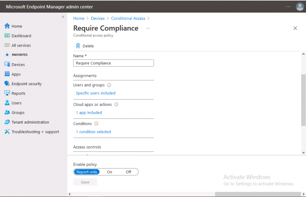

Now you'll create your first conditional access policy, to do so in Microsoft Endpoint Manager, select devices and then select Conditional Access from the Policy node (shown below).

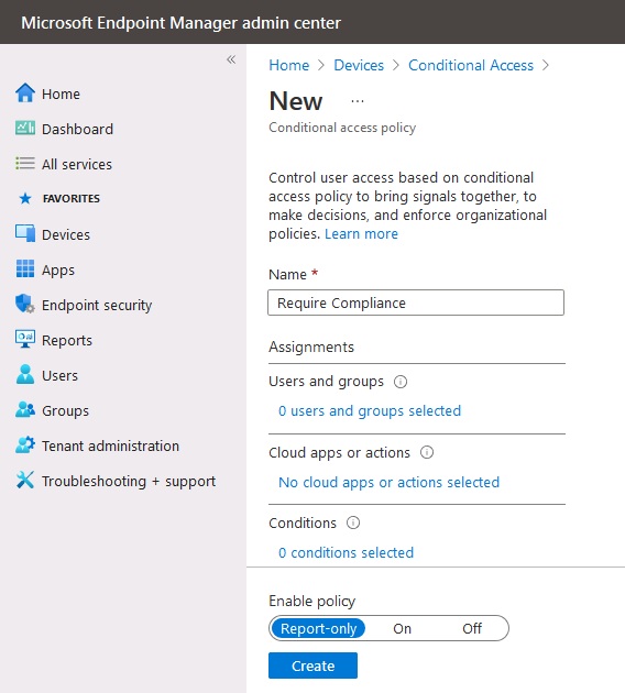

In the Conditional Access pane, click on + New Policy, give it a suitable name such as Require Compliance
In the Assignments section click on 0 users and groups selected, in the pane that appears select Include, and select select users and groups and add the Azure ad group created in step 1.
For the Cloud apps or actions selection, select No cloud apps or actions selected and then choose select apps and select a suitable app such as Office 365.

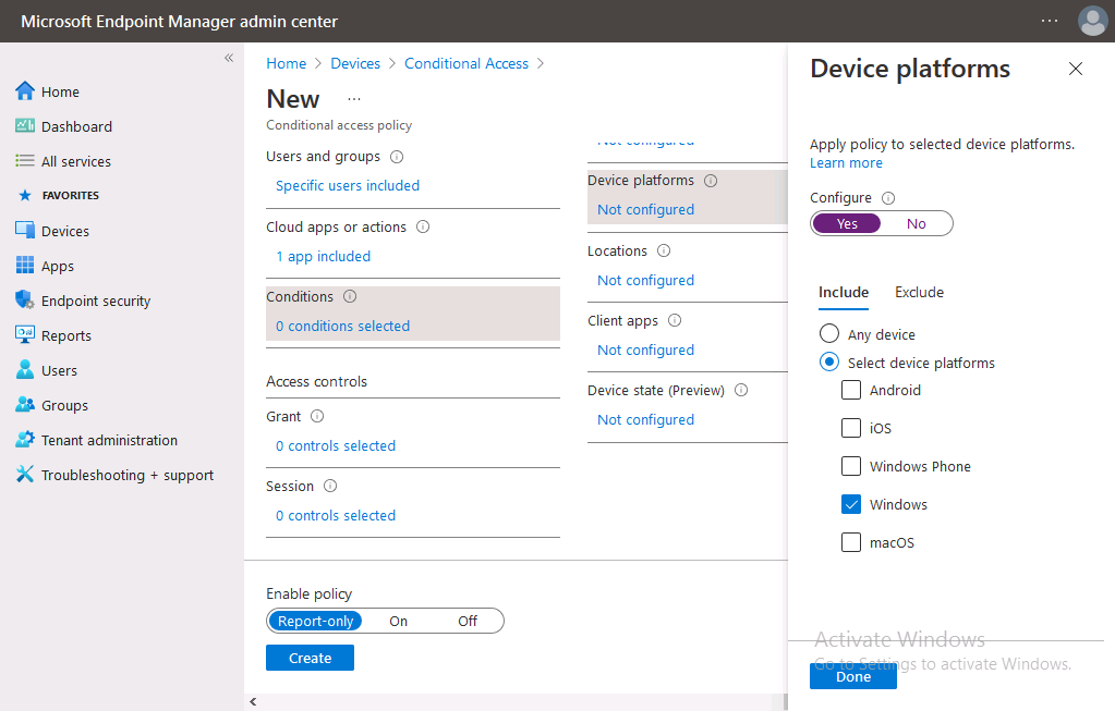

For the Conditions selection, select 0 conditions selected and select the following conditions, Device platforms, select select device platforms and select Windows as shown here and then select Done.
Note: You could use other conditions to fine grain the conditional access rules such as trusted locations, use modern authentication only etc but this is just an example.

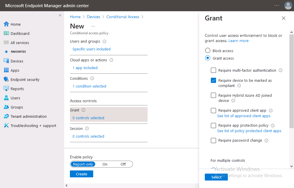

Next, select the Access controls you wish to apply to this policy. For Grant select that the device is marked as Require device to be marked as compliant. Click Select when done.
Finally, we will set the policy to Report-only for now so we can test the rule in case we have negative impact on the targeted users which can later be remedied before switching the policy On. Finally, click on Create.

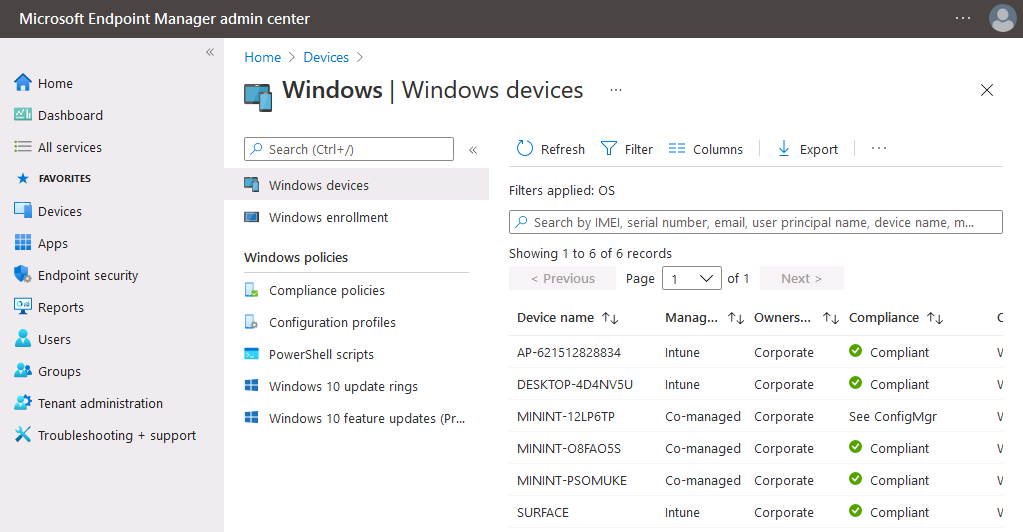

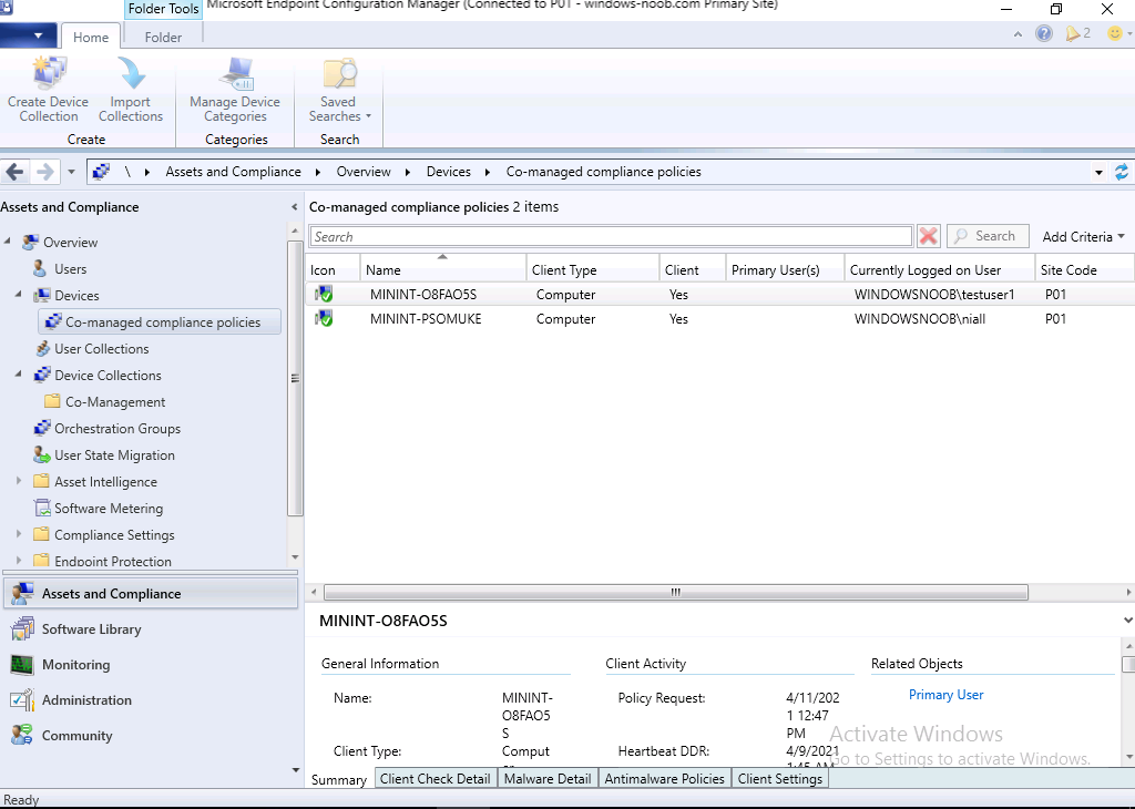

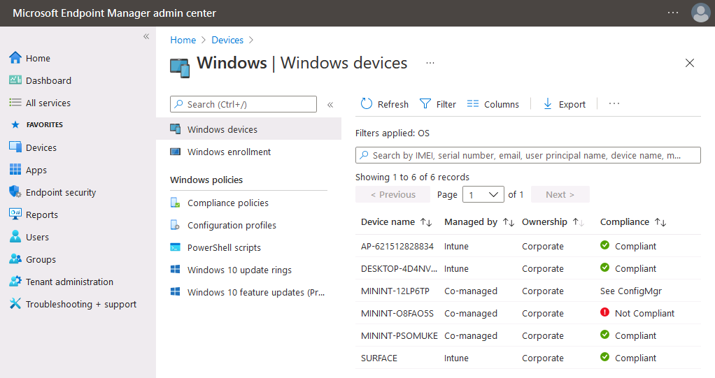

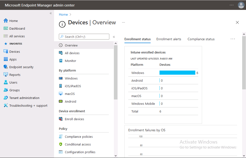

Below you can see our test devices.
And here you can see that the device in question MININT-08FAO5S is Co-managed and with a compliance state of not compliant.

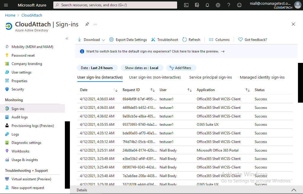

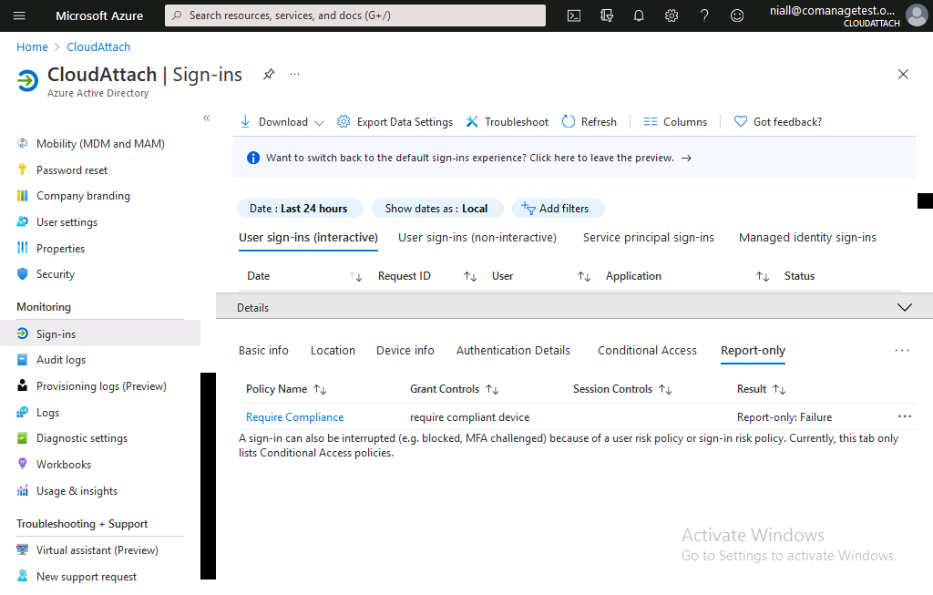

In portal.azure.com select Azure Active directory and scroll down to Sign-ins. This will list all sign-ins for that tenant.
Select the latest sign-in for the test user testuser1 (which is added to the azure ad group we created in step 1).
As this conditional access policy is in report-only mode, select the Report-only tab and you'll see a report of what happened and it's status as shown here:

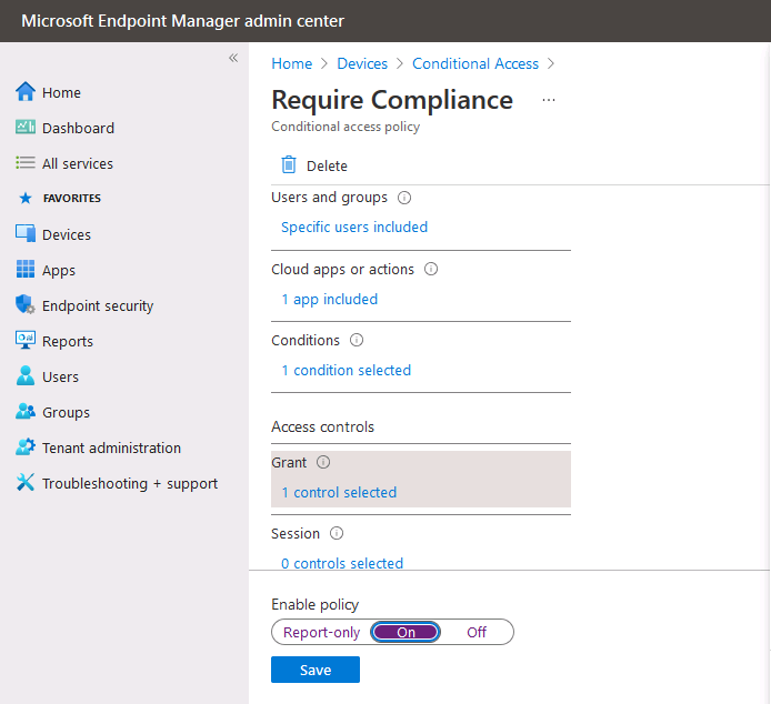

Now that we've verified it works, let's flip the compliance policy to On and click Save.

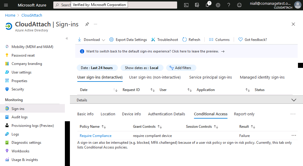

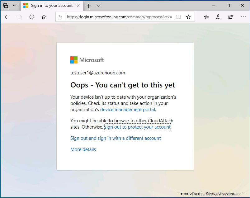

On the test computer, sign out of office and once again try and browse to https://www.office.com you should see that conditional access blocks access to that resource !
And back in Azure AD, if you check the sign-ins and this time select the Conditional Access tab... you can see that it's correctly reported as a failure.
At this point, you can go ahead and encrypt the device with BitLocker, so that it becomes Compliant in Intune.
Here we can see the device is listed now as Compliant.

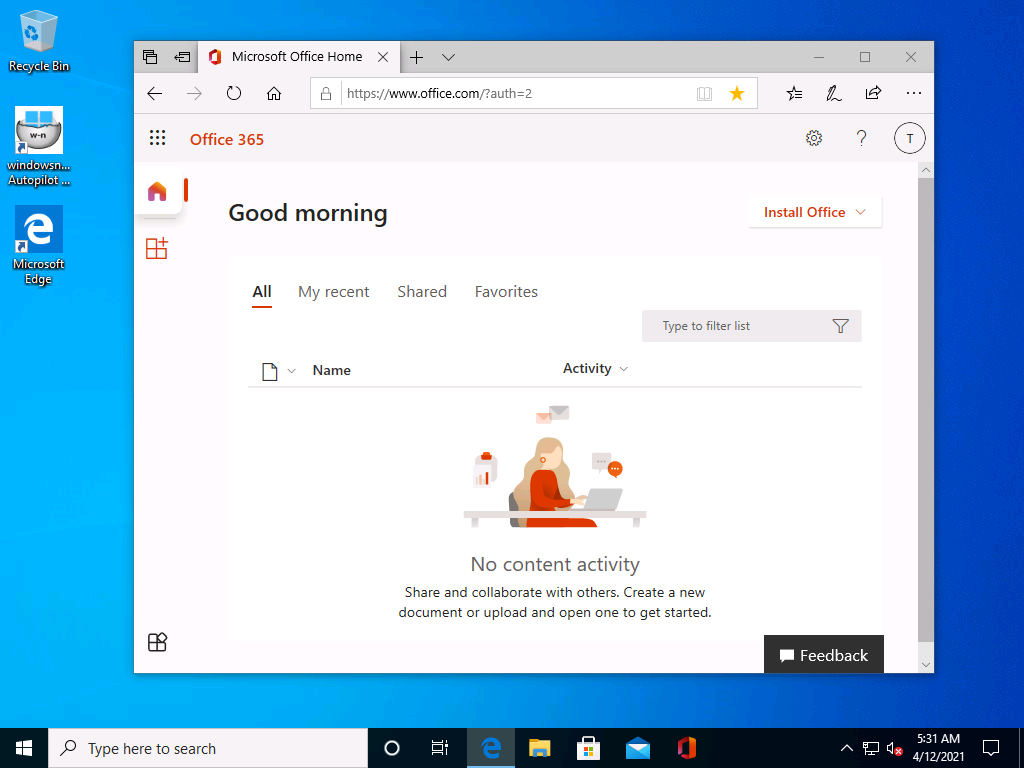

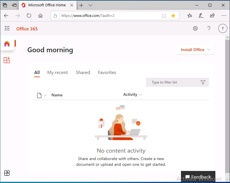

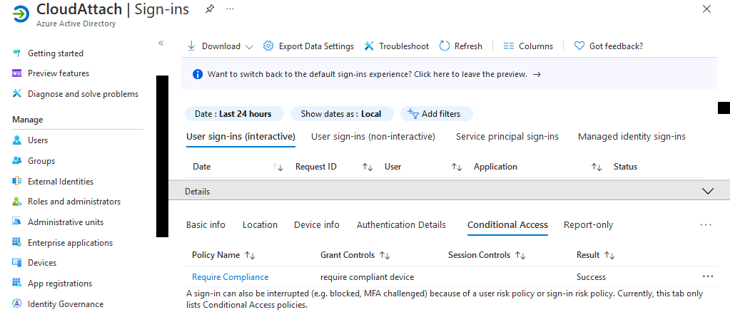

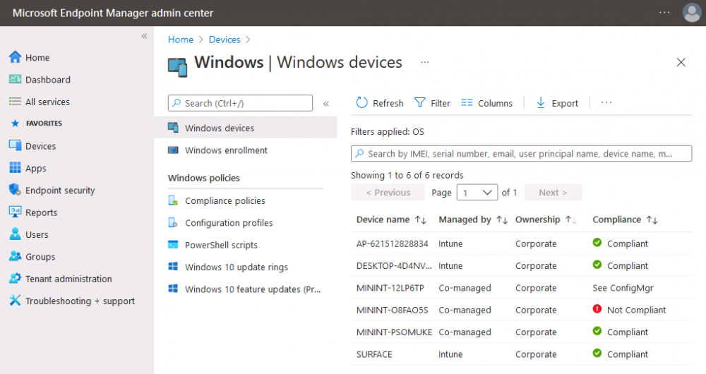

Now that it is compliant, verify that it can access Office while using Conditional Access. It should work just fine.
And you can verify that too, in the Azure AD sign-ins, using the Conditional Access tab, here you can see that for the policy named Require compliance, with a grant controls of require compliant device it has a result of Success.
Job done, you've successfully enabled your first Conditional Access policy and reviewed how it functions on a co-managed device.
