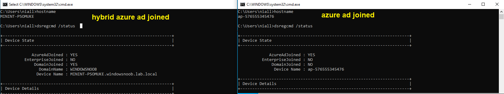

To determine if a device is hybrid azure ad joined or azure ad joined let's take a look at the output of a command on two different computers, the following command will reveal this info.
dsregcmd /status
This reveals info containing lots of details, but we are mainly interested in the following properties of the device state.
  • AzureADJoined
  • DomainJoined
On the left we have our hybrid azure ad joined device which is joined to an on-premises domain as well as joined to Azure AD. On the right, the equivalent output is shown from an azure ad joined device, as you can see the device on the right is only joined to Azure AD and that device is the target of today's blog post. We will show you how to co-manage this azure ad joined device and the steps needed to achieve that easily.

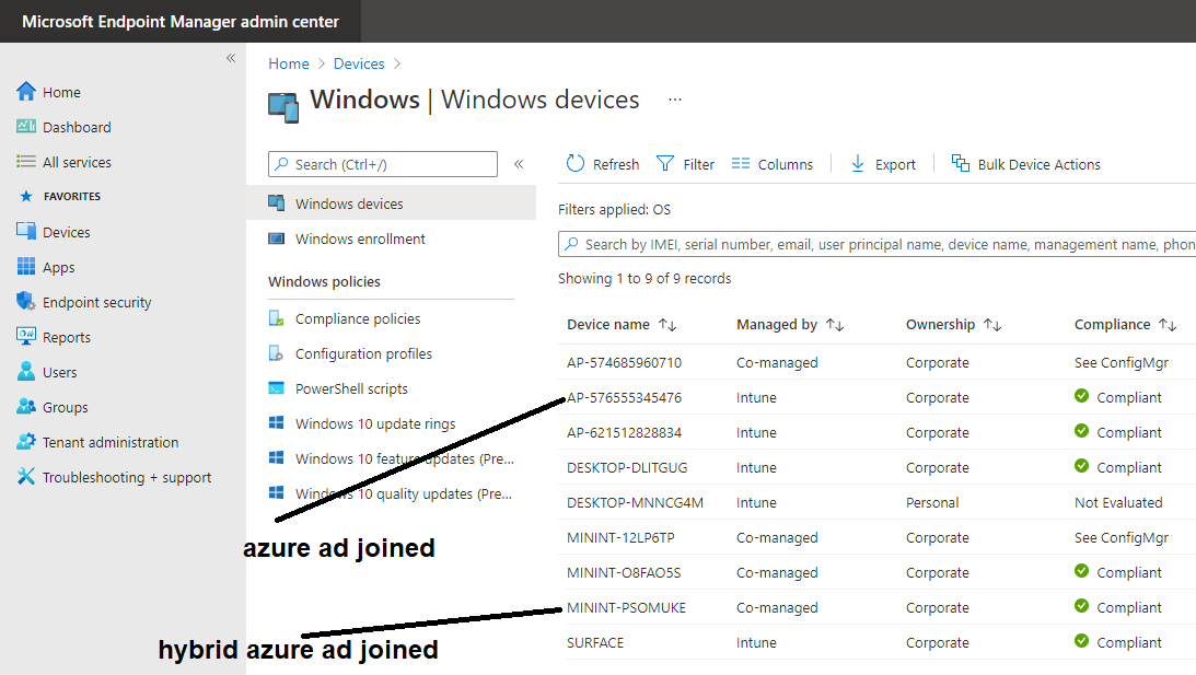

If we look in Microsoft Endpoint Manager we can see those two devices, note that the hybrid azure ad joined device is already co-managed while the Azure AD joined device is not but it is enrolled into Intune.

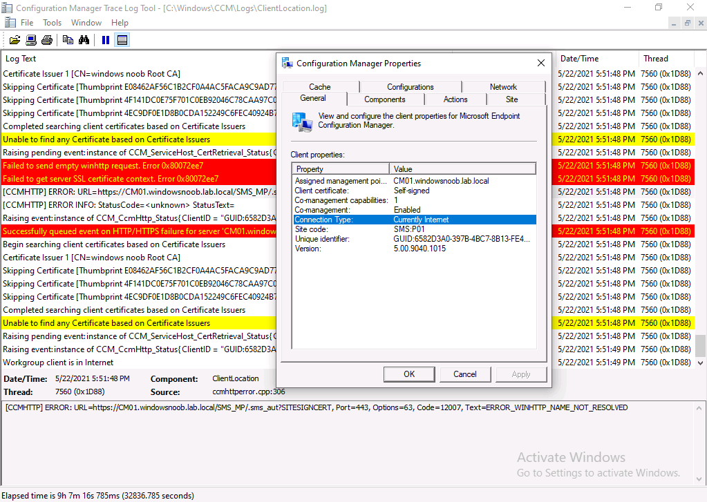

Below you can see how the client behaves when it is on the same network as your on-premises infrastructure when these certificates are not deployed to it. Note the errors in ClientLocation.log and how the Connection Type is set to Currently Internet.

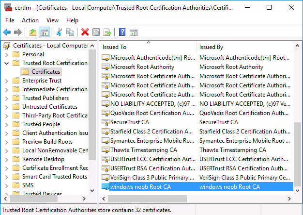

To export the certificates you can do as follows. On a client computer that has the certificates installed, open CertLM.msc and select the Trusted Root Certification section, select Certificates and browse to your Trusted Root Certificate.
Right click the chosen certificate and choose Export.

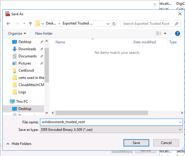

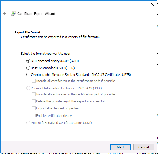

For Export File Format, choose the default option DER encoded binary x.509 (.CER) and click Next.

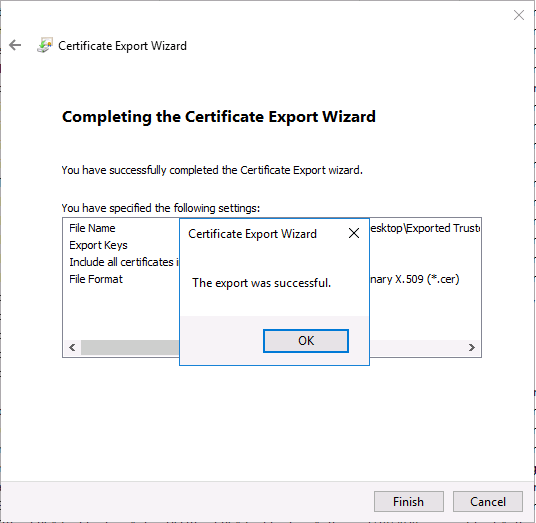

Next specify the name of the file to export, we recommend naming it after the actual certificate function and click Save.
and click OK and then click Finish at the summary.

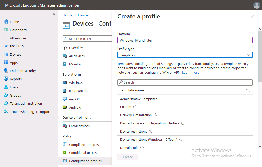

Open Microsoft Endpoint Manager and select Devices, select Configuration Profiles, select Windows 10 or later, and then select Templates.

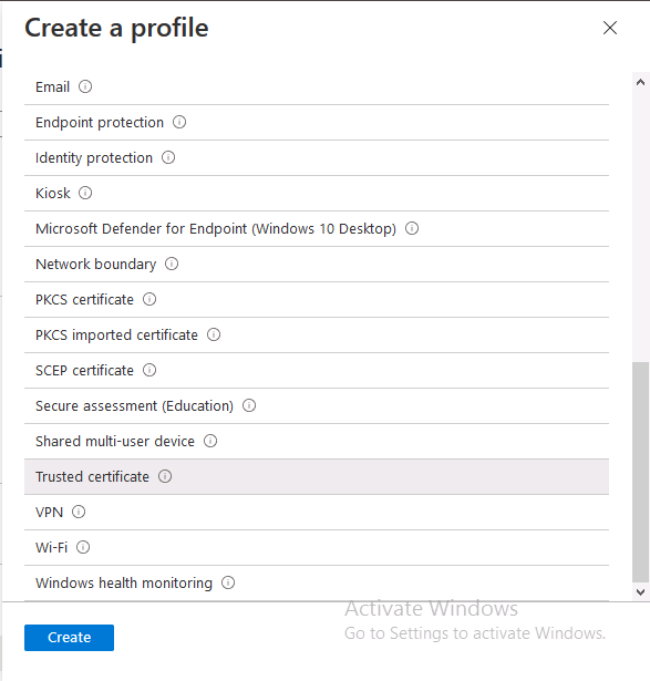

In Templates, scroll down to Trusted certificate.
and click Create.

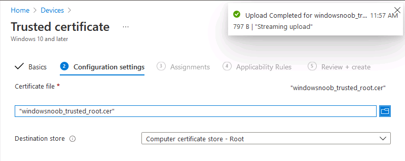

then point it to the related certificate file exported above and make sure to select the correct destination store for the certificate. Below is how the Trusted Root Certificate is deployed, note the destination store is Computer certificate store - Root

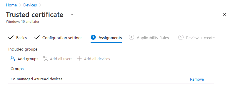

Next, assign the profile to the Azure AD group created in Step 2, in this case it's the Co-managed AzureAD devices group.

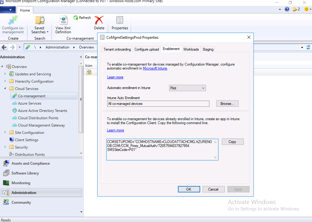

To do so however we'll first need to gather some info for our cmdline, the first part of that cmdline is already present in the Enablement tab of the Co-management node as shown here.
Copy and paste that cmdline into notepad.
CCMSETUPCMD="CCMHOSTNAME=CLOUDATTACHCMG.AZURENOOB.COM/CCM_Proxy_MutualAuth/72057594037927954 SMSSiteCode=P01"

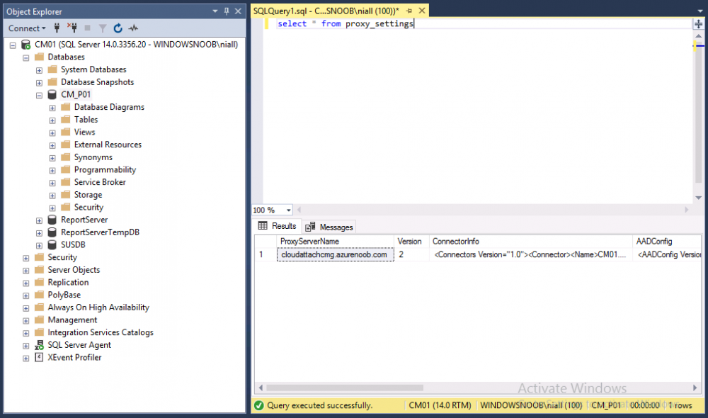

To retrieve some of this data you can query SQL directly with the following command:
select * from proxy_settings
Some data will be returned.

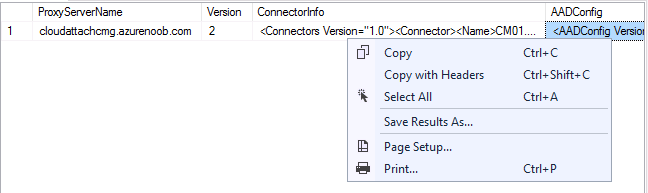

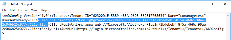

highlight the AADConfig Version column, right click and choose Copy.
Paste the results into notepad, the following values can be retrieved from the data
  • AADCLIENTAPPID
  • AADRESOURCEURI

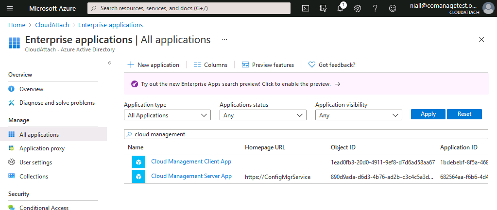

You can even confirm the AADCLIENTAPPID in Enterprise Applications in Azure using the Application ID column.
So now we have those values, the remaining value is for the following setting SMSMP, and that's easy to fill in, so in our case that would be SMSMP=https://cm01.windowsnoob.lab.local
OK, now we've got all the properties populated, here is the finished cmdline
CCMSETUPCMD="CCMHOSTNAME=CLOUDATTACHCMG.AZURENOOB.COM/CCM_Proxy_MutualAuth/72057594037927954 SMSSiteCode=P01 AADCLIENTAPPID=1bdebebf-8f5a-468c-90ae-2c046b25c077 AADRESOURCEURI=https://ConfigMgrService SMSMP=https://cm01.windowsnoob.lab.local"

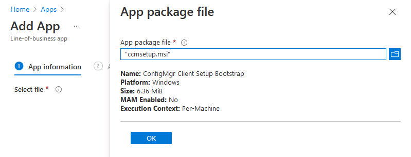

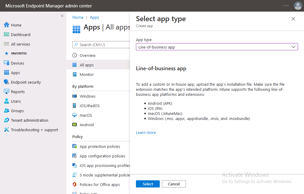

In Microsoft Endpoint Manager, select Apps, select All apps, scroll down to Other and choose Create Line-of-business app. Click on Select.
In the App information screen, point the App package file to the ccmsetup.msi file available in <ConfigMgr installation directory>\bin\i386

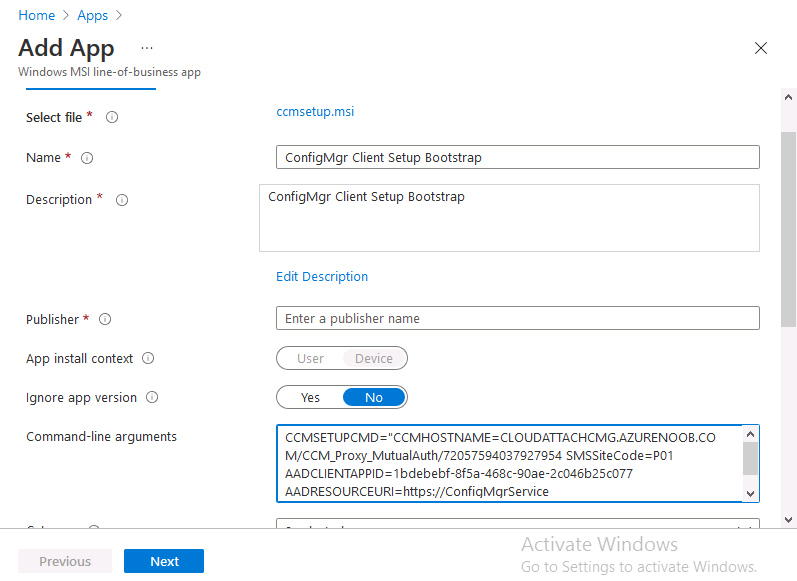

Fill in information as required and paste in the cmdline you've just created above.
