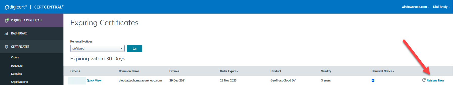

Next, login to your certificate provider (in this case Digicert) and locate the soon to be expired certificate. To the right click on Reissue Now.

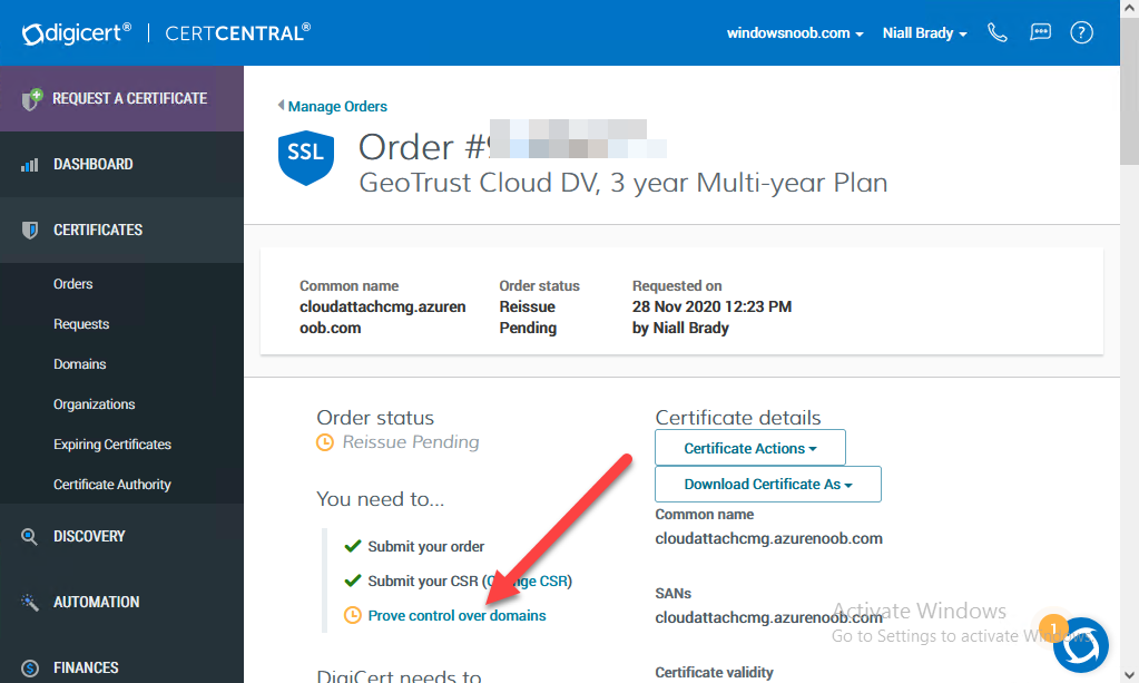

At this point, you will see a summary screen like this, take note that to complete the process you'll have to prove ownership of the domain by clicking on Prove control over domains.
We chose the option to use a DNS TXT Record (recommended).

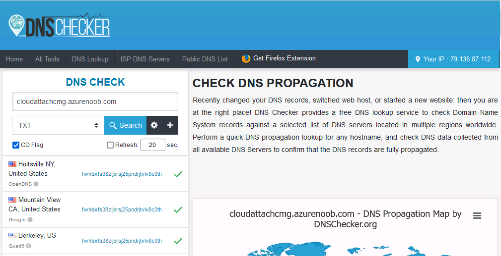

After creating the TXT record you can verify it with dnschecker.org, as shown here, this is helpful in troubleshooting whether your DNS record (TXT, CNAME etc...) is valid or not.
Be sure to enter the cloudattachcmg prefix (yours will be different obviously) into the record for the TXT DNS validation otherwise it might have problems finding the TXT record.

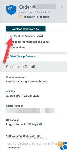

After verifying that you own the domain, you'll be able to download the reissued CRT (certificate) from the certificate provider (eg: DigiTrust).

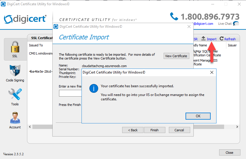

Step 4. Import the CRT
Next, import the downloaded CRT back into the Digicert tool by clicking on Import and pointing it to the extracted CRT file in the zip you downloaded.

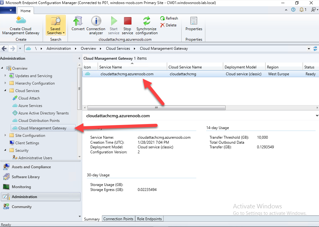

Step 6. Reconfigure the Cloud Management Gateway
In the ConfigMgr console, select Cloud Services and select Cloud Management Gateway.

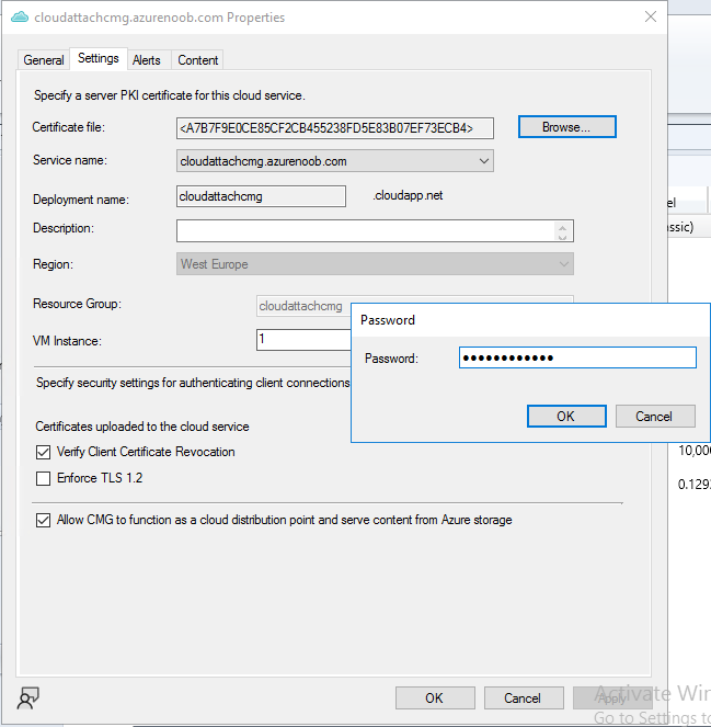

In the CMG properties, choose the Settings tab and click Browse beside the currently expiring PKI certificate
Point it to the previously exported PFX file and enter the password when prompted

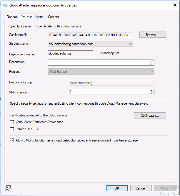

Click Apply, notice that the Certificate File will have changed

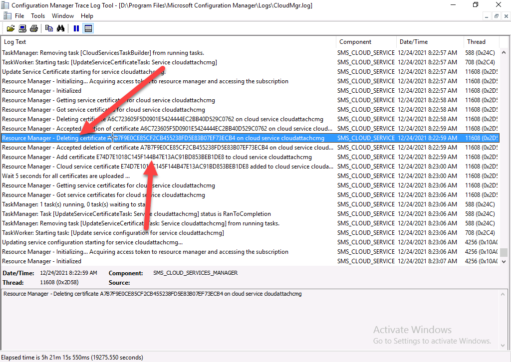

The CloudMgr.log will record this old certificate deletion and the addition of the reissued certificate.
At this point, the hard work is done and your certificate is reissued, and your CMG is reconfigured to use the new certificate. You can verify the CMG is working properly by running the Connection Analyzer.
