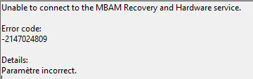

I get an error in the event viewer/MBAM/admin:
Which on Microsoft website means:

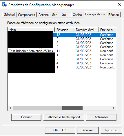

i mean, do the client versions correspond to the site version, if yes then let's figure out if the client is getting the policy or not,
did you check on the configmgr client agent to see if the bitlocker policy you configured is listed ?
Yes, they match. The client version is corresponding to the 2103 sccm version. I see it appearing in the configurations tab on the CCM client. It appears as non compliant until I trigger the encryption manually. I tried to reboot several times but the MBAMclientUI.exe never appears.

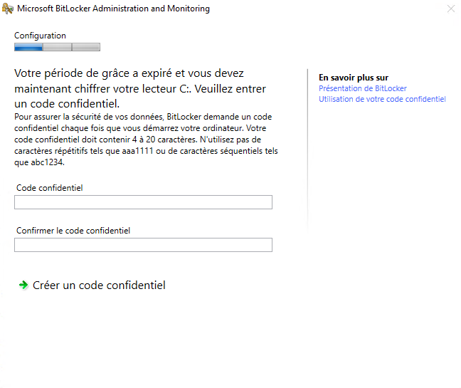

In fact the MBAM client is installed but it doesn't show the wizard asking the user to encrypt its device neither force him too. The only way to encrypt the device is to open a cmd with administrator rights and type manage-bde -on c : or do it trough the control panel.
