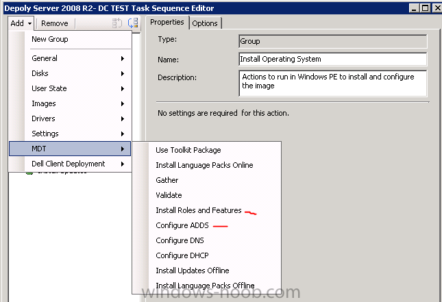

Im having an issue installing ADDS via a task sequence. Im not that familiar with MDT, but I know that if you have it installed it gives you additional task sequence options, one of which is 'configure ADDS', which give you all the options for building a new DC.
However, when the task sequence is run, it errors with the below message:
The task sequence execution engine failed executing the action (Configure ADDS) in the group (Setup Operating System) with the error code 1

Im sorry I dont know what the run Package for MDT is? Im only beginning to look at this, and all I have done is add the ad role and configure adds as shown in image.

Thanks Guys, this process has worked.
The issue was I was trying to create a TS from scratch and adding MDT tasks, when I should have been building an MDT task sequence.
