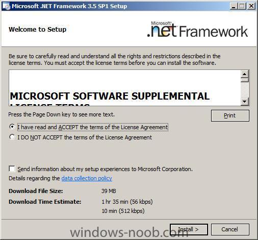

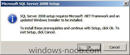

If you get a requirements needed message click ok so that it can install them (updated .NET framework and Windows Installer)

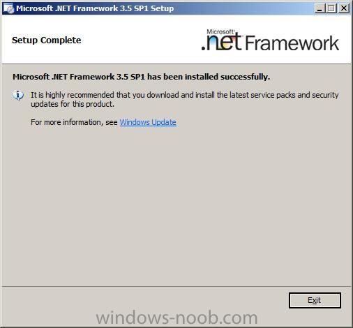

Microsoft .NET Framework 3.5 SP1 update
Accept the license agreement for the .NET update and click install
The actual installation seems to take a few minutes.... if it fails it will give you an error log, you can try installing it again or read the installation issues readme.

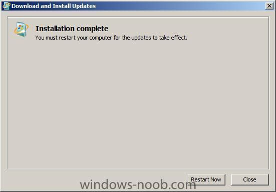

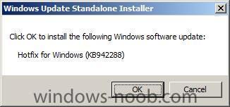

Next you may be promted to install a hotfix (KB942288), click Ok.

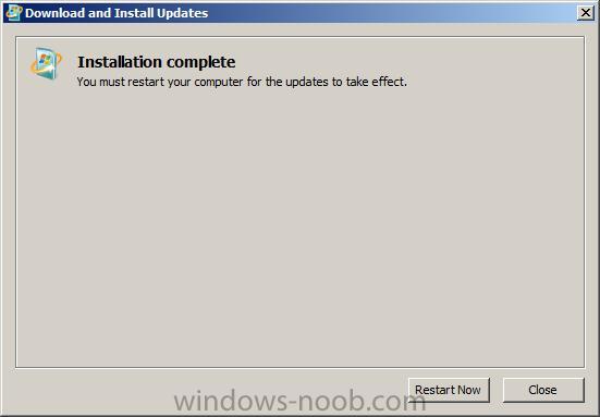

if you were prompted to install the hotfix then you'll be asked to Restart, so lets do that...

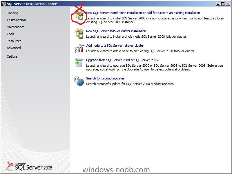

Installation
Click on Installation in the left pane, in the new window that appears, choose the first option which is a new SQL server stand-alone installation.

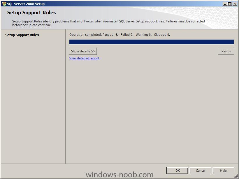

setup support rules
this is turn will do a quick test for setup support rules,
click ok to continue

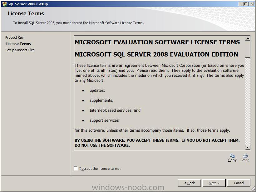

accept the license terms and click next

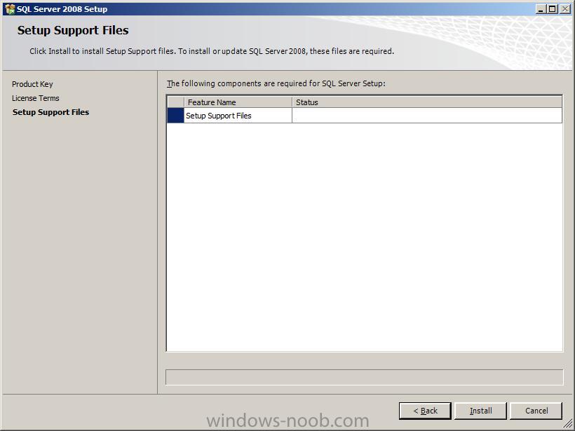

click install to install setup support files...

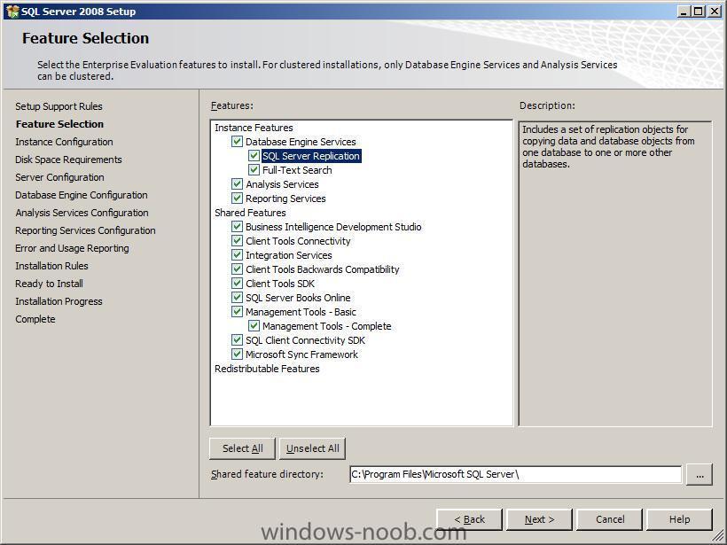

Feature Selection
I chose to Select All and left the path of the install as default.

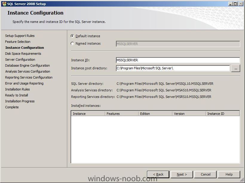

Instance Configuration
I left these options as default

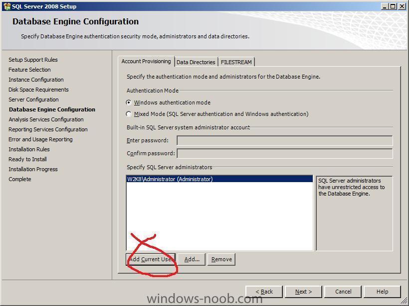

Database Engine Configuration
You can adjust the user settings here depending on your security preferences

for the purpose of this guide, we will add the local administrator by clicking on Add Current User, if this or any options confuse you then click on help in the bottom right corner of the installer.
For Analysis Services configuration, enter the same value (add current user, assuming you are doing this as local administrator...)

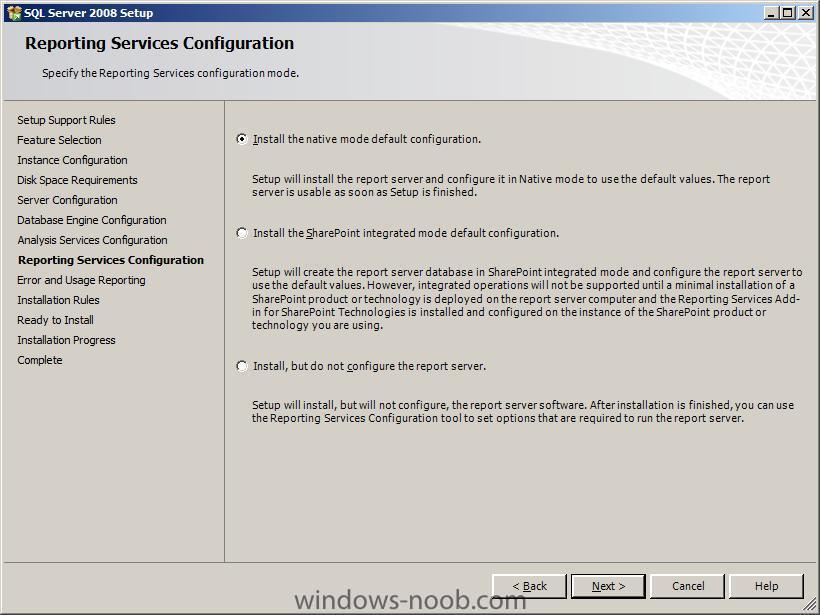

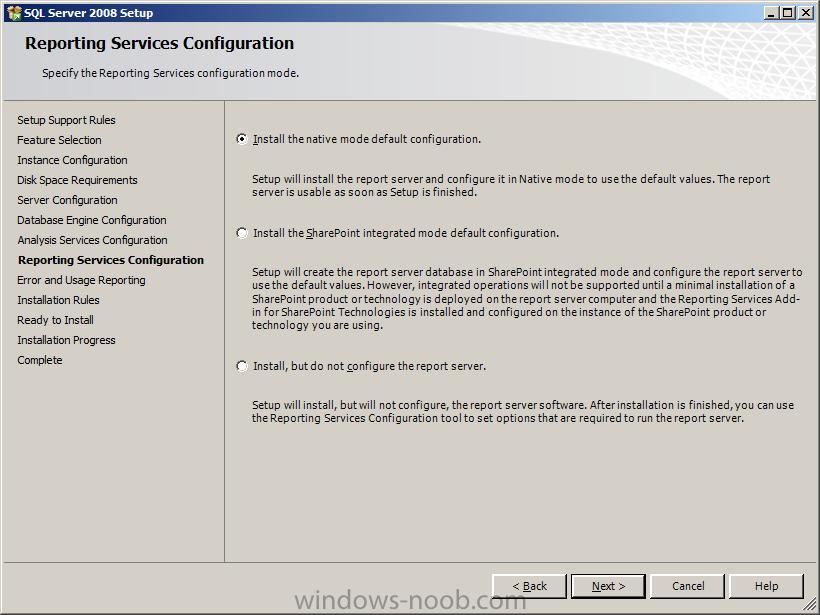

for the Reporting Services configuration, I left the default value (native)

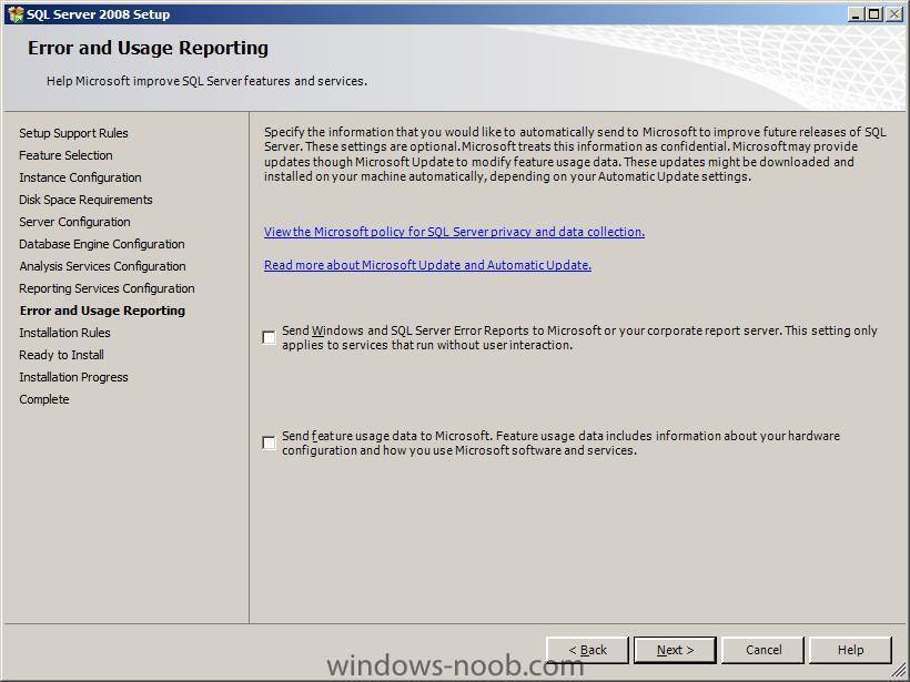

choose your Error and Usage reporting settings and click next

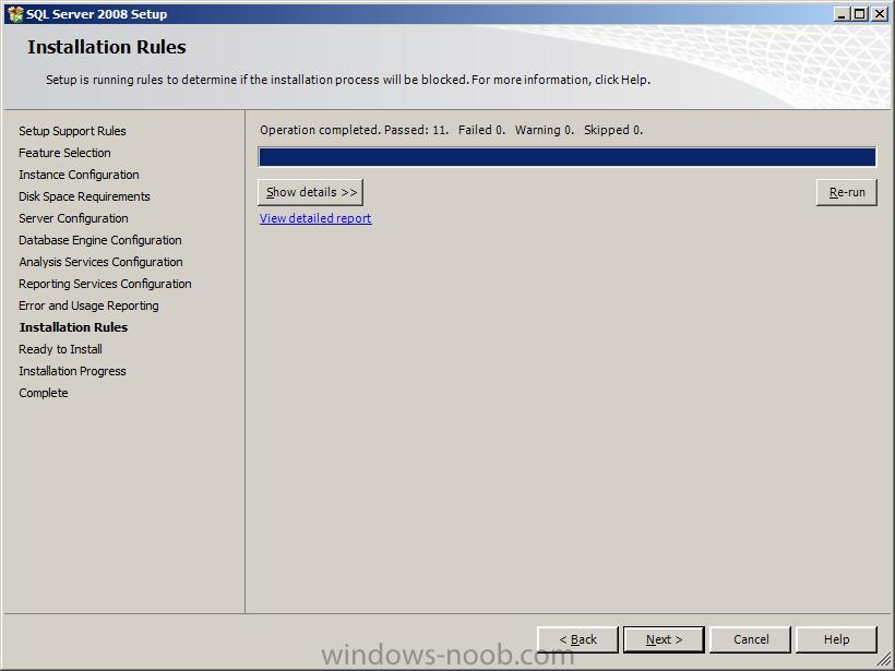

your installation Rules will get a quick check...

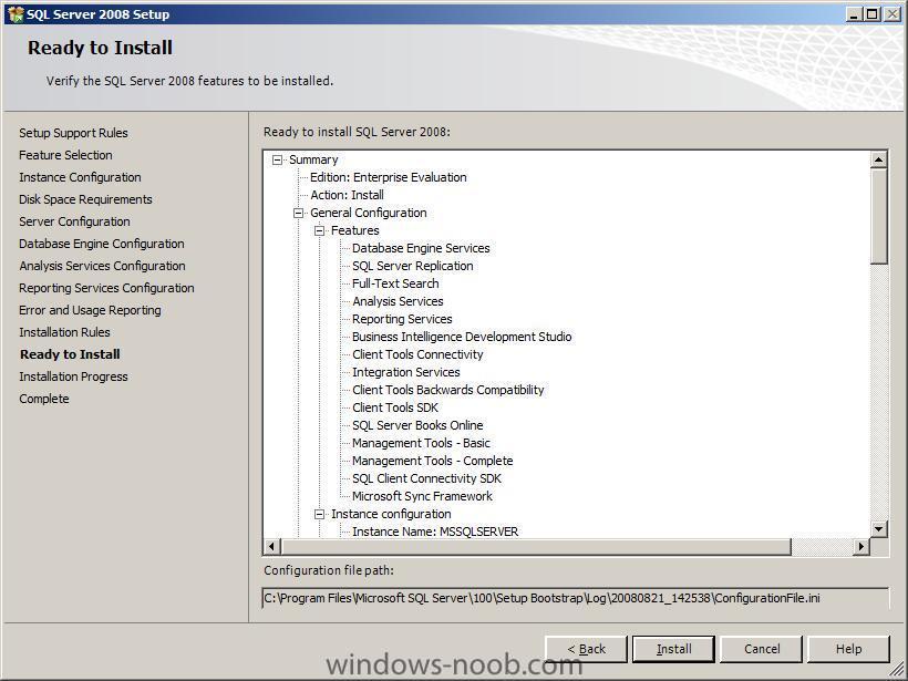

click next to see 'Ready to install' summary'

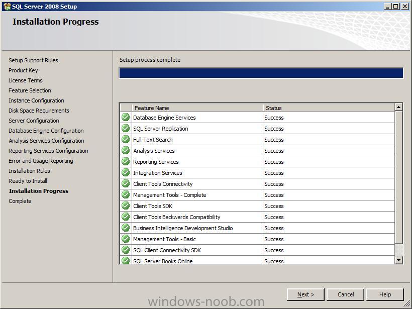

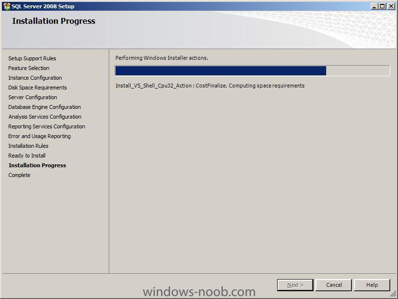

click install to start the installation...
(time for lots of coffee..)

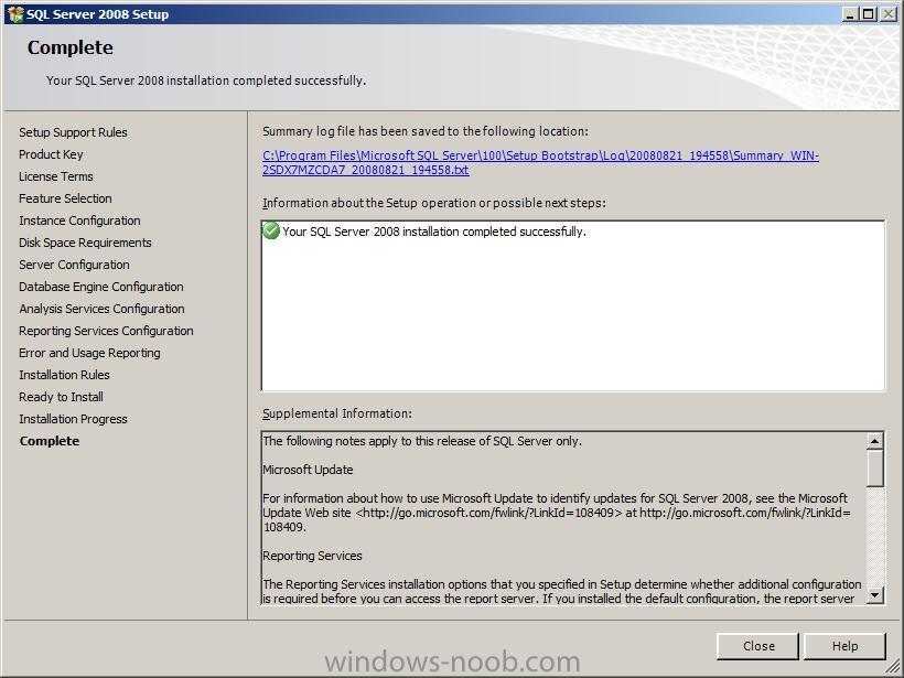

After dinner it was completed

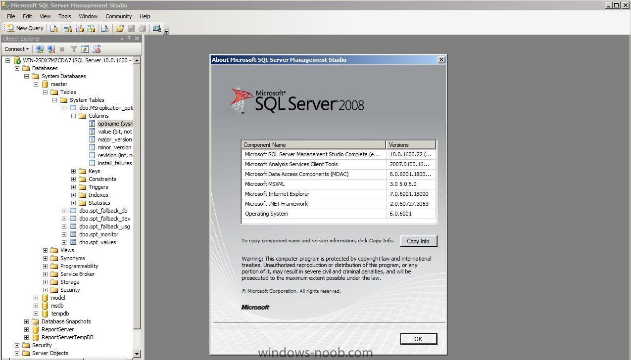

one more click and then it's all completed.

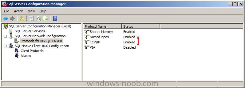

Note: This step is optional for troubleshooting Kerberos authentication issues. The named pipes protocol is not required for Configuration Manager 2007 site database operations and should only be used for troubleshooting kerberos authentication problems.

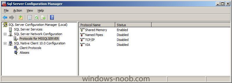

Enable Named Pipes and TCP/IP in your SQL server protocols (by default they are disabled), start up your SQL Server Configuration Manager, expand SQL Server Network Configuration in the left pane, and choose Protocols for MSSQLSERVER (or whatever your SQL server instance is called).
Right click on named pipes and set to enable, do the same for TCP/IP,

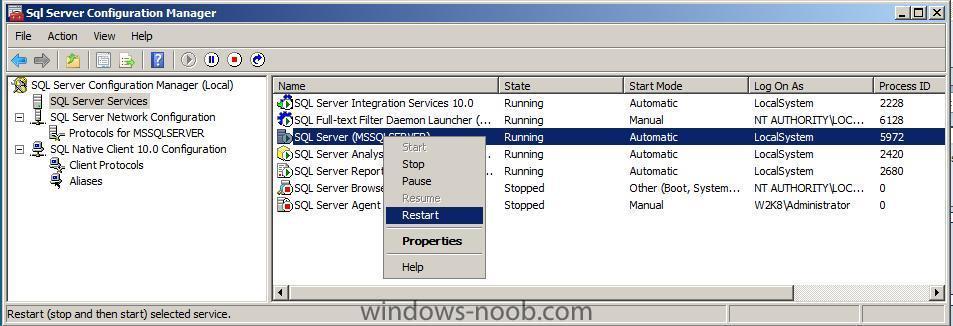

once done you must Restart the SQL server service (click on SQL Server Services in the left pane, and in the right pane right click on SQL Server (MSSQLSERVER), choose restart

restart the SQL service to make the changes work
