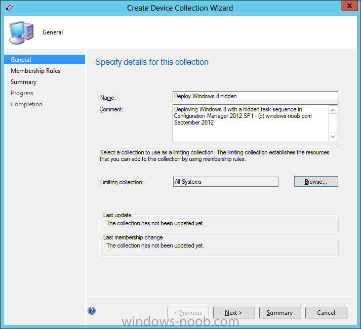

We will be deploying our hidden task sequence to a specific collection, so to make this easy to understand we'll create a new collection called Deploy Windows 8 Hidden, right-click on Device Collections and choose Create Device Collection,
give the collection a suitable name like Deploy Windows 8 hidden and limit it to All Systems
and click your way through the rest of the wizard, no need to configure any membership rules at this point as we will add computers to the collection later.

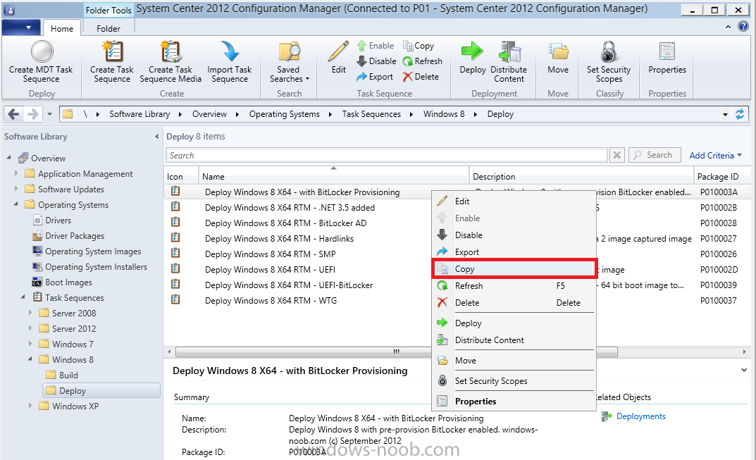

Locate a task sequence that you want to make hidden or create a new one from scratch, right click on the task sequence and choose Copy.

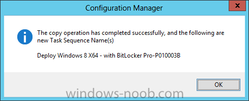

once the task sequence is copied you'll get a message informing you.

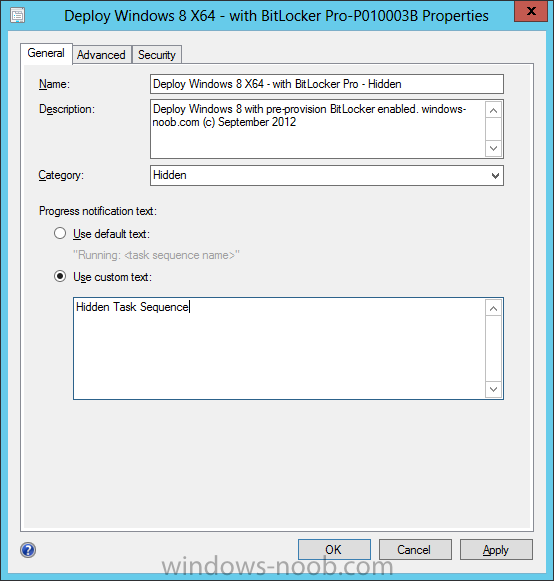

Locate the copied task sequence (the name was in the message above) and right click on it and rename it by choosing Properties, append the word Hidden. You can optionally add a category of Hidden and change the custom text to read Hidden Task Sequence as per the screenshot below.

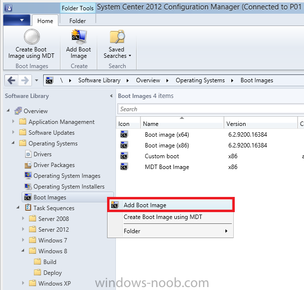

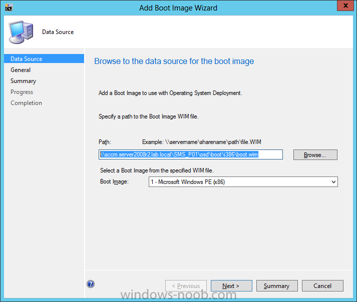

To create the custom boot image do as follows, right click on boot images and choose Add Boot Image.
browse to the UNC path of your default X86 boot image (something like \\sccm.server2008r2.lab.local\SMS_P01\osd\boot\i386\boot.wim) and select that boot wim file

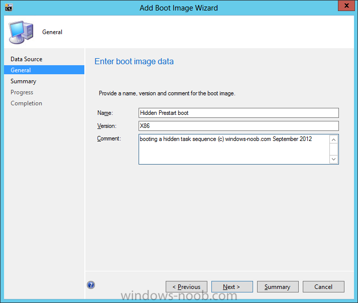

fill in some details about this custom boot image including it's version (x86)

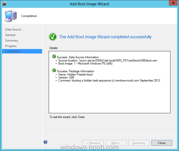

and click your way through to the end of the wizard.

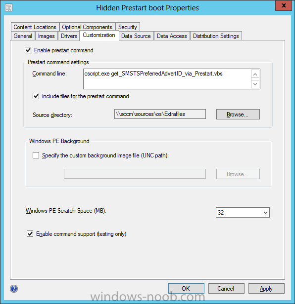

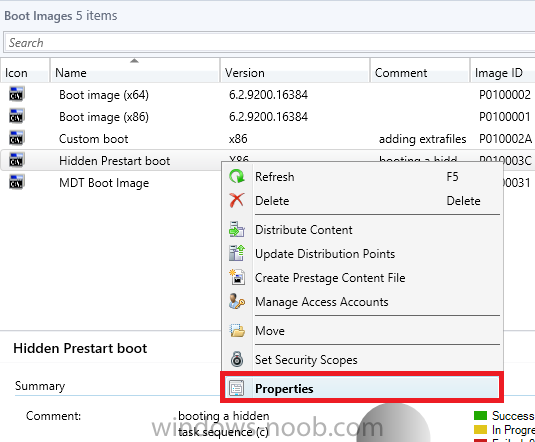

Now that we have a custom boot image, let's right click on it and add some changes.
select the Customization tab, and make sure to place a checkmark in the following options
  • Enable prestart command
  • Include files for the prestart command
  • Enable command support (testing only)
so that it is like the screenshot below
Point the prestart command to the following script file by typing
cscript.exe get_SMSTSPreferredAdvertID_via_Prestart.vbs
here's the VBS
get_SMSTSPreferredAdvertID_via_Prestart.vbs.txt
Note: remove the .TXT extension on the file above before using it.
save get_SMSTSPreferredAdvertID_via_Prestart.vbs to \\sccm\sources\os\extrafiles
next click on the Deploy tab, make sure that Deploy this boot image from the PXE enabled distribution point is selected
click ok and answer NO when prompted to update to Distribution points as we have not selected any distribution points for this boot image yet.
Continue to the end of the wizard.

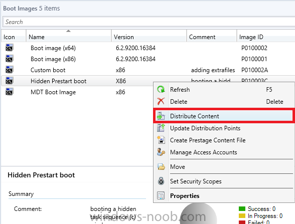

Step 4. Distribute our prestart boot image
Right click on our Prestart boot image and choose Distribute Content

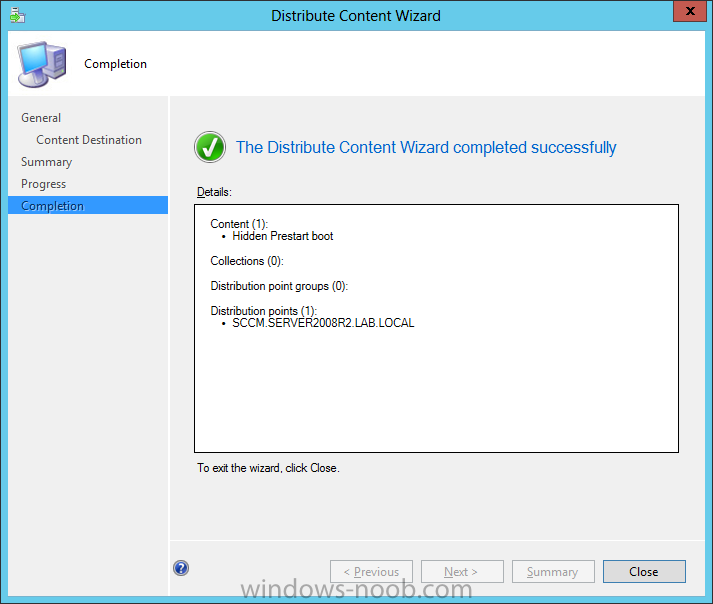

the distribute content wizard appears, add your distribution points and continue through the wizard until completion

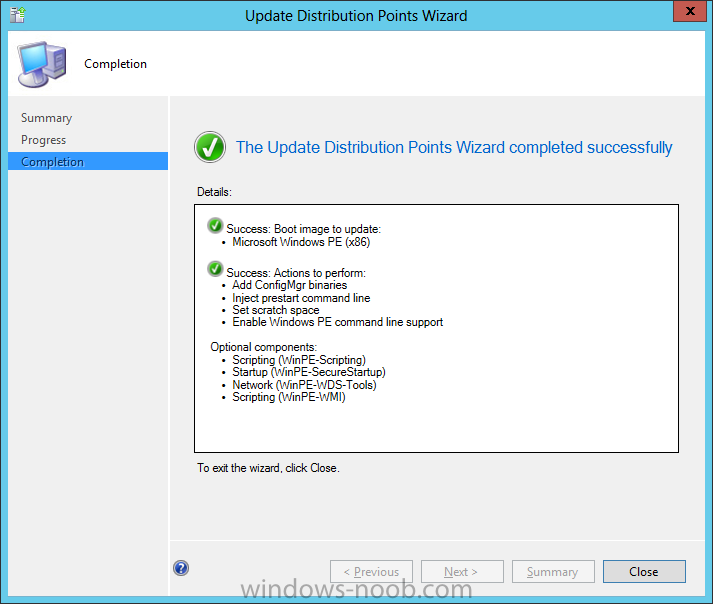

once done, right click on the Prestart Boot Image and choose Update Distribution Points, continue through that wizard.

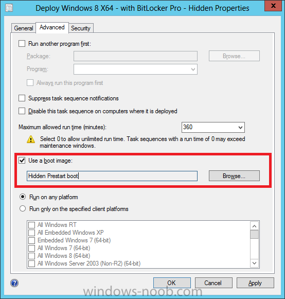

Step 5. Attach our prestart boot image to our hidden task sequence
In Task Sequences, select our hidden task sequence, right click and choose properties, select the Advanced tab and change the boot image from the X86 default boot image to our hidden prestart boot image as per the screenshot below
click apply and ok.

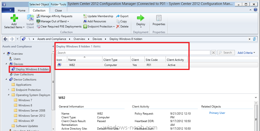

Step 6. Add a computer to the hidden collection
using direct membership (or whatever method you wish) add a computer to the hidden collection, verify the computer object exists in the collection before moving on to the next step.

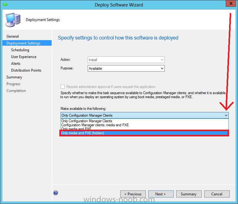

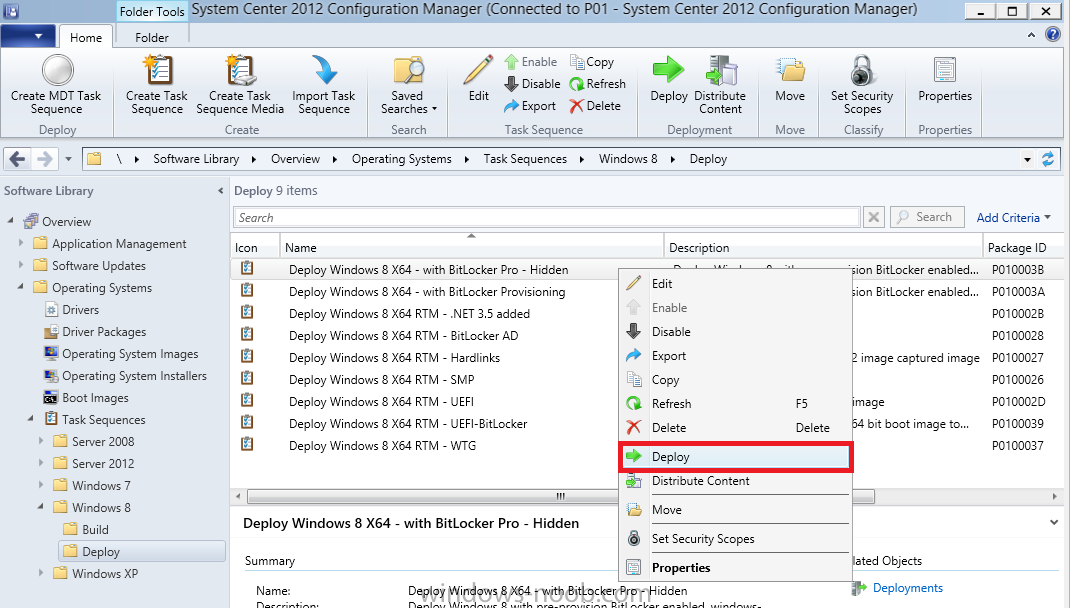

Step 7. Deploy the hidden task sequence

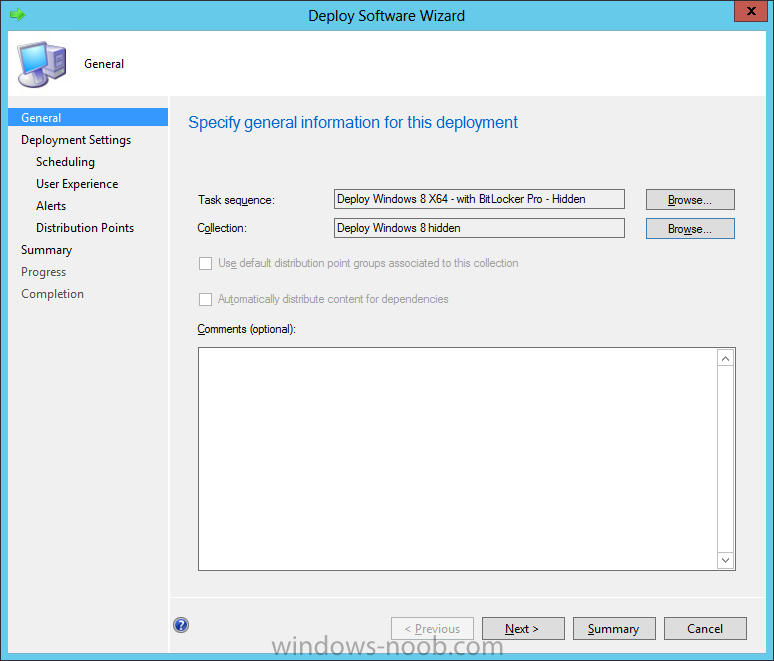

right click on our new Hidden task sequence and choose Deploy
choose our previously created Deploy Windows 8 hidden collection and click next
and on the Deployment Settings screen click the down arrow beside Make available to the following and select Only media and PXE (hidden)
click your way through the rest of this wizard.

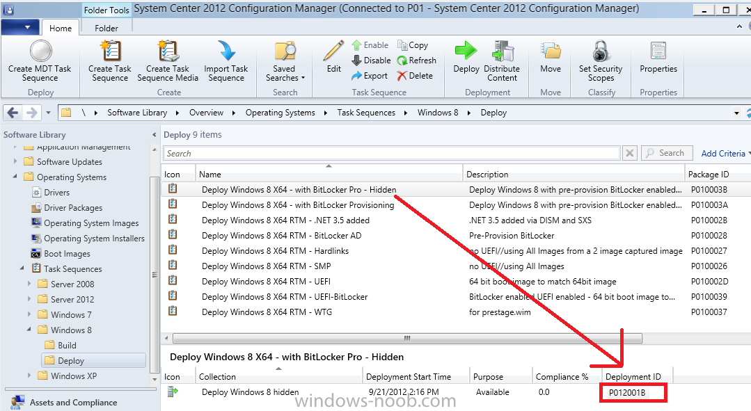

Step 8. Locate the Deployment ID of the hidden task sequence
In Task sequences, select our hidden task sequence and click on the Deployments tab below it

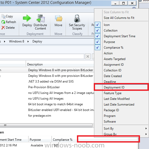

our Deployment is listed, click on the column in a blank space and right click to add new column options, select Deployment ID from the list.
and now we can see our Deployment ID, take note of what it says (write it down).

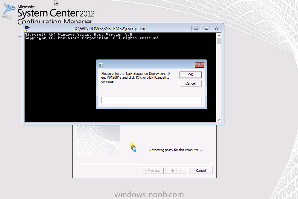

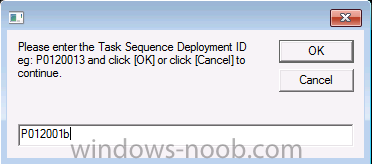

if you did everything above correctly you'll see the following immediatly after entering your PXE password (if you set one) and before the task sequences are normally displayed (assuming you have some available task sequences)
enter the Deployment ID we noted from above, that was P012001B or don't enter it and just get to see the normal list of available task sequences.

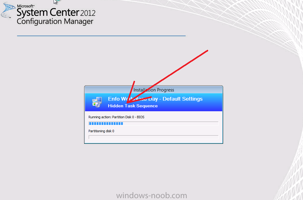

and if you entered the Deployment ID correctly you'll see your hidden task sequence kicking off, cool huh ? yup, cool.

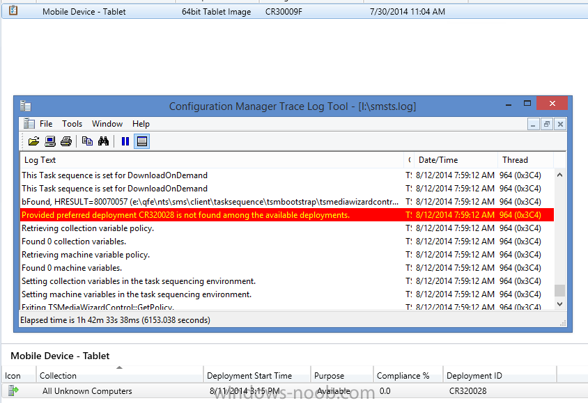

Hello,
I'm having issues with this. It worked just fine for a bit. I imaged 2 machines using it. Then out of the blue I can't get the TS to run. The prestart VB script is running. I put the deployment ID in exactly as I see it in CM, click ok and after a few seconds I am brought to the regular TS wizard. Not sure what I'm missing. Is there a log somewhere I can check to see why it not running the hidden TS?
Ok so I found the entry in the smsts log from the tablet i'm trying to image, but I'm still not exactly sure why it thinks it can't find it. As you can see in the image my ID matches. Just a standard deployment set to pxe and media only (hidden).
Thanks,
