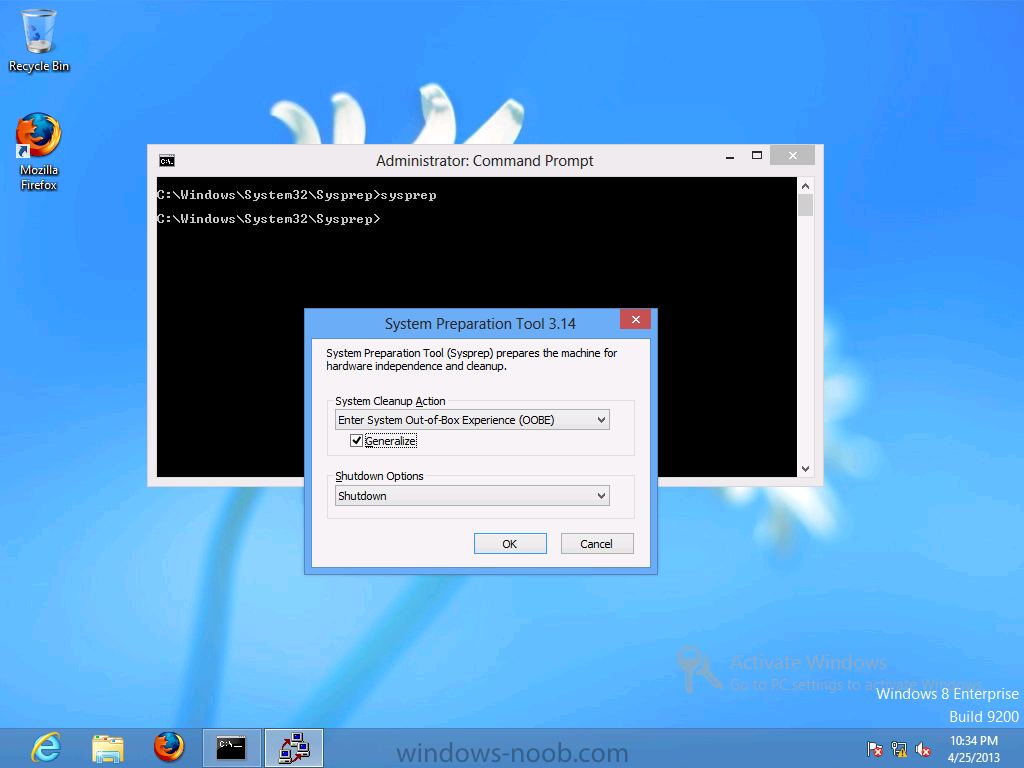

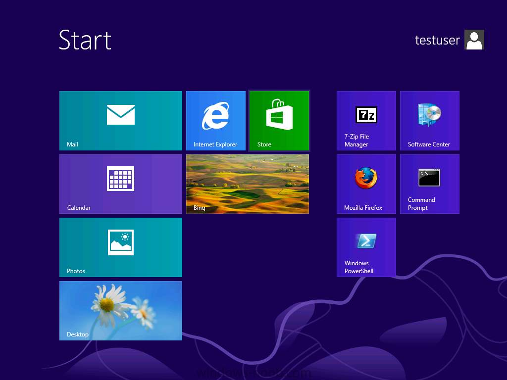

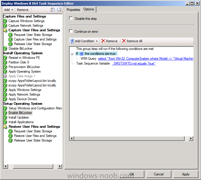

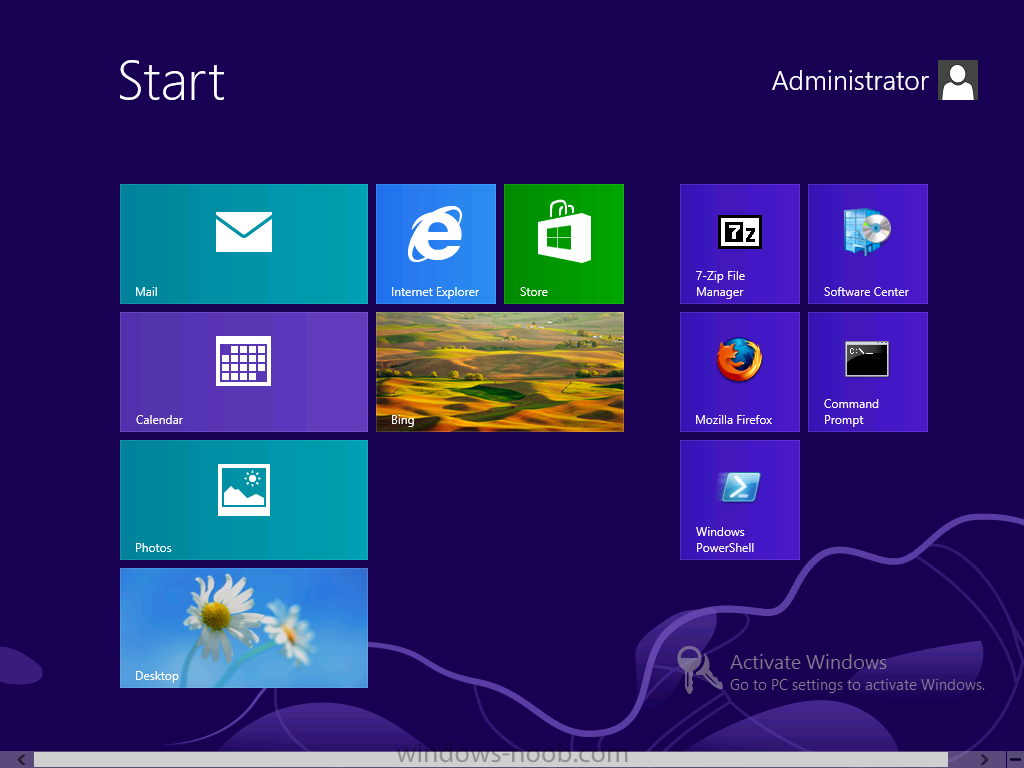

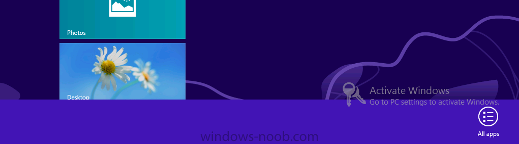

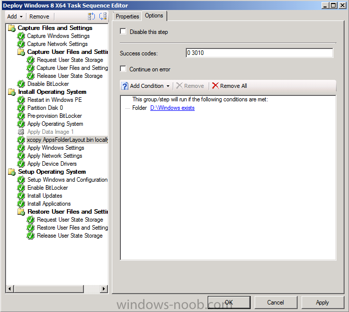

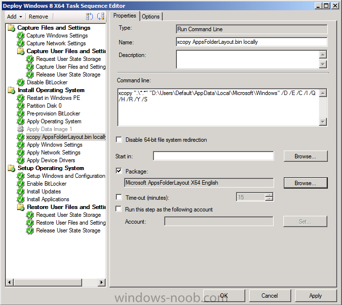

Yanze 0 Posted September 19, 2014 Report post Posted September 19, 2014 Thanks for this! I followed your guide and AppsFolderLayout.bin is indeed copied to the default user profile on the .wim that is being deployed later on. But the Start Screen stays default, no extra tiles. At the end of my 'install task sequence' I do a sysprep&shutdown so users can choose their own username, etc. Can this be the issue? Quote Share this post Link to post Share on other sites
anyweb 480 Posted September 19, 2014 Report post Posted September 19, 2014 "At the end of my 'install task sequence' I do a sysprep&shutdown so users can choose their own username, etc." huh, i don't get what you mean by this, are you sysprepping your Deploy task sequence ? the only sysprep that should happen is in the capture image, not the other way around Quote Share this post Link to post Share on other sites
Zlodey 0 Posted April 15, 2015 Report post Posted April 15, 2015 i've done sysprep and got AppsFolderLayout.bin. In test purposes i've copied AppsFolderLayout.bin to c:\windows\users\default\local\microsoft. I've created new user, logon and nothing happend, it got default start screen Quote Share this post Link to post Share on other sites
anyweb 480 Posted April 16, 2015 Report post Posted April 16, 2015 read the guide again, you got the location wrong it should be... xcopy ".\*.*" "C:\Users\Default\AppData\Local\Microsoft\Windows" /D /E /C /I /Q /H /R /Y /S Quote Share this post Link to post Share on other sites
Zlodey 0 Posted April 19, 2015 Report post Posted April 19, 2015 Thank, I see. This works perfectly as you wright in the guide. My idea was that if you copy appfolderlayout.bin to default's user profile on installed OS that;s won't work. It works only if you are make clean OS installation Quote Share this post Link to post Share on other sites
