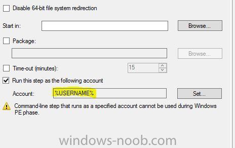

create a variable in SCCM TS for logged in user
commissar117 replied to commissar117's topic in Configuration Manager 2012
No, I am not using HTAs. I was thinking maybe through the MDT Setting ini file. -
After OS installed -

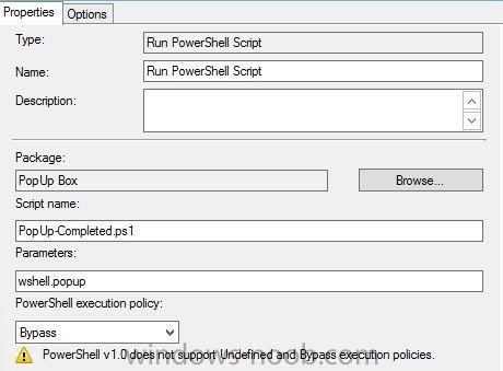

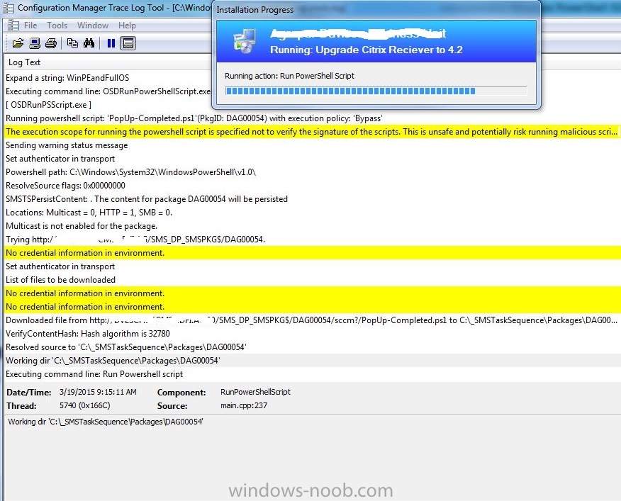

I am trying to run a powershell script during a task sequence, which is supposed to give me a popup window on client desktops. If i run the powershell script outside the TS it works fine and inside a TS it hangs and never ends and the popup never shows up. I attached an image that illustrates. Any ideas ? am I missing something?? Thanks,
