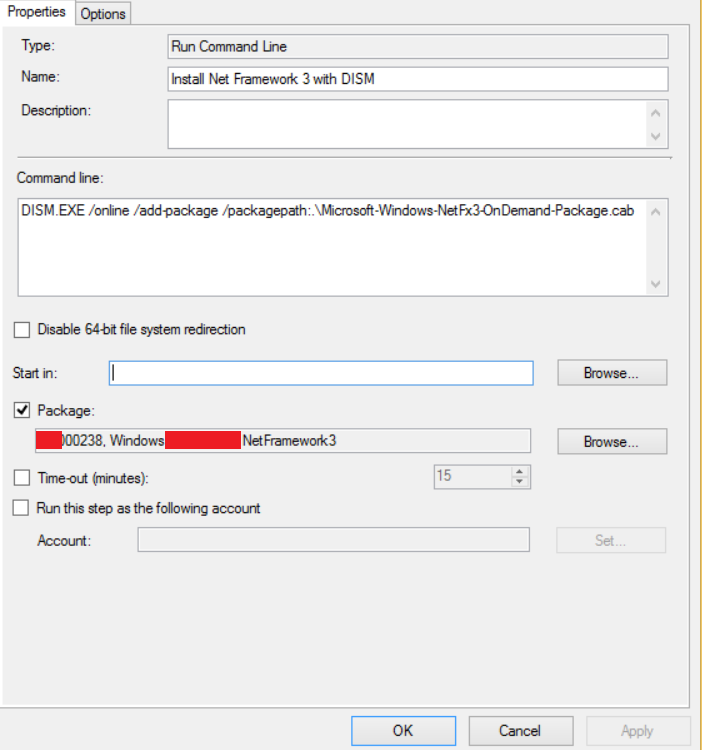

  8. Create a Package with the cab file Create a run Command Line Step Select the created Package Set as Command line: DISM.EXE /online /add-package /packagepath:.\relative\Path\to\dotNetFile.cab Example: (In this case the cab file is at the root directory of the package)
