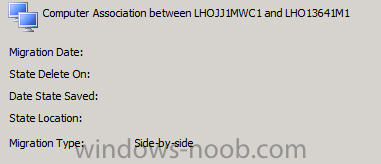

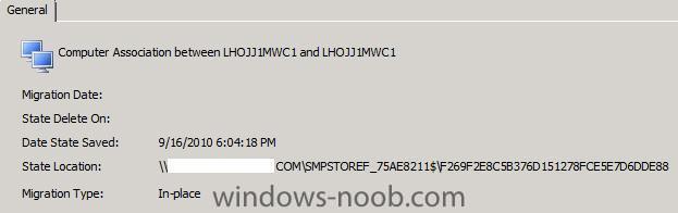

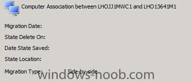

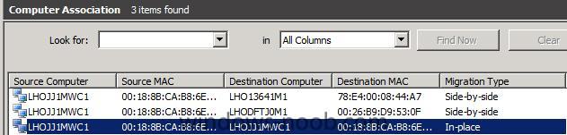

Well, I think I may have determined what my issue is. I'm still testing, but I think I've made some progress. Here is an example of how domestic is configured. C01 <- This is the central site or top level | P01 <- This is the US Primary Site Server | | | S01 S02 S03 <- These are Secondary Sites at various US locations So, I was logged into C01 when creating the Computer Associations. While in the console, it was listed as side-by-side like what is shown in the screen shots. However, when completing the capture, it created a new entry labeled as In-Place. After tons or research I came across a little note on Microsoft's documentation that A Site-By-Site is not possible over Parent/Child sites. This got me thinking. First of call, C01 does not have ANY agents assigned to it nor a distribution point. So, The only other Server with a Console installed is P01. I logged into P01 and created the Side-by-Side computer association for two machines that reside in S01. I did a capture state and sure enough the record was updated and the backup location was listed! Oddly, when I check the computer associations area on C01, it creates two entries that are identical and are labeled as In-Place....no idea what is going on there. For my next test, I created a Side-by-Side migration of a machine that is in P01 and another in S01. This one did not restore successfully since it could not locate the data. The capture for S01 went to S01's SMP where as the restore for the machine in P01 was looking for it in P01's SMP....which it obviously wasn't at. Just for testing, I copied the backed up folder from S01's SMP to P01's SMP and it was able to locate it and pull it down. However, this also demonstrates that you can only use Side-by-Side migration for machines that talk to the same management point. P01->P01 Good S01->S01 Good S01->P01 Bad P01->S01 Bad Obviously, if we did the scanstate and loadstate manually via command line and not using the SMP's there wouldn't be an issue. Or, if all sites used the SAME location for its SMP I could see that potentially working. Sorry for the long post, but I hope this may help others in the future.

Another update. I decide to try a Win 7 -> Win 7 computer association and USMT to SMP migration. Same results. It connects to the SMP and uploads the data, but it shows up as an In-Place and doesn't do anything to the computer association I created before hand. Steps I did: 1. Created "Win 7 to Win 7 migration" to SMP Task Sequence using USMT 4.0 in SCCM 2. Create a computer association between Win 7 machine A and Win 7 machine B (Both belong to the same Site). 3. Add the source computer to a new collection folder called "Win 7 to Win 7 SMP Migrations" 4. Advertise the "Win 7 to Win 7 migration" TS to the "Win 7 to Win 7 SMP Migrations" Collection 5. While running Windows 7, I told Config Manager to check for new programs and about 2 seconds later it popped up with the "Win 7 to Win 7 migration" TS. 6. I ran the TS and it created a folder on the SMP (This runs solely in Win 7. It never boots into PE or anything like that) 7. Job finished and released the store successfully. 8. Machine pops into the Computer Associations tab as an In-Place disregarding the association I created in step #2. I just don't know what I am doing wrong here.

Also, while you are looking at those, here is a file from running the same TS on my source PC from XP. Here are the computer associations for the machine. The bottom one was generated after the backup TS finished. Here it shows the store information for the laptop, but it is an In-Place The association shows absolutely nothing Here is the smsts.log file from the upload TS smsts.log Thanks again for your assistance. MY head aches from banging against the wall.
Sure thing. Here is what I have. The smsts_scan.log is from running my Task Sequence from WinPE. AS you can see, it will not talk to the SMP for the site since it is in WinPE. smsts_scan.log The second attachment, smsts-20100916-140850.log is when I am trying to do a restore to a Win 7 system. I have a computer association setup in SCCM, but there is not a storage location defined on it. smsts-20100916-140850.log AS originally stated, when I did my USMT backup in Windows with the same TS that fails in WinPE it creates a backup on the SMP, but shows up as an In-Place object under computer associations. Thank you for your help on this.
I am having a similar issue. I am trying to do a side by side migration, but my USMT backup to the SMP results in creating an In-Place migration object in Computer Associations. I have an association for the source machine to the destination machine, but so far no luck. I have two Task Sequences and am running both of them from within Windows (Capture done in XP and Restore done in Win 7) I do not understand that part about having to PXE boot to do a side-by-side migration. Every time I try to run my Task Sequence it errors out and the logs state that I cannot do the Request State Store or the Capture User State from within PE. Do you have an example Task Sequence that shows how this is done (The side-by-side...I can do an inplace xp-7 on the same machine SMP or hardlinked). I'd much appreciate it.
